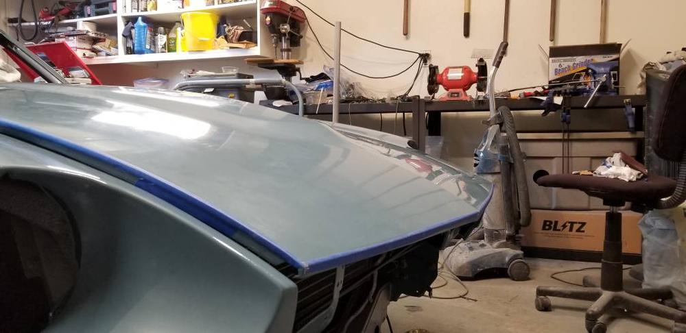

So I put the hood back on today and the front looks like this.
Seems like the torsion bars are pushing up too much. I can lean on the hood to bring it down, but I'm probably putting 100lbs on it to do so.
FWIW, the bars had been removed from the car before I got it. (I didn't even realize they were missing and just sitting in front of the radiator until I took everything apart for paint.) I'm guessing that's the reason why, but I'd much rather have them on there then not. Any suggestions?20181225_161725.jpeg

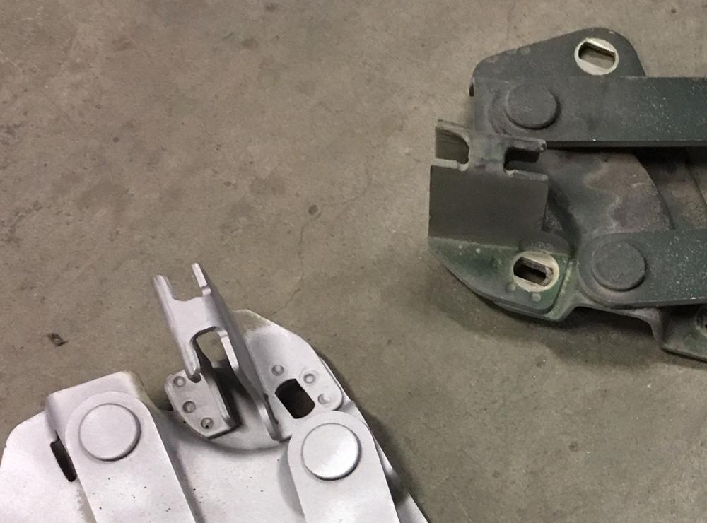

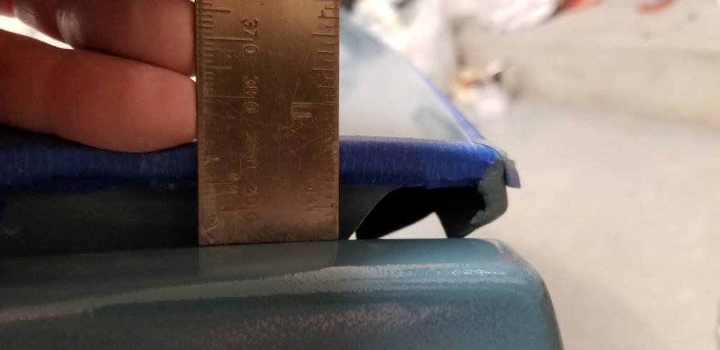

Hmm...I tried loosening the hinges to see if that would help, and I only get a bit of adjustment. The hood sits about 3/4" high, which is way more than the slots allow.
With the hood closed, the hinges do not sit all the way down (they move if I push down on the front of the hood). Should they?1545787944193.jpeg

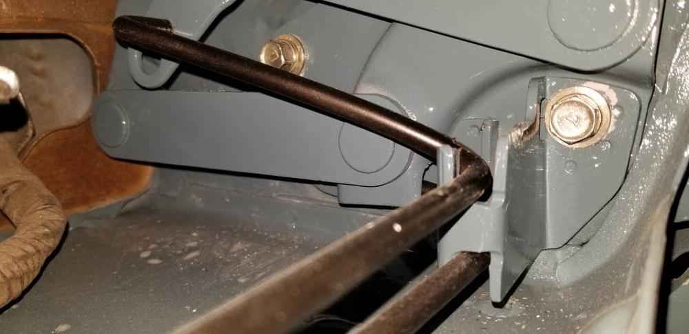

Do you have the torsion bars in the right slots?
Oh god. I put them in the only way they're able to go...but is it possible to have them flipped around? Please tell me no, because getting those suckers in was high on my list of things I don't want to do again.
They should be in the lower slots.
Closest to the chassis.
Fenders are bolted in and everything there is sitting nicely, so that's probably not it.
I'm starting to think the PO wasn't too lazy to put the torsion bars back in, that was just his "fix" to the problem.
Anything on the hinges I might look at?

Hinges are unadjustable themselves.
I thought so too.
At this point, I'm not assuming anything, so this is right, right?20181225_184250.jpeg
