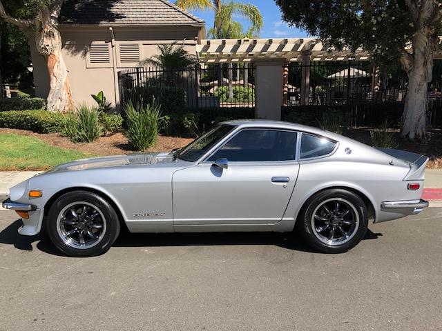

And a pic, just to keep you guys interested.
Thanks in advance!
