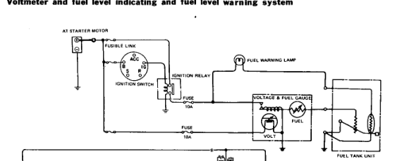

Does it show in the FSM?  You made me go out to the garage to confirm that my 76 has no light there.  Maybe Nissan was foreshadowing.
76 FSM -
Thy do show the Fuel Warning lamp -
