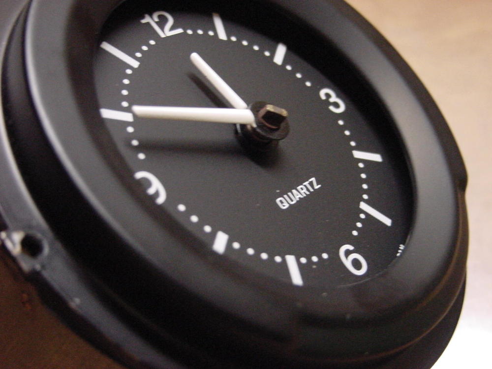

I have a set of new gauge faces for my  1978 280Z, and I started with the clock, since it seems to be the simplest gauge.
But, the arms don't want to come off easily, like the pointer for the speed meter will.

They press on - so the key is just care and patience.   The metal is thin and easily bent.

....and lots of it. I was nervous when I did a set but after removing a couple I got comfortable with it.
Those little sucker seem to be tight on there, not like they are on a cheap battery-powered wall clock:
Edited by TomoHawk
IIRC the clock was the most difficult. Go slow!
But I can't remember how I did it. Sorry I couldn't be of more help
Edited by rcb280z
I probably just, between my thumb and forefinger, "wiggled" it back and forth slightly til it broke lose. I think that's how I did it, thinking about it some more.
That's what I did.  It seemed to be 'rusted on" a bit, so I turned the arms slightly to break them free, and they came off.  I just wish those little screws holding the rubberized bracket to the case would come off, so I could pull the clockworks out to paint the inside.
I'll paint it anyway- very slowly!
A good trick is to use a spoon or fork (whatever fits better) as a lever. Usually it pops right off (at least it was like this with my clock). ?

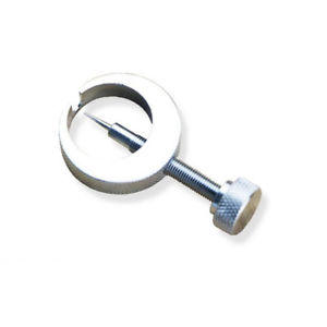

You will need a gauge needle puller.
