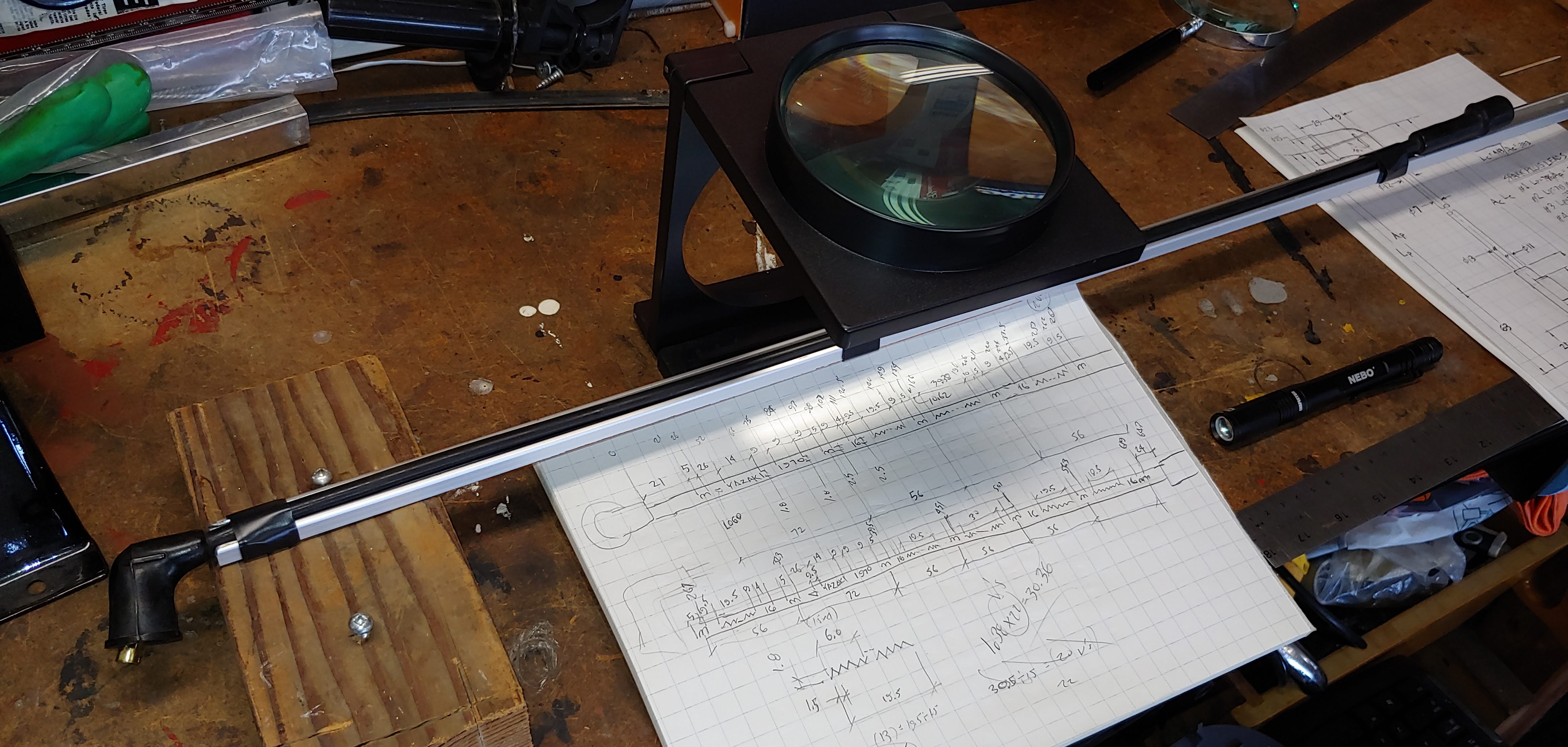

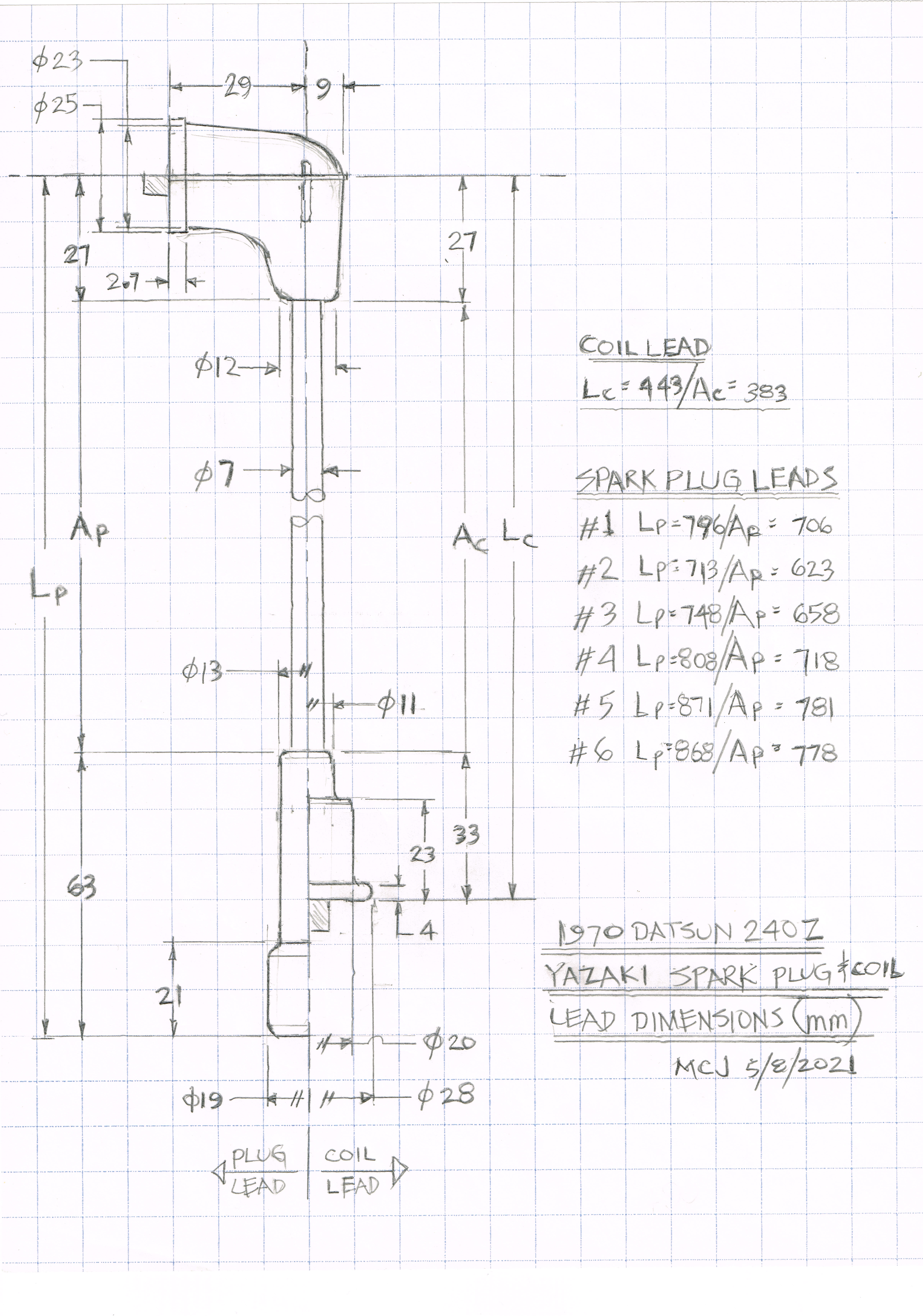

I just revised the sketch of the leads in my previous post (#80) with more accurate lengths, the method I used with a fabric tape was not the way to go. I got much better, and repeatable numbers, holding the leads in a channel to carefully keep them straight. Anyone recognize the re-purposed holding device.
I used this method so that I could get accurate measurements of the markings. This will all be in a new topic after I have time to finish with the measuring and cad work. Here is a preview of the number 3 lead. I will also be creating a 2D drawing with dimensions of the markings.

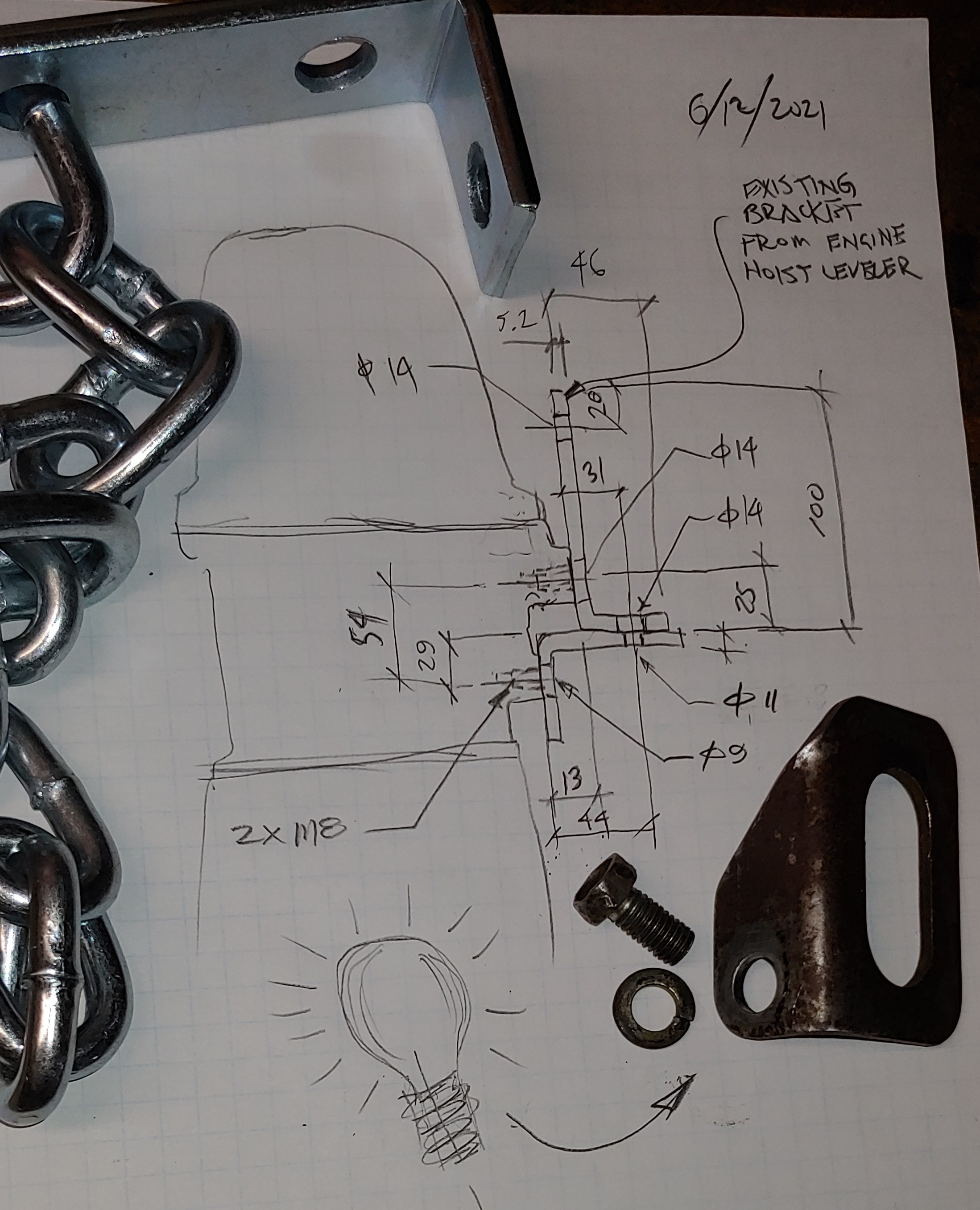

Getting close to pulling the engine, so I picked up a two ton shop crane and engine leveler that was on sale. The leveler has "L" brackets on the end of the chains so I started to see what was required to attach these to the engine. @Racer Xposted pictures of the OEM lifting brackets so that was my starting point. Here is what the OEM's look like:

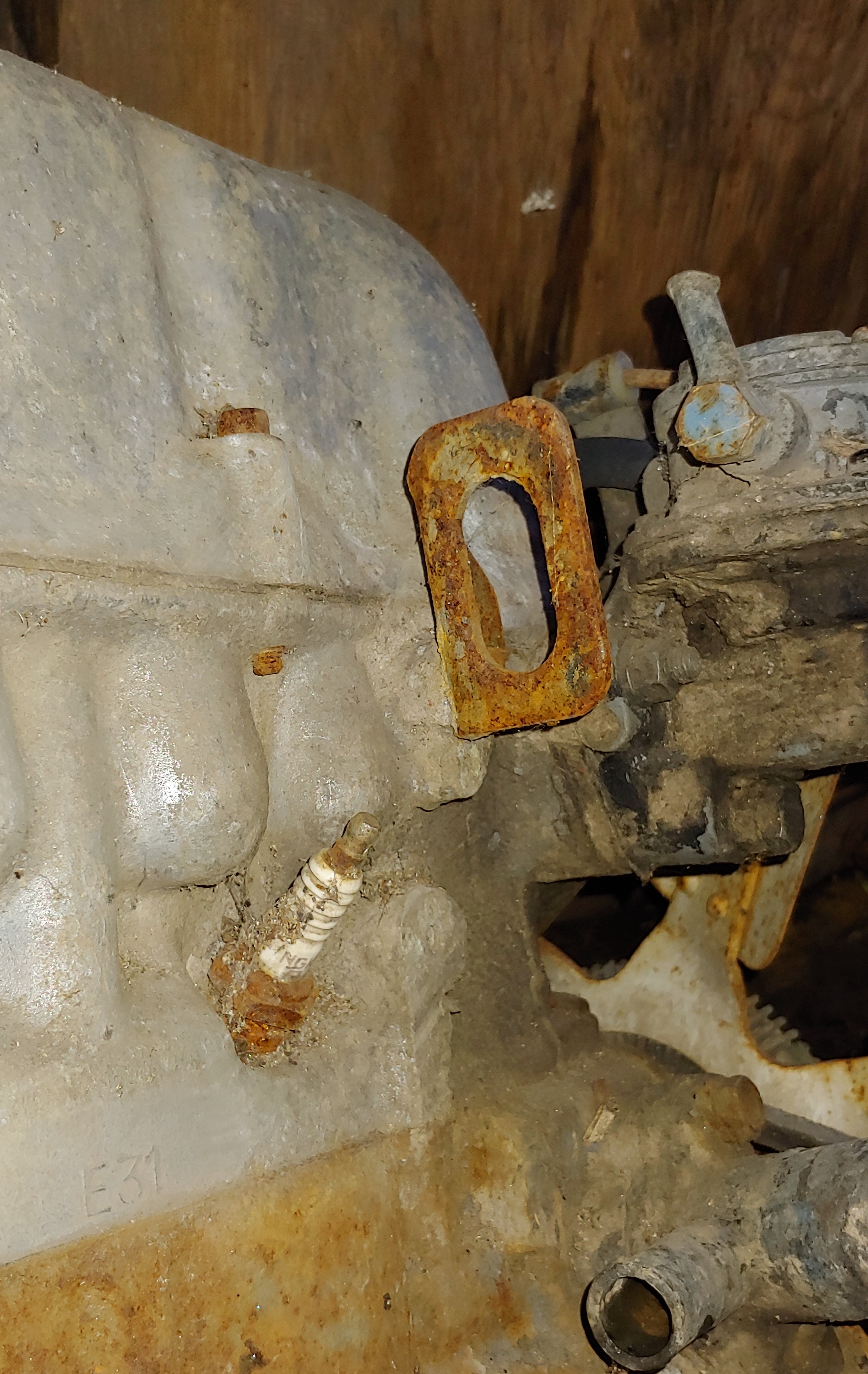

After reviewing this I thought it made sense, on the front mount, to attach the leveler "L" bracket at the OEM location, and to use both of the two M8 holes that the OEM bracket used. So I took some measurements and made a sketch to fab a small angle to pickup the second bolt. Right after I finished the sketch I had a light bulb moment, thinking "Hey, I have an old spare engine in my shed". It's from a December 1970 parts car I picked and stripped over 30 years ago. To my amazement, it still had an original early single bolt front lifting bracket. It had no rear bracket, but it won't be to difficult to use one of the "L" brackets back there.
Here is that sketch I made for those who might be interested, with the OEM bracket after I cleaned it up a bit.
Here's Jeff g helping me with mine. It jumps around but maybe read over some of the post and you may get that light bulb in your head. Good luck with it!
Thanks Site, great reference and will help.
Cheers, Mike
I've seen those on a bunch or motor pics left on. Just like the rear hooks on 240s back bumper for shipping I removed mine. Stiil have them! But they're useless on our cars after the fact. Those levlers have some tricks to make them work smoother and bot so damn jumpy. If you can't find it in that thread let me know and I can share my experiences that makes it a little easier. @Jeff G 78hopefully will jump in too.
