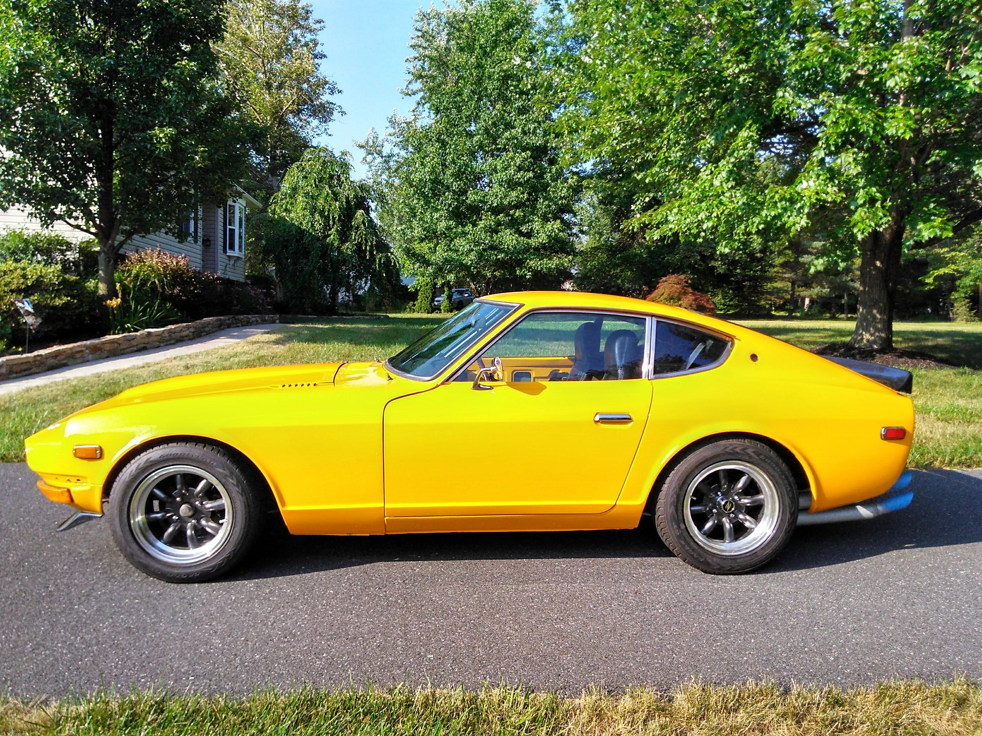

@jalexquijano Note the louvered access flaps alongside the hood. Those will help dissipate engine bay heat when the car is sitting. One could accomplish the same thing with a vented late 280 hood. As I recall, RossiZ's late 280 has both.
