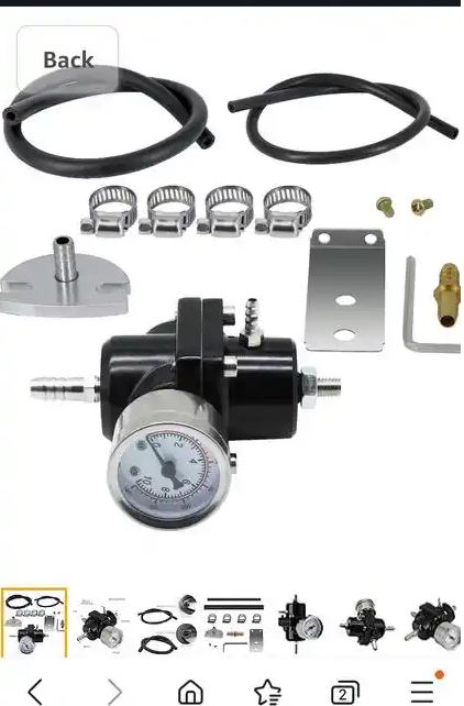

23 hours ago, MM569457 said:
I assume this would work.
That's an odd one.  Looks like it has a vacuum reference port, which a carburetor would not need.  But a 10 psi gauge which is way lower than any EFI system.  Post the link, can't even tell what brand it is.  Looks like eBay.
https://www.amazon.com/Universal-Adjustable-Regulator-Injection-Accessories/dp/B08S757C76/ref=asc_df_B08S757C76/?tag=hyprod-20&linkCode=df0&hvadid=507600687300&hvpos=&hvnetw=g&hvrand=15473091677829872037&hvpone=&hvptwo=&hvqmt=&hvdev=m&hvdvcmdl=&hvlocint=&hvlocphy=200524&hvtargid=pla-1212457430535&psc=1
I wouldn't use it.  A decent gauge, those hose clamps, and pieces of hose would cost over $25.
It's universal because they can change the ad copy to fit any application.  140 psi.  "adjusts oil flow"?  "ideal weight"?   Not good...

These look decent.  Holley has been collecting brands and rebuilding their reputation so quality is probably fair.  A selection of psi ranges.  You would want the second one, I think.
