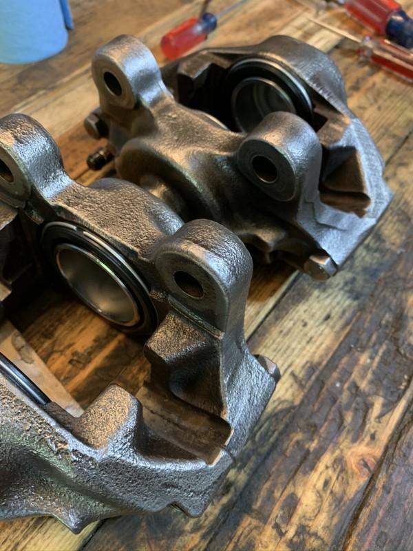

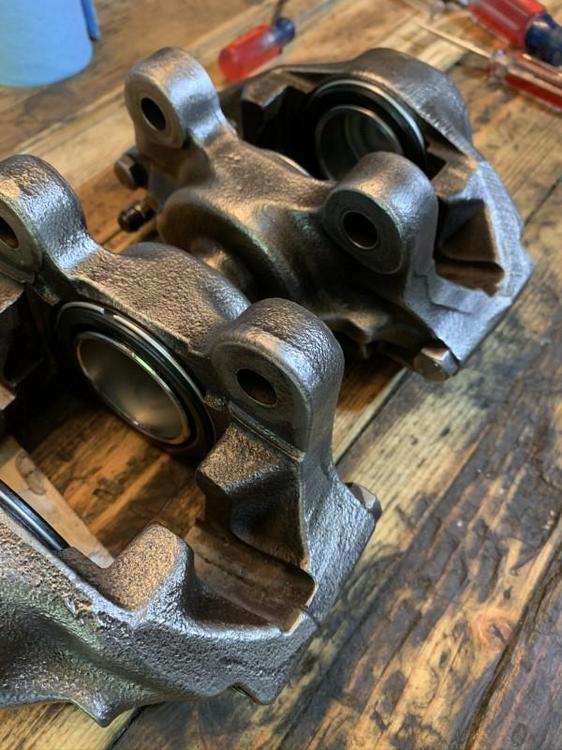

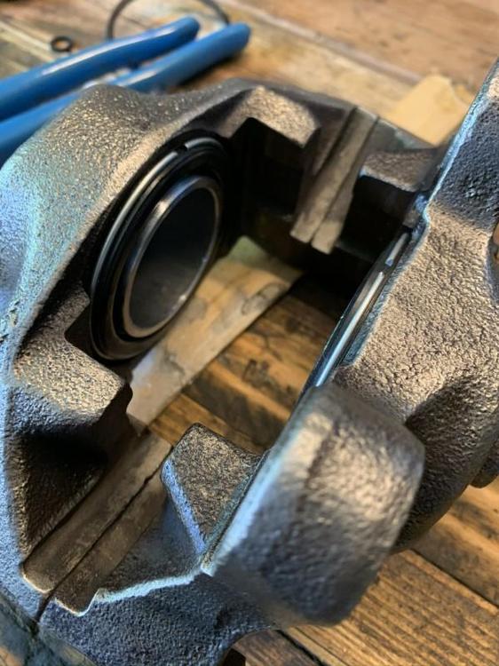

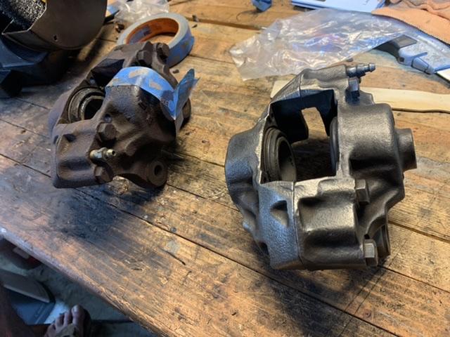

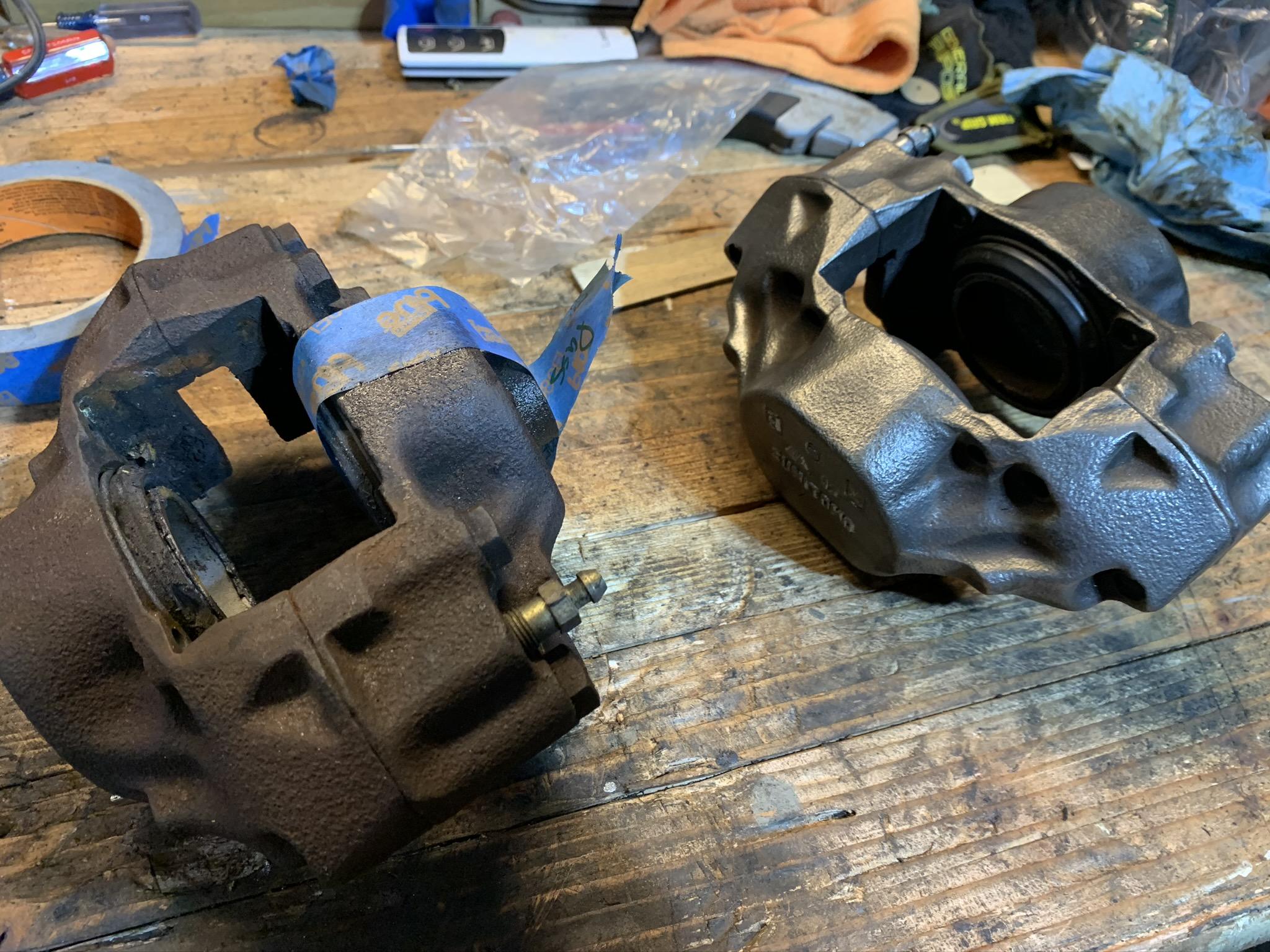

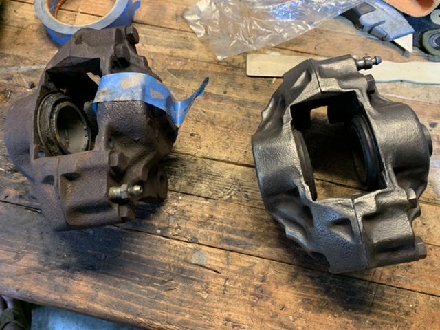

April 27, 20205 yr Author comment_598168 Making progress! Got the hubs off and started rebuilding the calipers. Link to comment https://www.classiczcars.com/forums/topic/60184-rust-advice-78-280z/?&page=18#findComment-598168 Share on other sites More sharing options...

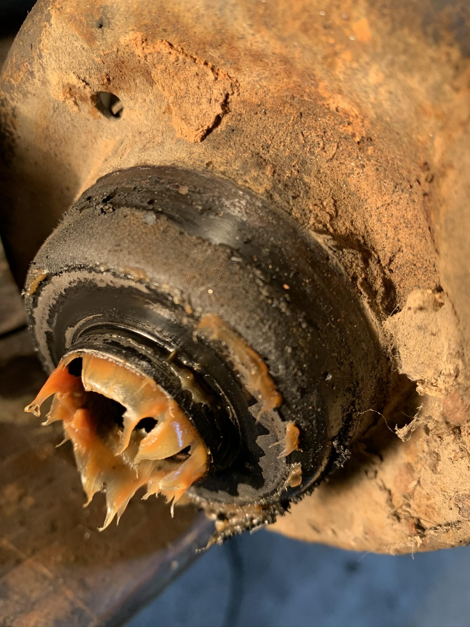

April 28, 20205 yr Author comment_598169 One question, the brake piston was freezed and I needed to use a grease gun to push them out. Now that they are out how do I clean the grease inside the caliper Link to comment https://www.classiczcars.com/forums/topic/60184-rust-advice-78-280z/?&page=18#findComment-598169 Share on other sites More sharing options...
April 28, 20205 yr comment_598174 With your finger? and solvent when you can't get anymore out with a cloth. Link to comment https://www.classiczcars.com/forums/topic/60184-rust-advice-78-280z/?&page=18#findComment-598174 Share on other sites More sharing options...
April 28, 20205 yr Author comment_598233 got it, the solvent should clear the inner passage ways right? The projects that should be easy are always the worst. I received some goodies yesterday - KYB shocks, Eibach springs and new rotors Link to comment https://www.classiczcars.com/forums/topic/60184-rust-advice-78-280z/?&page=18#findComment-598233 Share on other sites More sharing options...
April 28, 20205 yr comment_598263 You might want to clear those inner passages with compressed if you can or at least be able to see solvent passing freely from one to the other. Link to comment https://www.classiczcars.com/forums/topic/60184-rust-advice-78-280z/?&page=18#findComment-598263 Share on other sites More sharing options...

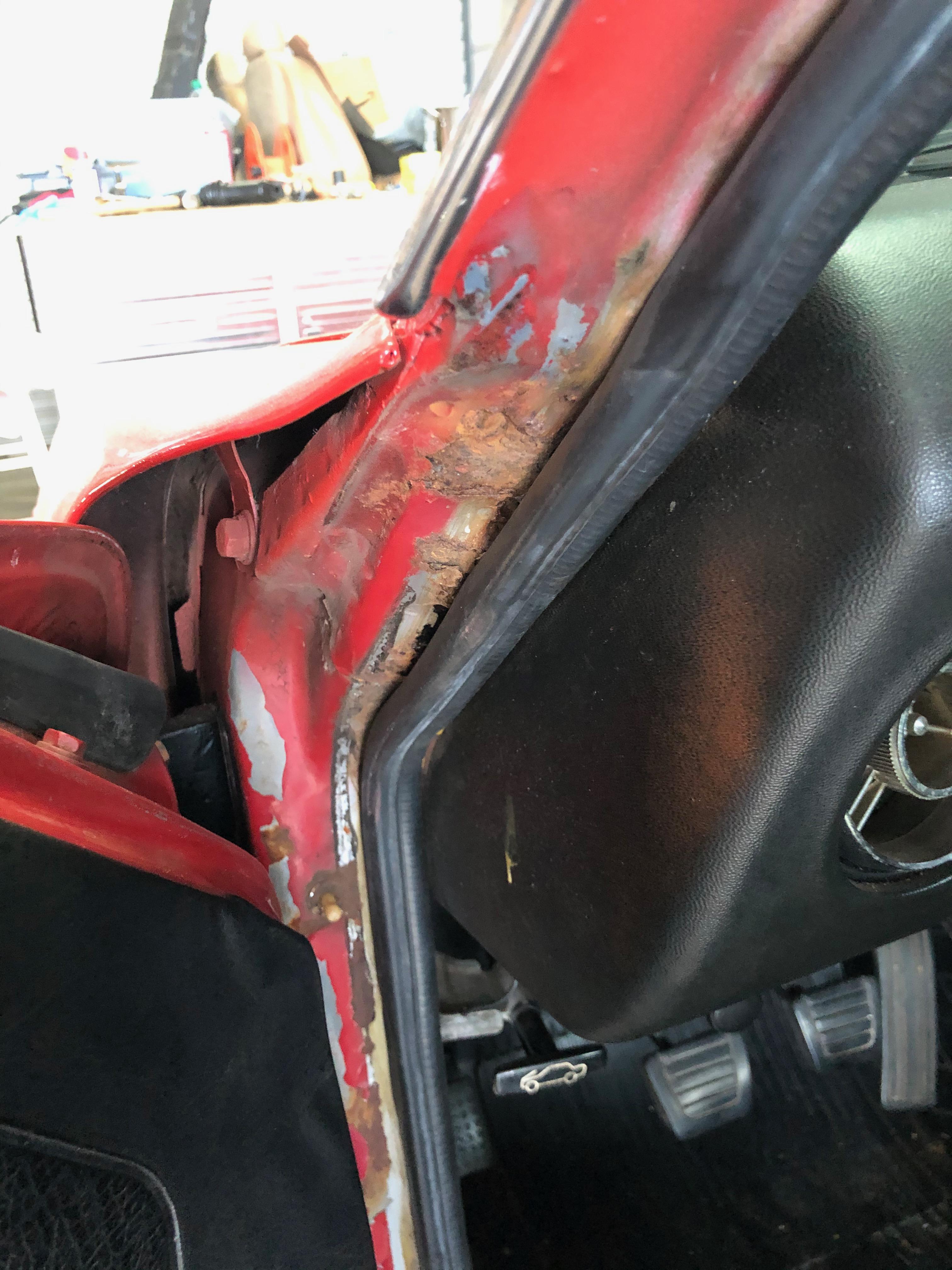

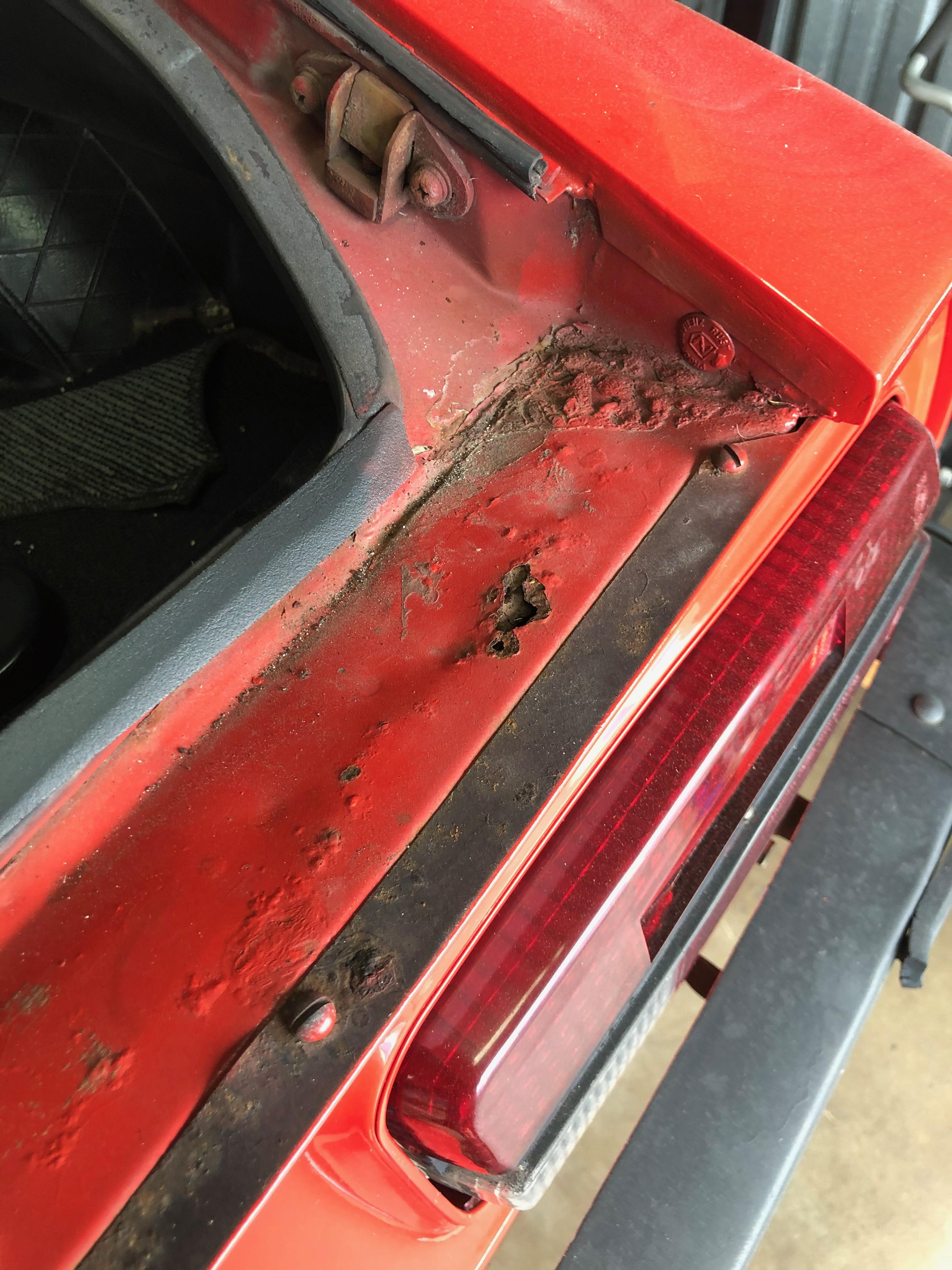

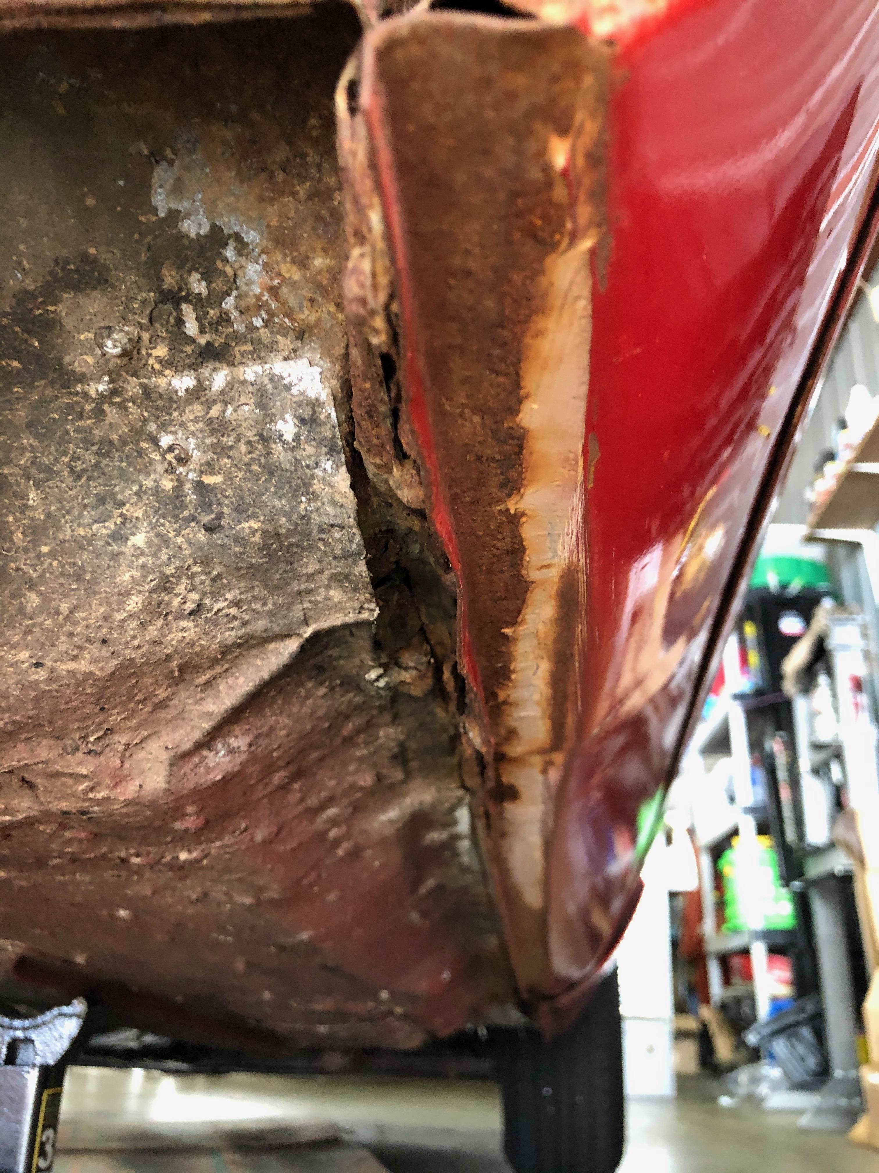

April 28, 20205 yr comment_598270 I was in a similar situation, but not quite as bad. That said, I have not found someone willing to do the work (Daytona Beach, FL). That said, I kept looking for a car with no rust. I was lucky and found one in Miami. The rest of the car is not that great, but no rust was my only criteria. Now I'll take all of the good stuff off of the rusty car and put it in the solid car. The pics below aren't as bad as yours, but still needs attention. If there is anyone in Orlando/Daytona Beach area that can fix this please let me know. Link to comment https://www.classiczcars.com/forums/topic/60184-rust-advice-78-280z/?&page=18#findComment-598270 Share on other sites More sharing options...

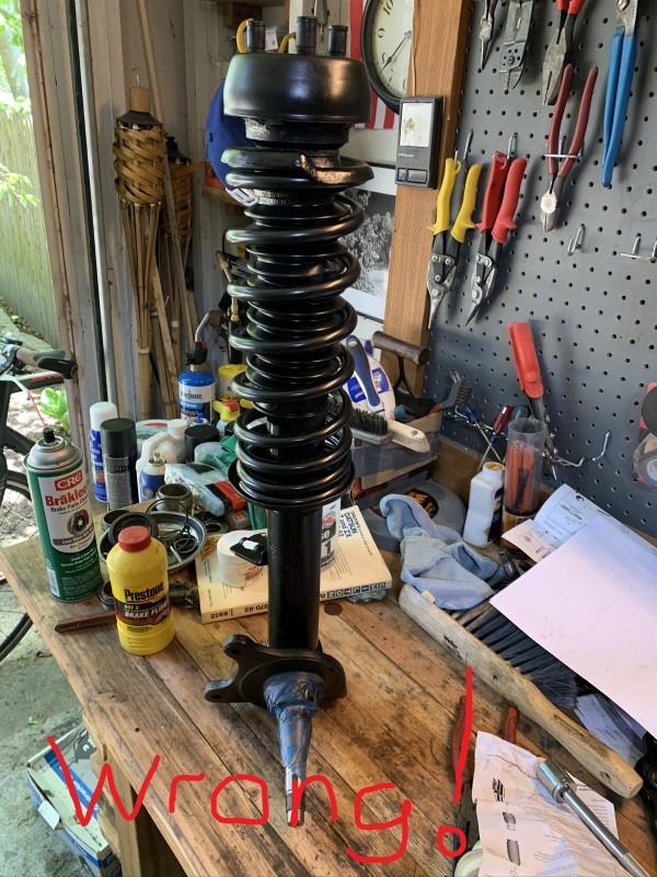

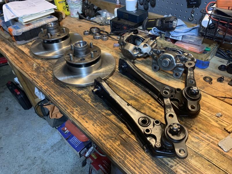

May 18, 20204 yr Author comment_599640 Steady progress is being made. The grease popped the stuck caliper pistons nicely. However, it then clogged up the inner passage ways. After a lot of trial and error (air and various cleaners did nothing) I was able to put both pistons half way in and grip them so they wouldn't move then I used compressed air. Few times like this and they finally unplugged. Tested with carb cleaner multiple times and saw it come out the other side. Looks like it is all good now. Next I disassembled the hubs and removed the bearings and races. Lastly shocks and struts have been replaced and I bought new ball joints. Front suspension is getting close. I was so proud of myself when I finished the first shock and strut and then I realized I put on the rear springs. Posting the picture of what it should NOT look like. I know nothing here is too earth shattering but I can't believe I have gotten this far. '' Link to comment https://www.classiczcars.com/forums/topic/60184-rust-advice-78-280z/?&page=18#findComment-599640 Share on other sites More sharing options...
