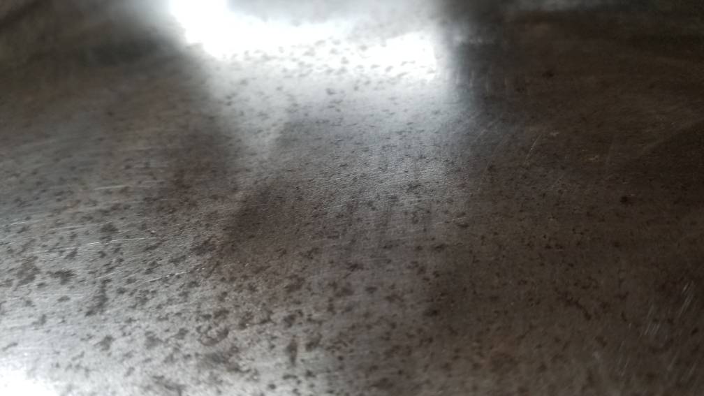

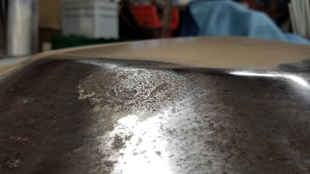

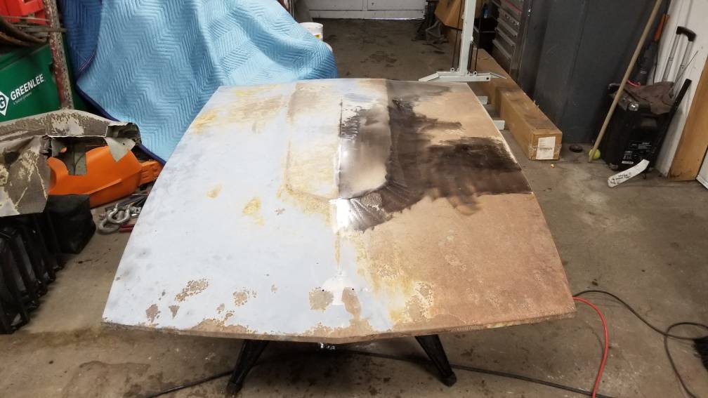

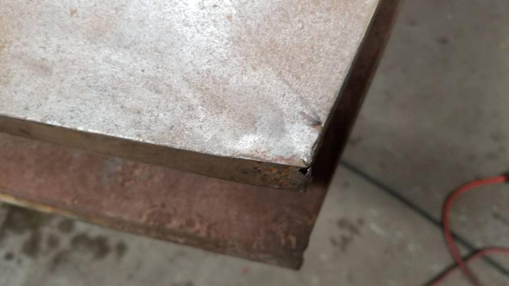

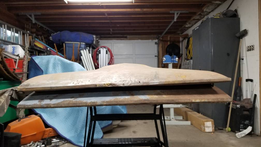

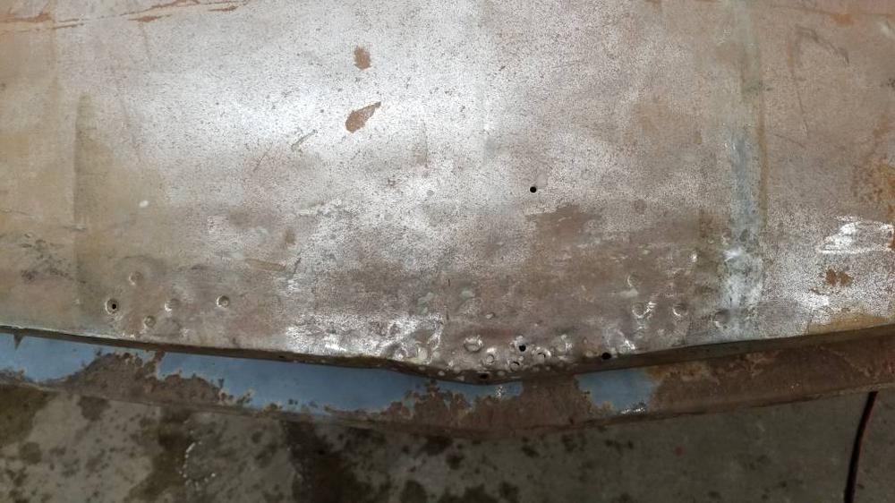

December 11, 20186 yr Author comment_563566 Which one is more of a screw around to deal with. First hood has surface rust as pictured and I hammered a dent out of the front it's straighter than the other but, surface rust pitting, can I just metal prep and epoxy then forget about it?  Second hood, substantial front nose and corner damage but zero rust on the surface no pitting seems to have some twist. At some point someone got excited with a puller....  Sent from my SM-N950W using Tapatalk     Link to comment https://www.classiczcars.com/forums/topic/59909-where-to-go-with-this-rusthole/?&page=12#findComment-563566 Share on other sites More sharing options...

December 11, 20186 yr comment_563575 Of those two hoods I guess I would go with rust pitted hood, a twisted hood is no fun to straighten. Those pits are deep so you really can't get too aggressive with a wire wheel, grinder or sander, there's a real possibility of popping through to the other side. Soda blasting would get the rust out of the deepest pits or you could make a dam around the worst area with plasticine, playdough or modeling clay and fill it with Evaporust. Link to comment https://www.classiczcars.com/forums/topic/59909-where-to-go-with-this-rusthole/?&page=12#findComment-563575 Share on other sites More sharing options...

December 12, 20186 yr comment_563586 1 hour ago, grannyknot said: Of those two hoods I guess I would go with rust pitted hood, a twisted hood is no fun to straighten. Those pits are deep so you really can't get too aggressive with a wire wheel, grinder or sander, there's a real possibility of popping through to the other side. Soda blasting would get the rust out of the deepest pits or you could make a dam around the worst area with plasticine, playdough or modeling clay and fill it with Evaporust. I think I agree. It's much harder to make a crooked hood straight. If the rust is bad enough I might actually weld in a patch, but you would have to be really careful and keep the heat low. Link to comment https://www.classiczcars.com/forums/topic/59909-where-to-go-with-this-rusthole/?&page=12#findComment-563586 Share on other sites More sharing options...
December 12, 20186 yr Author comment_563591 Zkars..... Mission? , I have a beauty chunk of sheet metal there to patch should it get there. But I agree I'd rather not sut the hoods up.I cleaned the patchy hood off and the only spot of concern is that one I pictured earlier. Rest of it seems fine, ill hit it with treatment before priming. Sent from my SM-N950W using Tapatalk Link to comment https://www.classiczcars.com/forums/topic/59909-where-to-go-with-this-rusthole/?&page=12#findComment-563591 Share on other sites More sharing options...

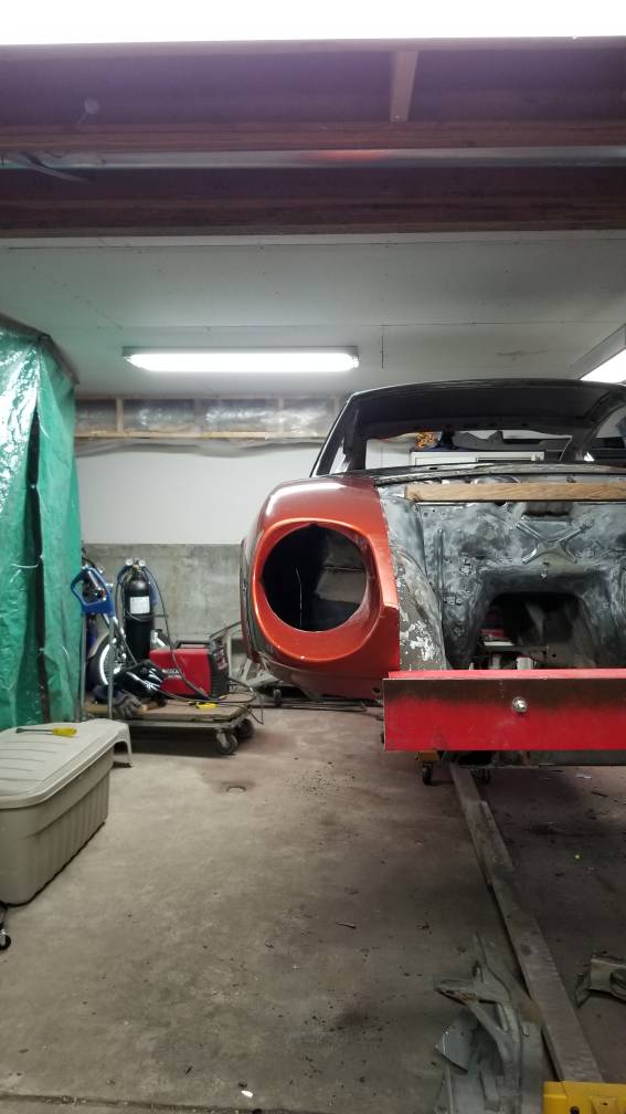

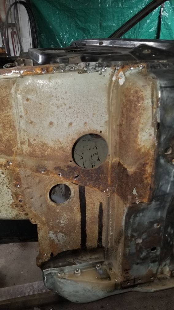

December 14, 20186 yr Author comment_563728 Got the drivers rocker in and all the work behind it complete. Drilling spot welds on the upper frame is a pain! Will be even more so when i have to pop the one off the repair chunk. Found some secret rott under the a pillar section of the upper frame.foing to have to tidy that up and por 15 the inside before fitting the replacement. The biggest pain is welding/cutting in around thos oval air ducts just behind the rad support. My passenger side job wasn't the prettiest, hopefully this side I'll find a way to make it tidier.Any of u guys ever use this pro form epoxy primer? Sent from my SM-N950W using Tapatalk Link to comment https://www.classiczcars.com/forums/topic/59909-where-to-go-with-this-rusthole/?&page=12#findComment-563728 Share on other sites More sharing options...

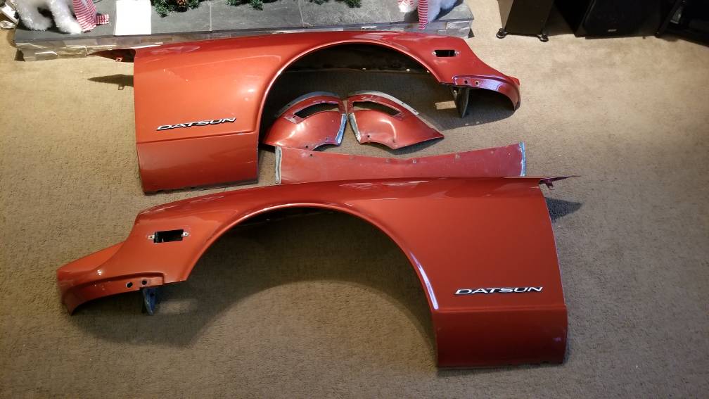

December 15, 20186 yr Author comment_563799 Couldn't have asked for better fenders man, grannyknot I was reading some more on the pro form stuff, says to do 1:1:1/2 reducer for sealer. Is that right? Just thin it out for sealing purpose vs primer I guess. Doesn't make sense to me hahaSent from my SM-N950W using Tapatalk Link to comment https://www.classiczcars.com/forums/topic/59909-where-to-go-with-this-rusthole/?&page=12#findComment-563799 Share on other sites More sharing options...
December 15, 20186 yr comment_563806 Those look like they are in perfect cond.? I bet you're thinking about changing the colour of the car now to match the fenders. I can't remember off hand what the ratios are but you should only follow the directions that Proform gives you, if in doubt contact them. Make sure you get all fresh product, new reducer and harder not some stuff you may have left on the shelf that you want to use up, new mixing containers and stir sticks. I can't remember, are you going to paint yourself or just doing the prep.? Link to comment https://www.classiczcars.com/forums/topic/59909-where-to-go-with-this-rusthole/?&page=12#findComment-563806 Share on other sites More sharing options...
