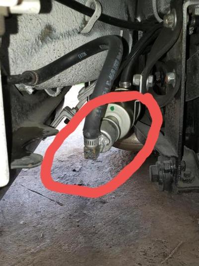

You are right. I did checked on one of the hoses clamped to the airtex 8012s electric fuel pump and even though its not dripping any fuel its a little bit worn. Should i worry about this?20191026_101820.jpg
This looks a bit suspect to me. Anyone one else see the kink or pinch?
You have plenty of extra hose. Cut that end off and reattach, IMHO.
 Yup, looks iffy to me. I'm not a big fan of rubber fuel lines in contact with the body. In the pic above it looks like the hose is too long. Cut it short enough to eliminate the body contact.
