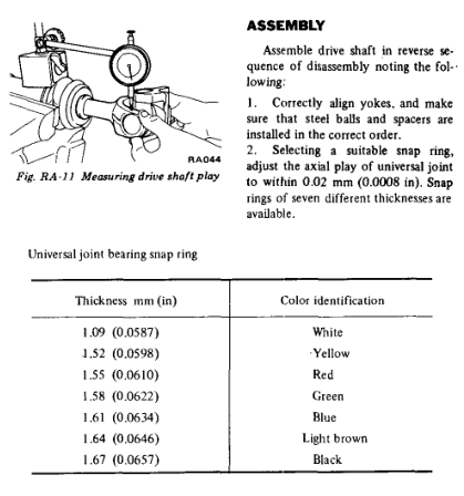

The Nissan joints have seven different thicknesses of retaining clip.  Probably why they cost ~$80 each  An old used Nissan joint is better than a new aftermarket joint, I think.  That's why I've stocked up on used half-shafts.
