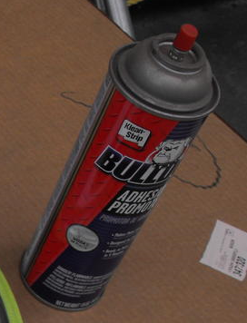

image.png  I used Bulldog Adhesion promoter on my Yellow Z urethane Air dam.  Works pretty well, much better than paint on plastic.
https://www.amazon.com/ADH-PROMOTER-15OZ-AERO-KLE-ETPO123B/dp/B005IUBMS6/ref=sr_1_1?ie=UTF8&qid=1515617607&sr=8-1&keywords=bulldog+adhesion+promoter

I've ordered exactly this so far. The question is, what did you put on top of it? Did you do a primer? Or did you just go straight some kind of "duplicolor" automotive paint?
43 minutes ago, motorman7 said:
I sanded the urethane air dam with 600 then 1000 grit.  Then sprayed on Bulldog, then sprayed on final paint.  No primer
Cool. That is simple enough. How long you had it on there, and any cracking yet?
Around 4 years and no cracking.  The initial paint that was sprayed by the shop directly on the urethane and started flaking off in less than 3 months.

As far as painting, rattle can paint really isn't very durable and will come off with some solvents. Some paint shops can mix up colors in catalyzed spray cans. The best thing is to really just get it painted or paint it yourself. You can probably get someone like Maaco to paint it for you cheap if it's off the car. Your could bulldog it first, so then they could do a final once over sand, degrease and spray.
