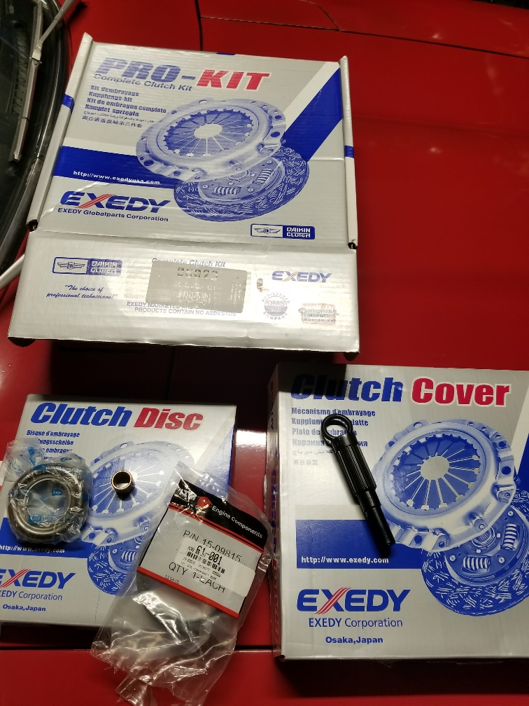

List all of the parts that you have and we'll tell you which ones to be careful with.  The throwout bearing sleeve is the most common place that people go wrong.  Some kits have it, some don't.  You didn't mention it specifically.

The Exedy clutches I buy are 6009s I think?  They don't come with new collars.  I think that's what Zed Head is referring to above?
Yes, Nissan calls it a sleeve.  We call it a collar.  It must match the pressure plate finger height, nothing else.  Even the parts makers get things wrong in their specs.  Measurements are necessary unless you're a gambler.
Thanks everyone for their help so far.  I have an Exedy 6029 Clutch kit (pictured) and the rear Main seal (also pictured).  I also attached a photo of the car in question.
