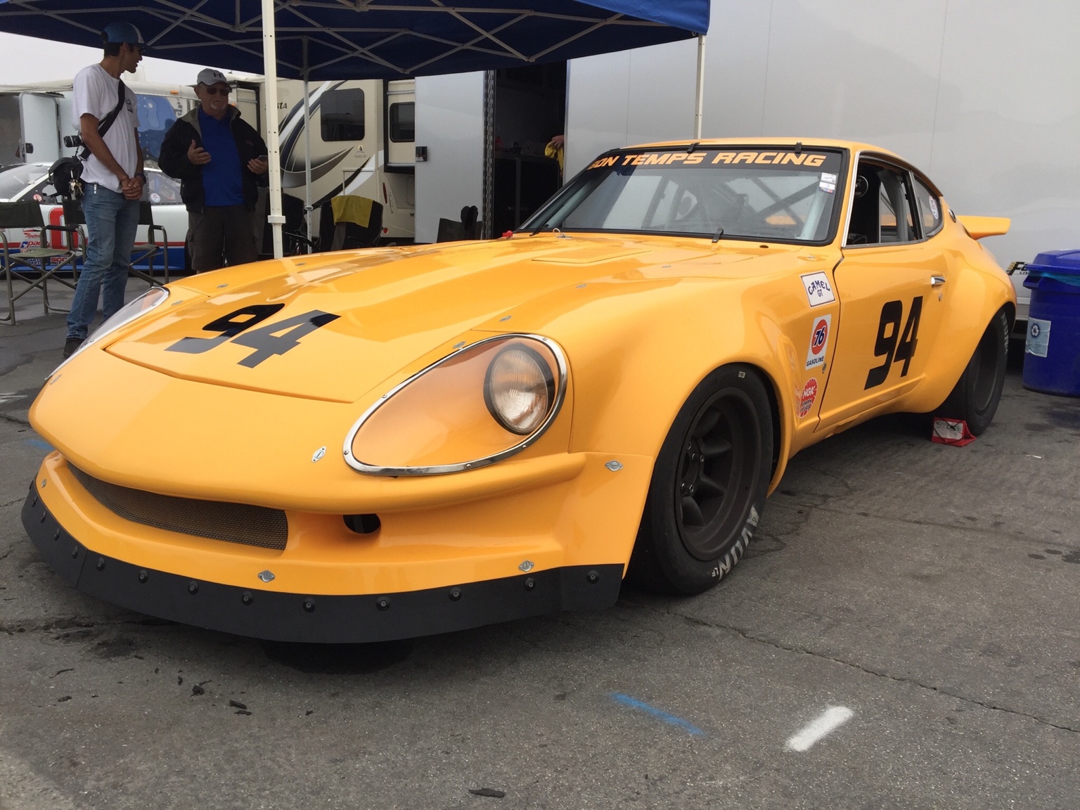

This 260z has them on the side, I was speaking to the gentleman in the hat in one of the photos, he owned/raced [i forgot to be honest ;( ] this 260z, he stated that the lift point on the side allows for jacking a whole side with a single point.
