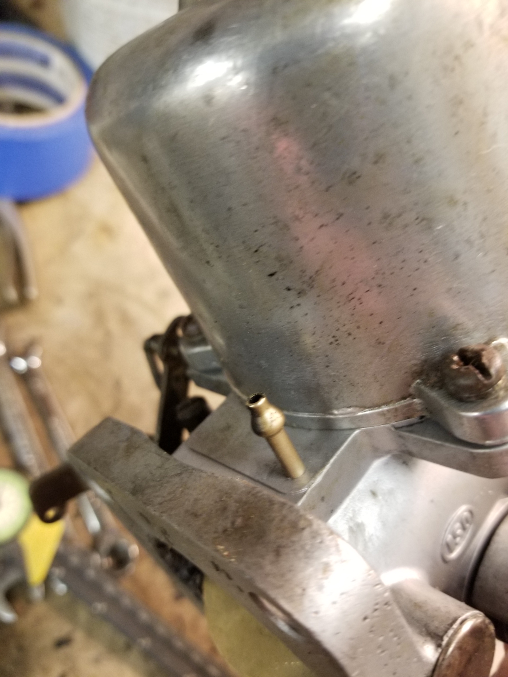

I have been working on cleaning the SU's. I would like to get it running if possible. I am not planning on keeping this car, just get it far enough along that it gets saved. We'll see
But I have a question. Where is this port supposed to connect inside the carb? I can't find the other end of the passage
Spray the carb with soapy water, blow in the port, and see where the bubbles happen.  Or put a hose on the port so that you can get your ear in the right place to hear a hiss when you blow in it.
It goes straight down. Its the vacumm port for the dizzy advance. Pretty tiny hole, but it should be right there in the bore BEFORE the throttle blade for ported vacuum

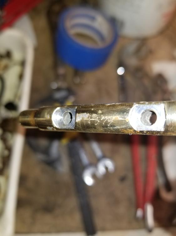

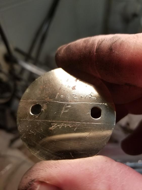

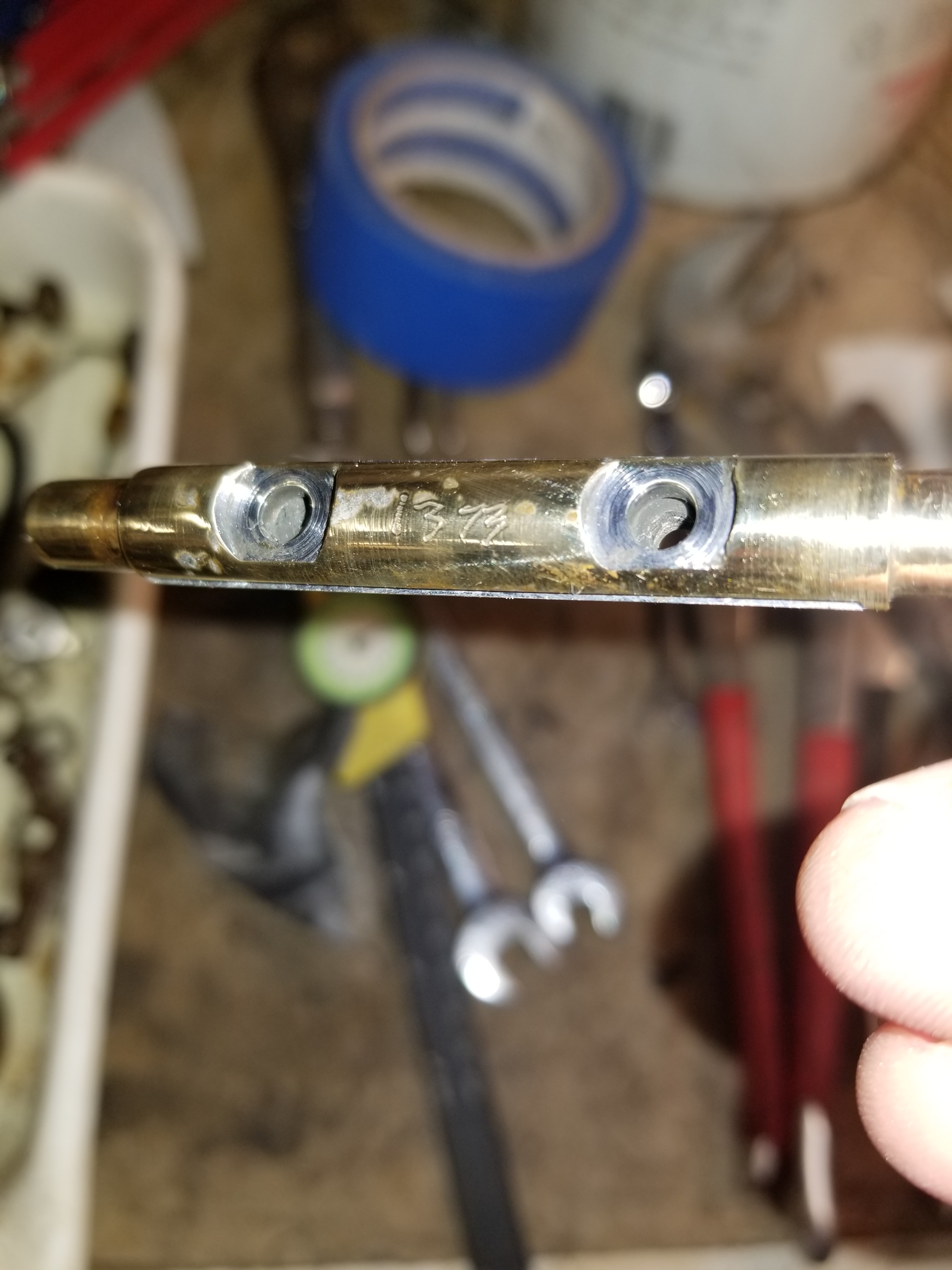

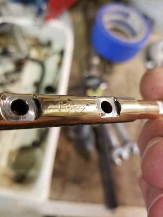

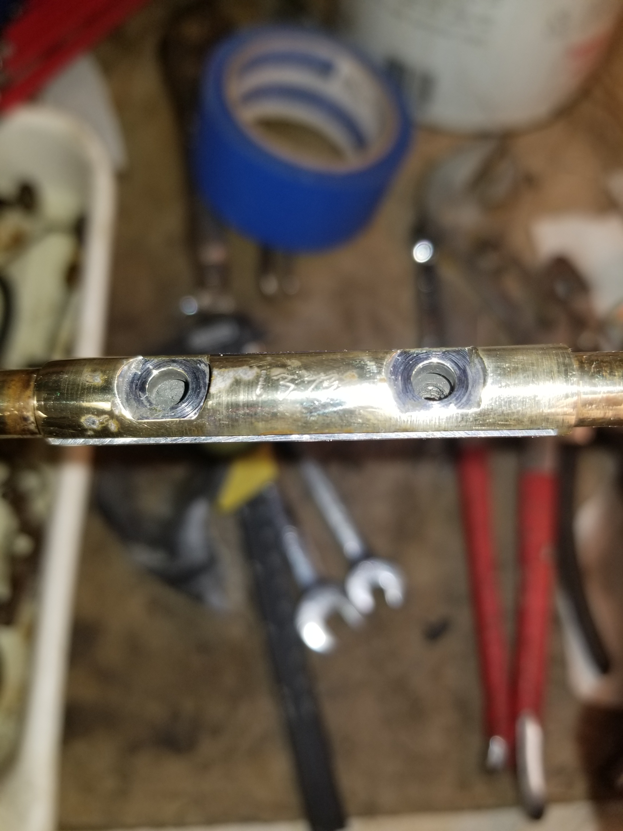

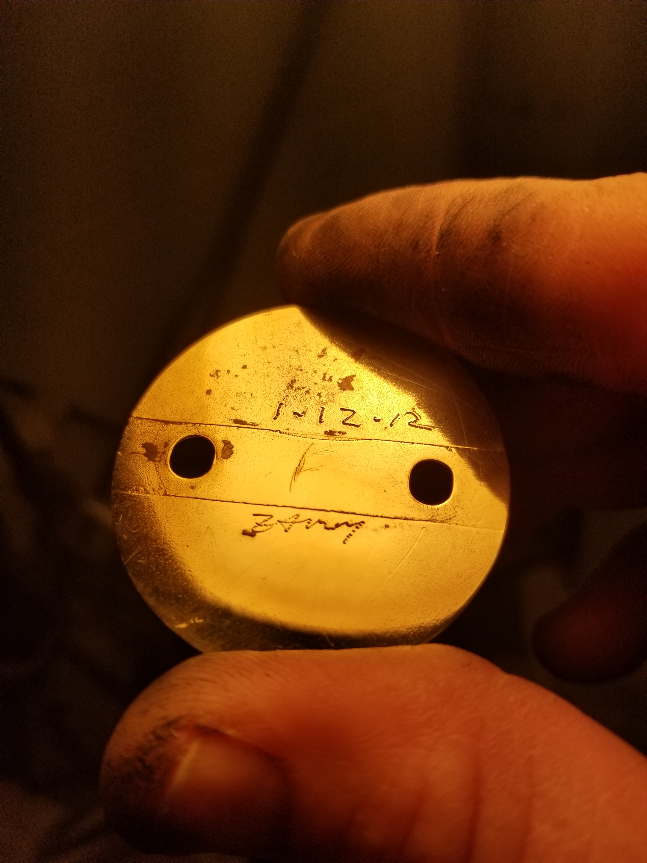

I thought it probably went straight down but I couldn't see it in the bore. Not surprising with the amount of corrosion. I am withholding the after clean up pictures for now. I eventually got both SU's apart and cleaned up. I had to use a heat gun and assorted methods to get the throttle plates moving and out. I believe these were rebuilt by Ztherapy at one time. I am still hoping I can get it running. Then I will show what it's using to run with...
If I can get the motor free enough and get the starter to spin it.Then I will try to get a spark and fire it up...
Z therapy carbs are "Signed" and dated inscribed on the throttle blades, engine side. Once you get them cleaned up it will be more obvious.
That's why I think they are
