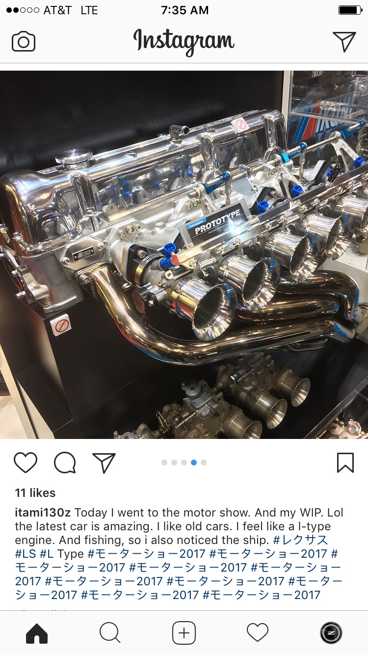

I just saw this on instagram. Not sure where the photo was taken but it's an L series head with FI and a plate on the head that said "Mikuni" and one on the throttle body that says "fuel injection prototype."
I've never heard of this. Anyone know what's up?
Looks like Z Car Garage will be showing off the Jenvey FI system at SEMA -- this installation is on the OS Giken head as well :o
