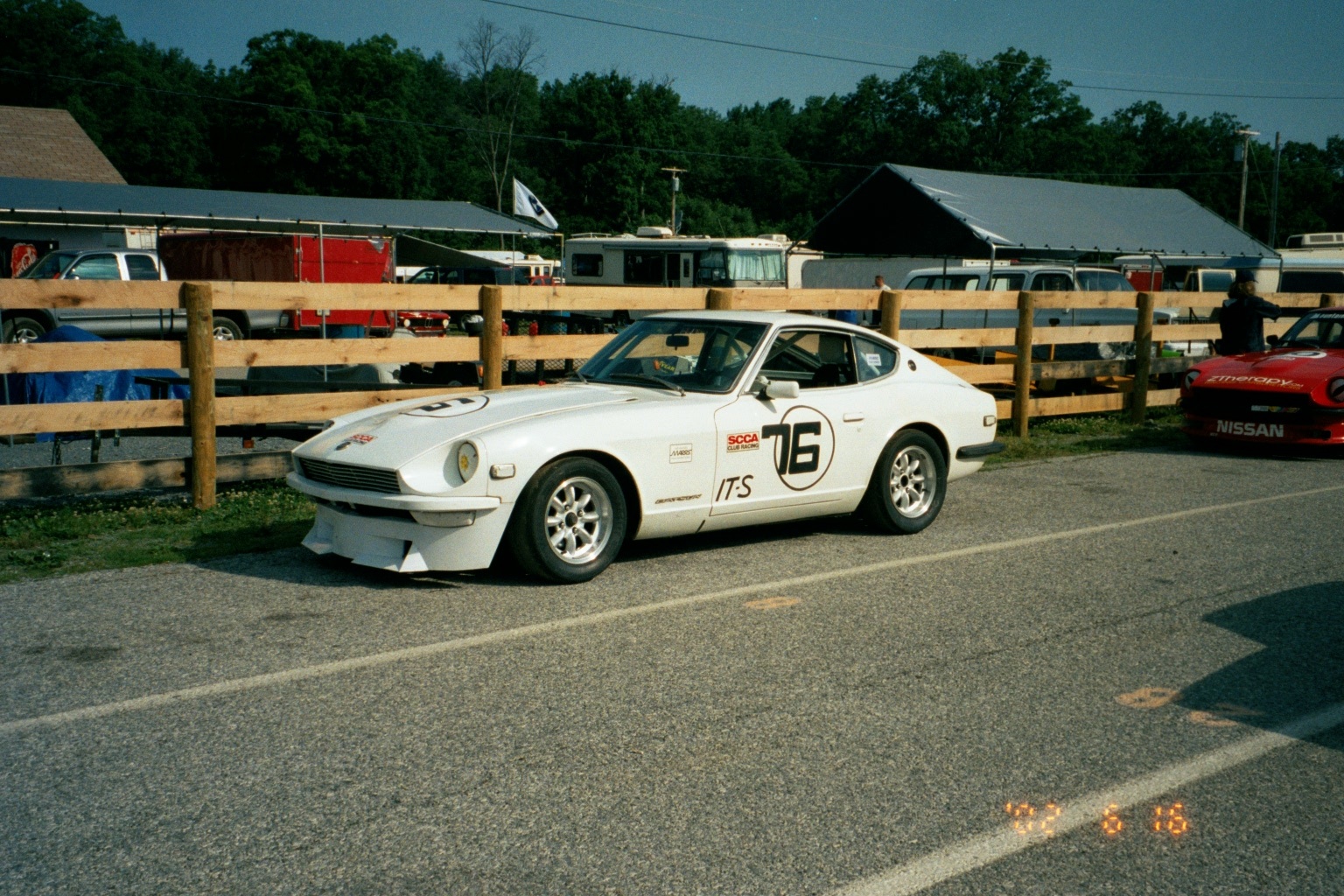

We use stock calipers, rotors and drums on our race cars and have no fade issues after 30 minutes of racing. The key for us is the Carbotech pads/shoes and high temp brake fluid. A guy in a 280Z doesn't even use any brake ducts yet he has won many races and a championship.
Chuck

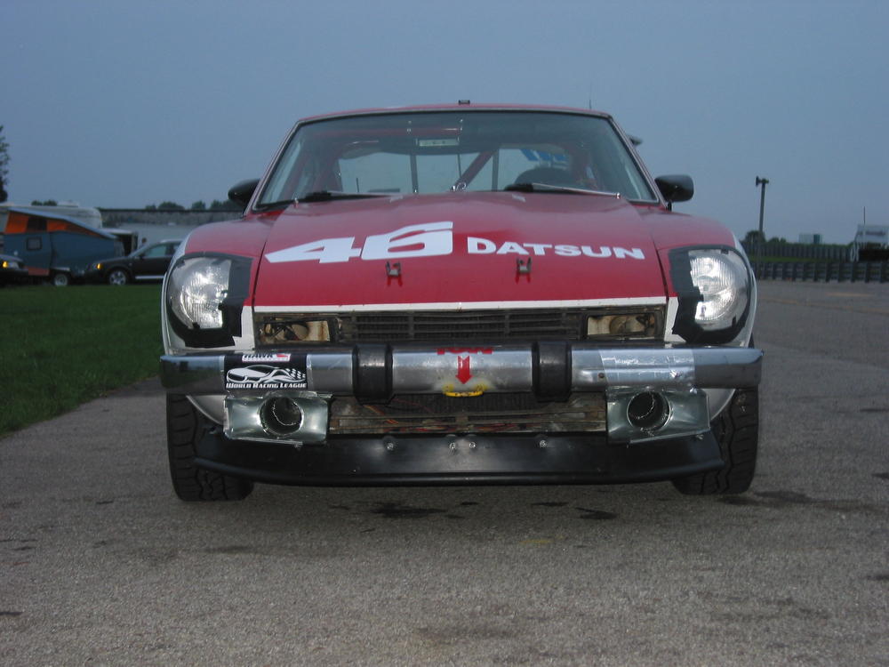

We run stock brake hardware on our endurance racer with just high temp fluid, braided hoses, and Porterfield linings.  We did finally add brake ducts in front but I'm not sure it was needed.  Our races are up to 25.5 hours long and fade has not been an issue.
That said, keeping the drums adjusted is a pain and our plan is to finally upgrade to vented fronts and rear discs.  As the car gets faster with more mods, we will need more brake performance.
LOLLOLLOL  Close Cliff.  The ducts are made from ductwork.
I hate this pic.  The temp dropped overnight and my headlight covers developed small cracks at the fasteners.  I had to tape them up to keep them from cracking further.  My car looks like Alice Cooper.  ROFL
