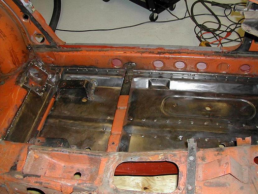

I finished the drivers side a few months ago and started the passenger side today. The Zedd pans and extensions underneath worked out great. Take your time and a lot of measurements for the seat mounts. I measured from the rear vertical wall directly behind the seats to the center of the seat mounting holes. This saves a lot of hassle when trying to align everything when reinstalling the seat mounts. The easiest way I found to take them out was to just cut the floor around them away since it was going anyway. After they are out you can just use a grinder to take the spot welds off of them and drill holes where the welds originally were to reinstall to the new floors. The spot weld cutter and drill was a little big to work around the seat mounting in the car. Also only do one side at a time if possible so you always have a reference if needed. Here is a pic of the drivers side installed, not perfect but it will work.
Hope this helps.
It also helps to bolt up the tranny mount so the tunnel stays in the same shape as it would under normal conditions. If not you can end up with a too wide or narrow tunnel.
The seat brackets for 240s can be purchased as an aftermarket item from:
www.baddogparts.com
