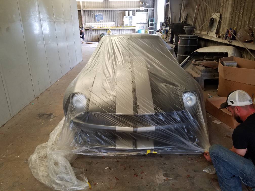

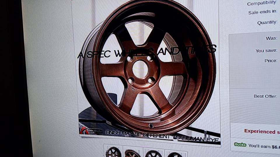

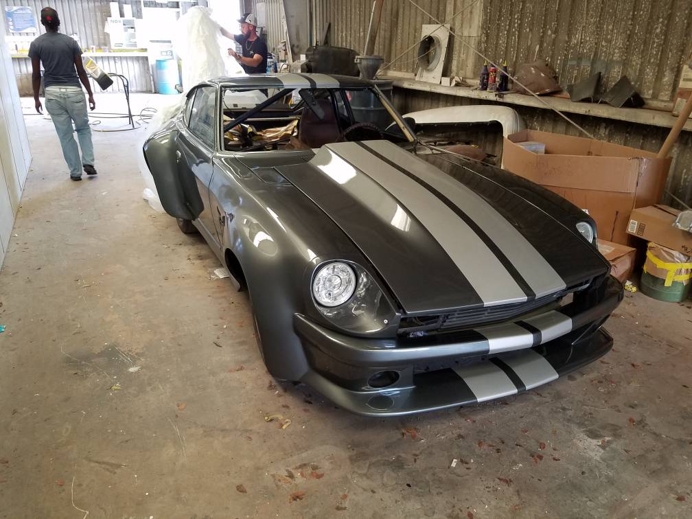

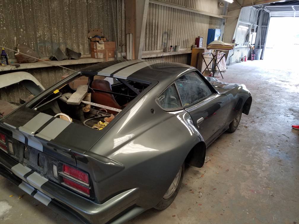

Hello, I have a hybrid Z with an IMSA race series wide body kit. I had a really hard time finding Wheels trying to keep the four lug pattern. The only thing you might get out of putting in a wheel spacer it's probably bearing distortion. As the spacers are close to being balanced but not 100% percent.
It was either I spend approximately $5,000 on custom wheels or settling for a simpler wheel. I came across a relatively decent set of wheels with zero offset on eBay. As my car is 15 inch wider in rear stance and 8 inches wider in the front, was very hard finding rims. Overall I decided to go with a 9 inch wide, 16 inch rims, this gave me a very wide choice of tires in the extreme summer category. My car has the small block Chevrolet with 440 cubic inches, 700 + horsepower. So I wanted a really good aggressive tires.

pics please :)
