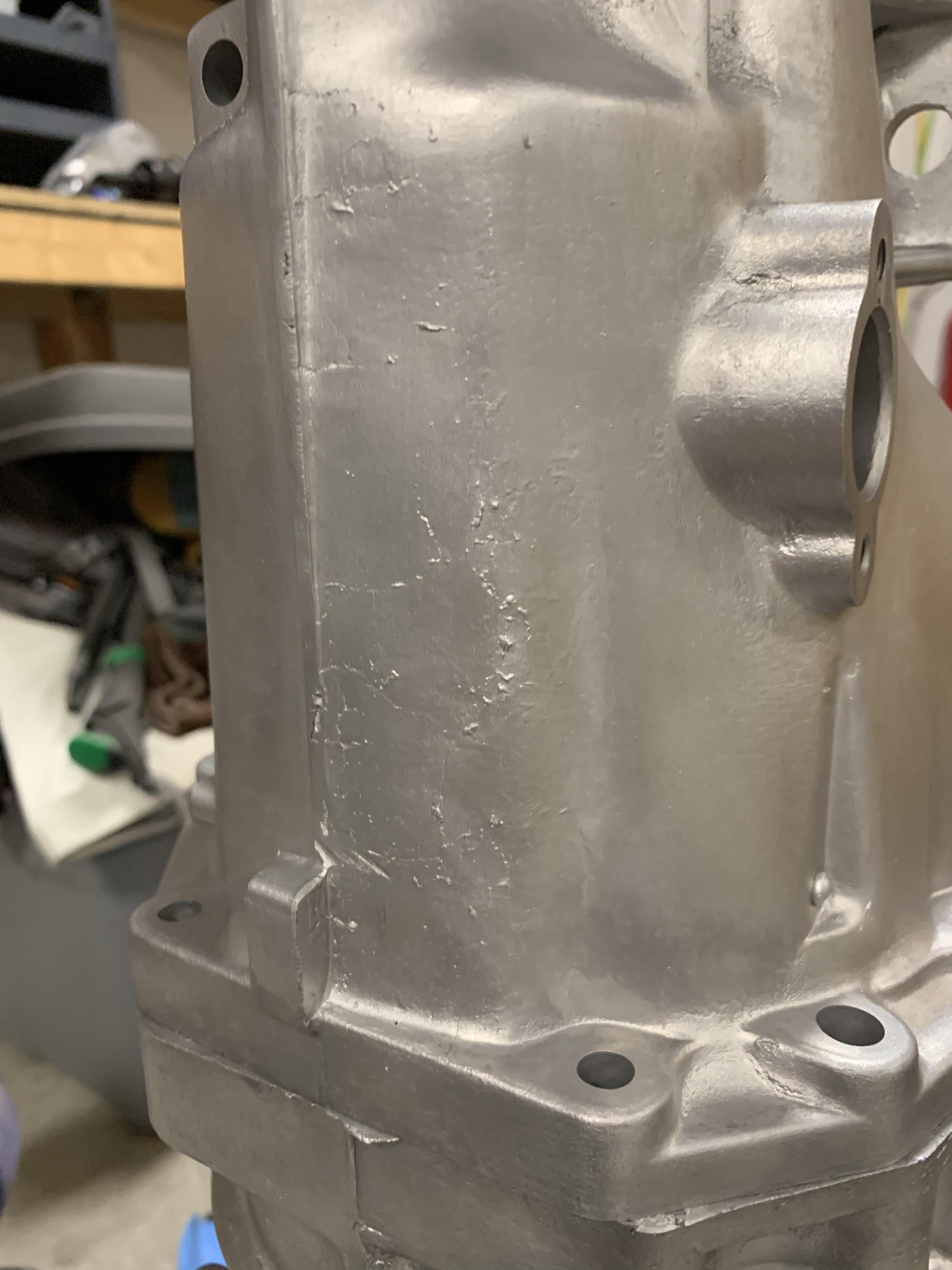

Vapor is worth it. But so labor intensive on such a large dirty part. Also not then best casting.l, which makes cleaning take longer. Now it shows finger prints.
Glass and sand blasting would hurt the surface.

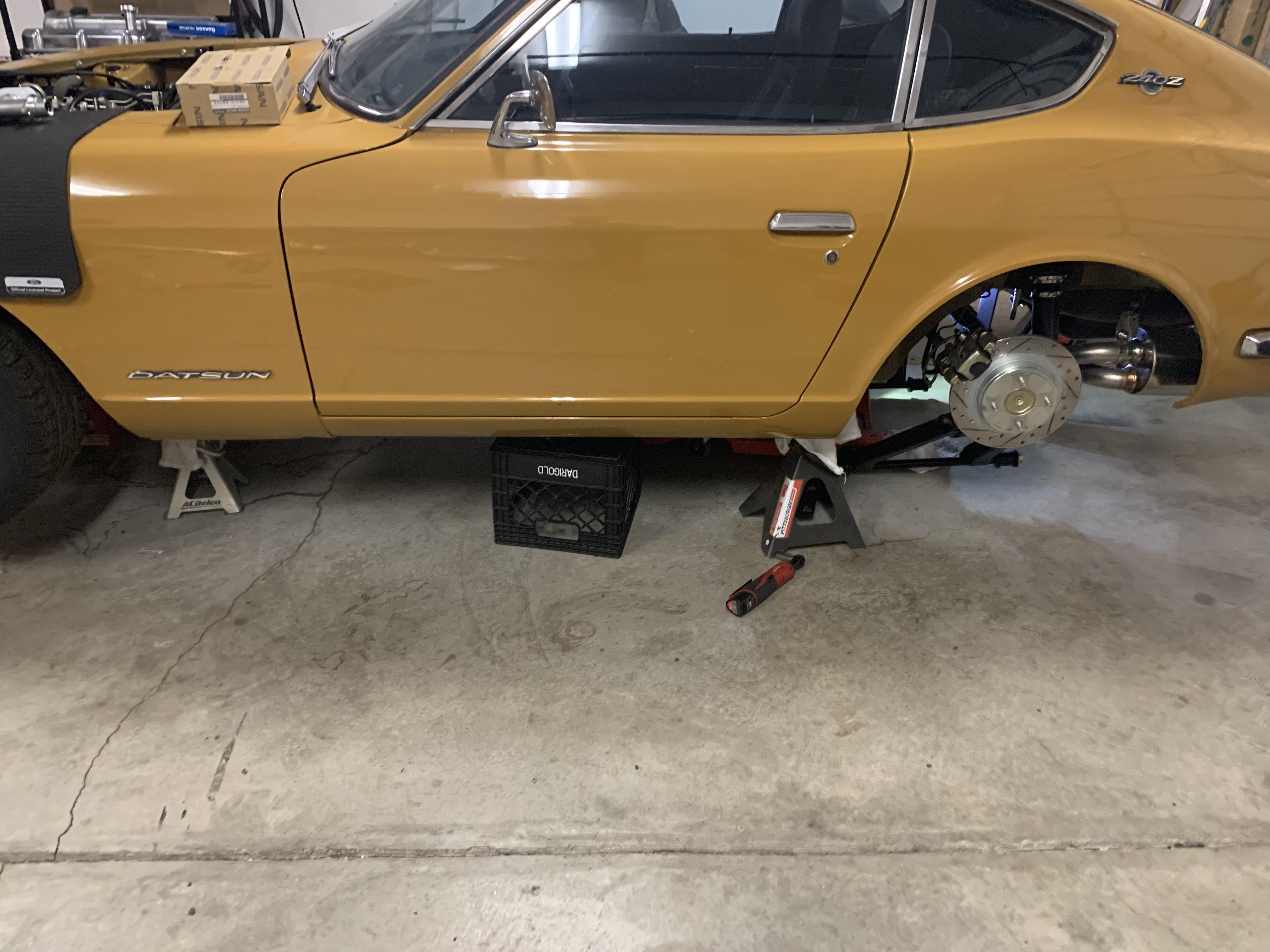

Well old diff is out. Half shafts are being a paint and not coming off easily.
I need a lift. Sadly I need a new house for the lift:)

I agree that bead blasting and pressure blasting are more aggressive but we were ok with a little courser finish. We sealed the case with a clear sealer after blasting. Plus it's likely to end up grimey eventually because the car will be driven often.

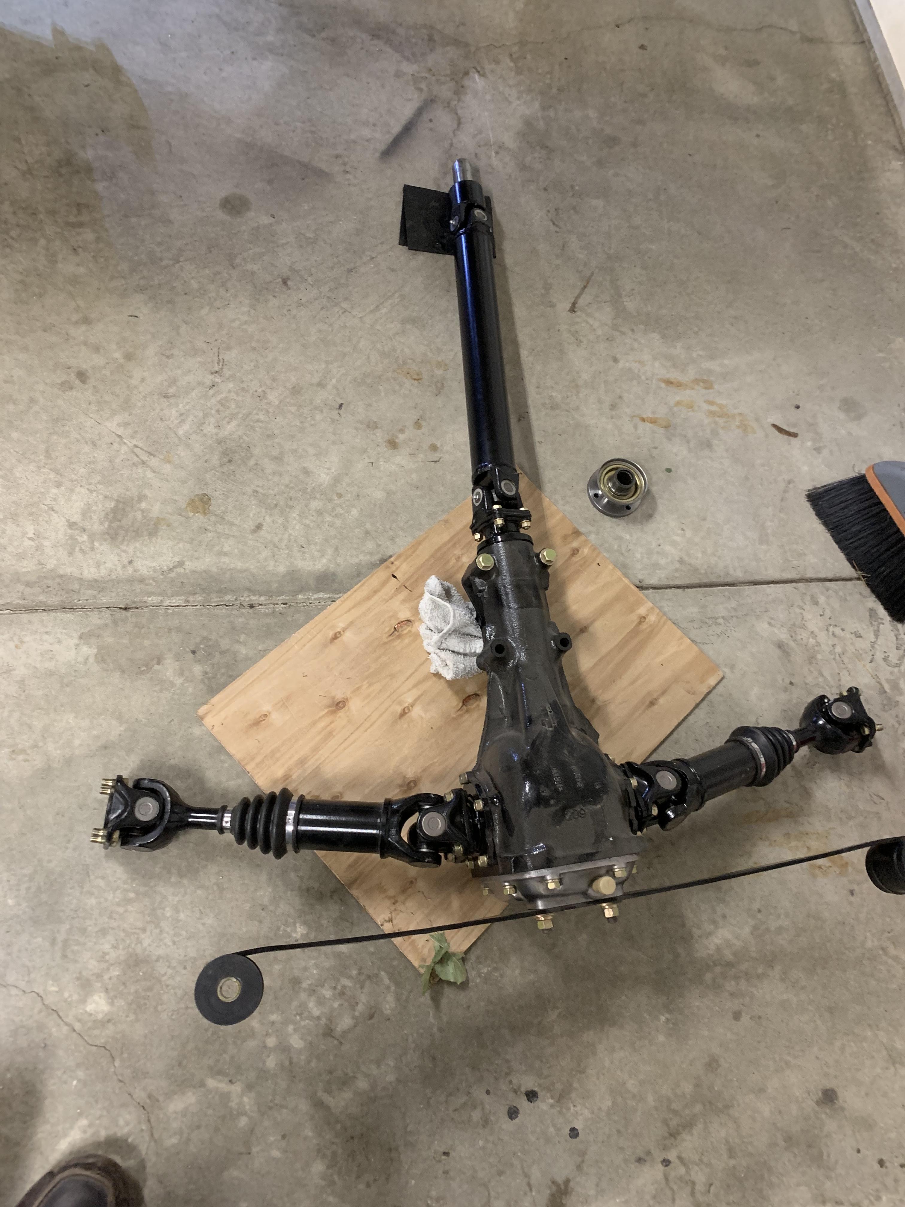

If I may ask, what were you charged by the shop for the powder-coating of the Diff?
Also:  You say that you own your vapor-blasting system.  Is this an over-the-counter unit or did you build it yourself?
