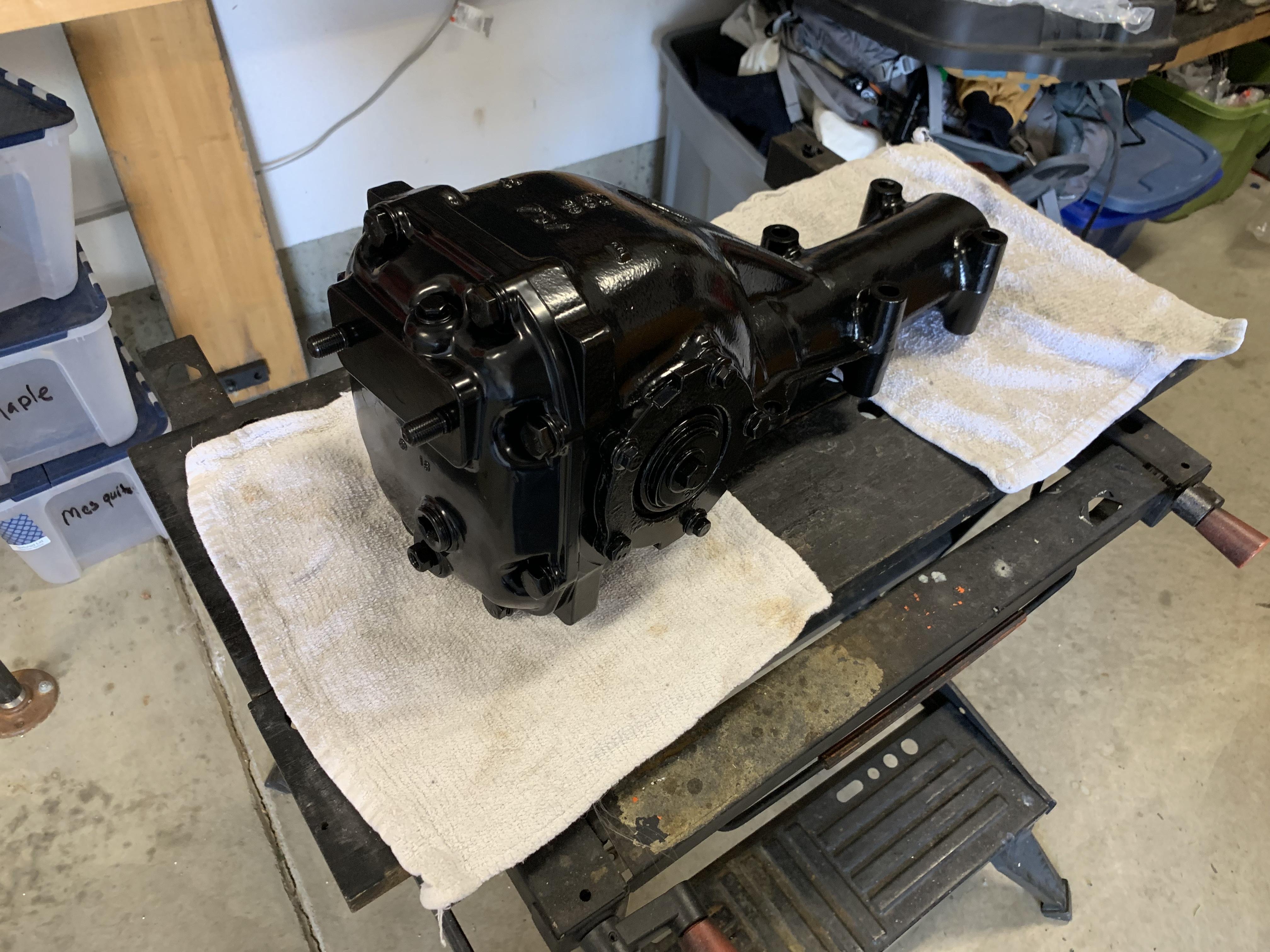

Diff is prepped for powder coating. Inside is clean and empty. I sealed it to minimize sand and powder getting in. I will then burn the powder off the aluminum parts and then wire wheel smooth and vapor blast to look perfect.

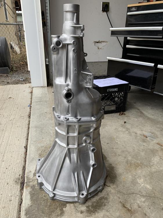

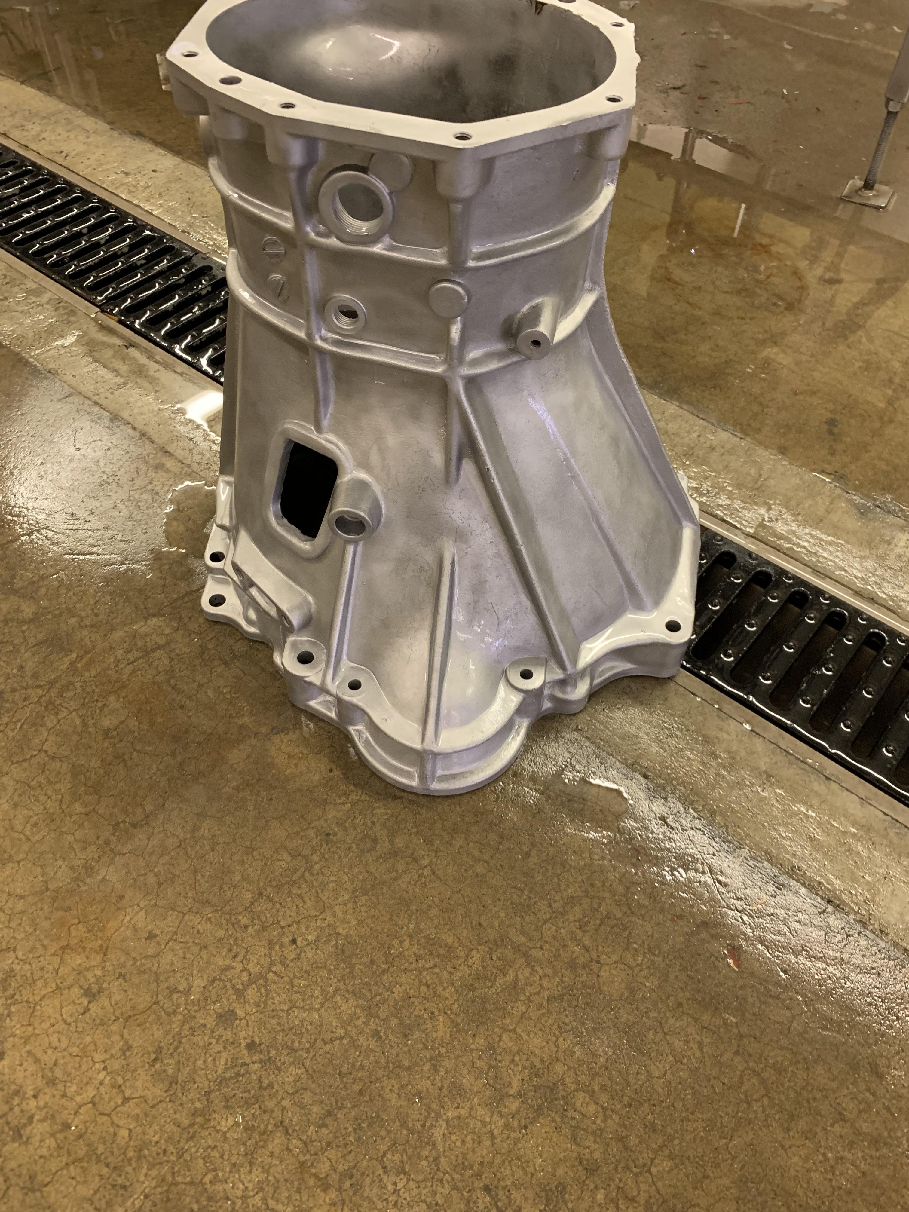

I got the 5 speed close ratio transmission case vapor blasted. Took forever, like most of a day.  Looks good though
