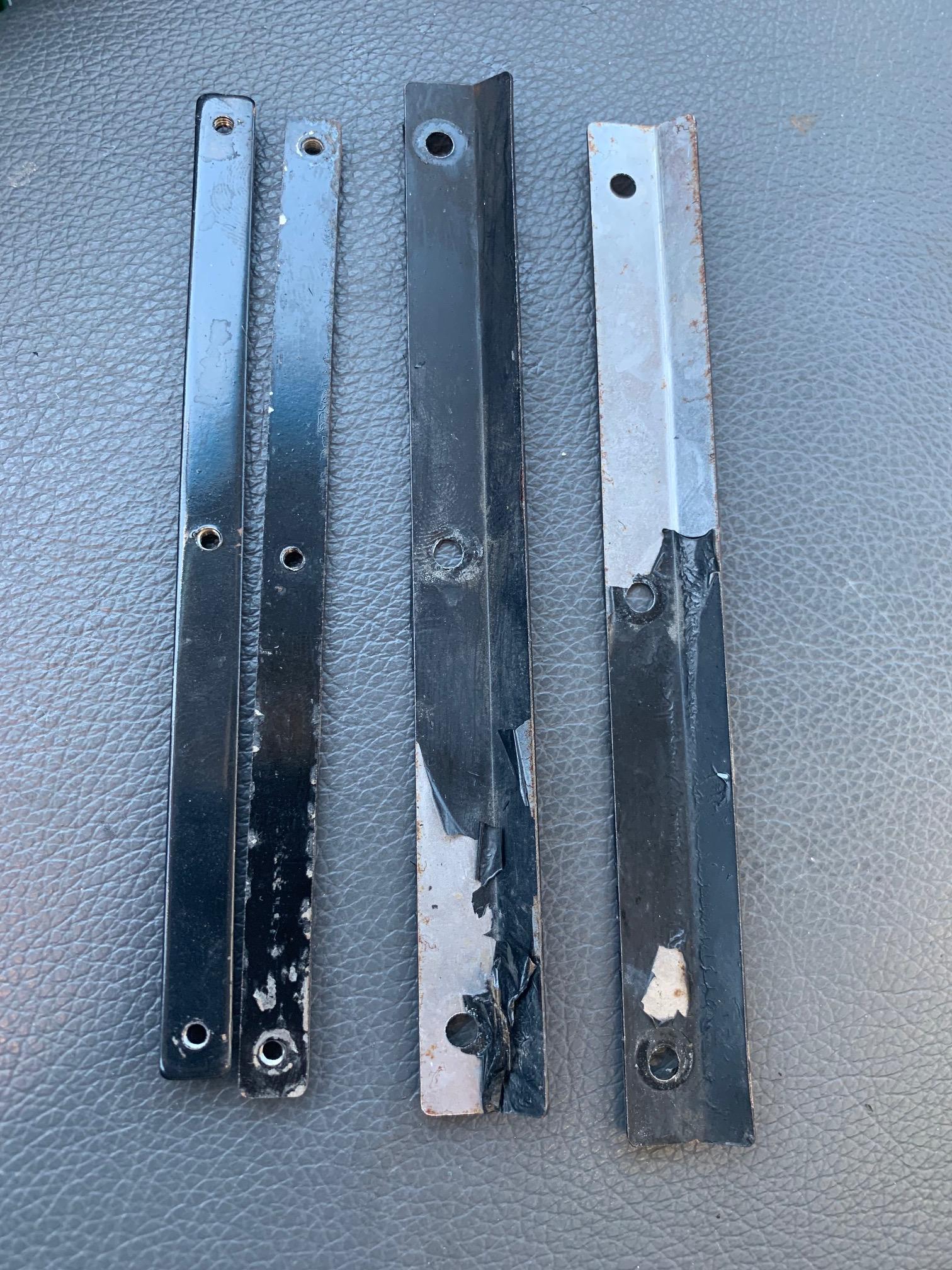

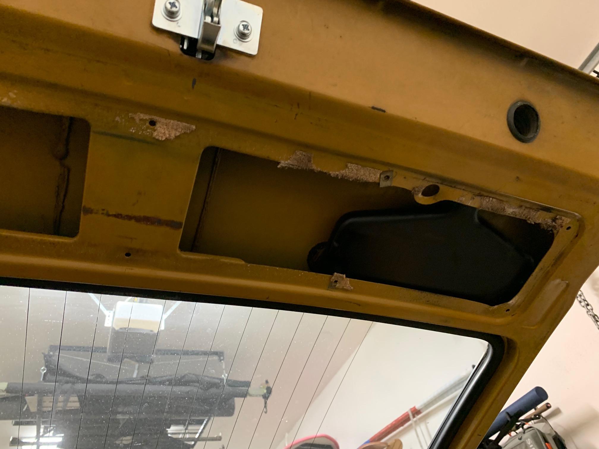

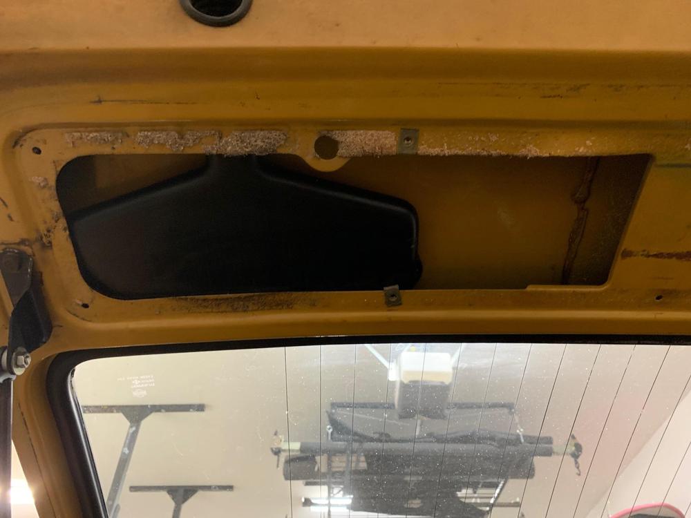

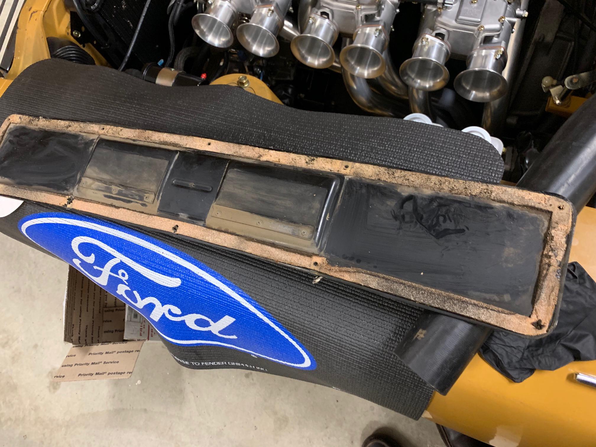

Well I had to pull the hatch vent cover to get to the some of the parts for zinc.  The cork had turned to the oddest goo/ glue.  Anyone have a foam seal they used for this spot?  Needs to be thin 1/8th?  Also the tiny brackets for the vent had paint coming off so I had them powder coated.  Should outlast the z body:)  Only a tiny bit of surface rust in the vent area.  I am thinking about converting the rust and doing cavity wax.  Thoughts?

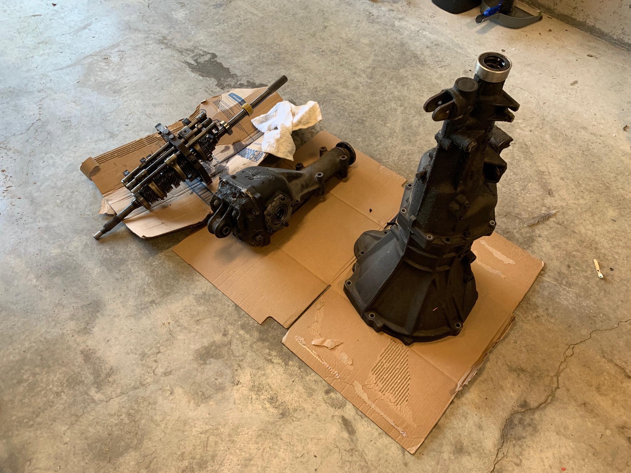

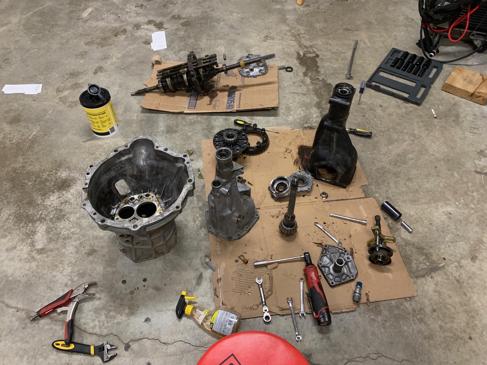

I have decided to do the 5 speed swap.  A fellow z guy had a hoard of parts and hooked me up with a close ratio 5 speed and a later R-180.  R180 will be 4.11 gears and OSGiken LSD.  Trans will be rebuilt, vapor blasted, then all steel parts will be zinc, powder or professionally painted. Rear end will be powdercoated 60% gloss black, then all steel will be zinc coated.  Should look super nice.
