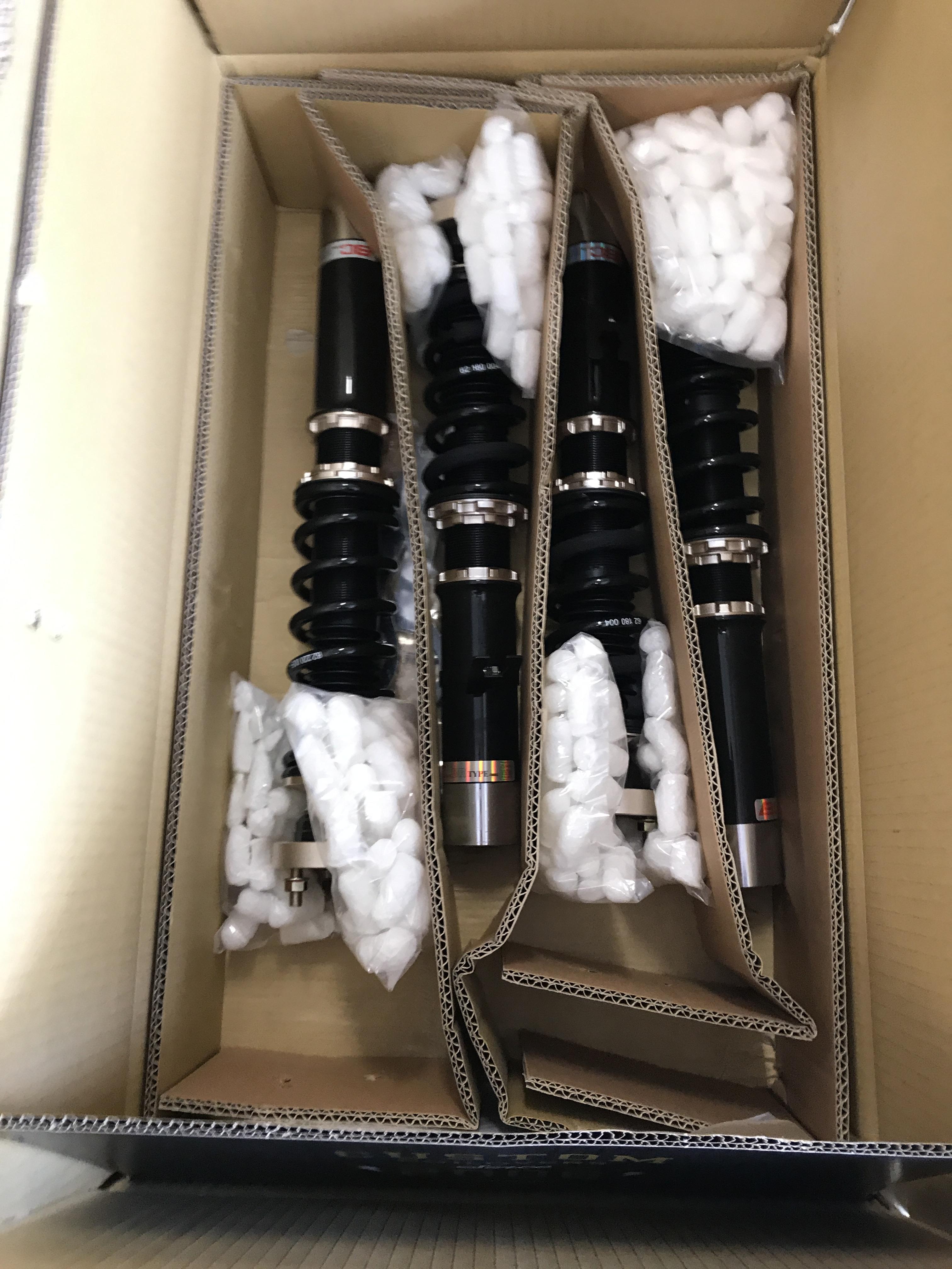

    Got my BC Coilover kit!! I should have the fronts done this weekend.  Still waiting on the auto shop to have the bearings pressed out.
    Looks a lot like my CX Racing set. Did you get extended stud standard bolt pattern or four bolt pattern?
    Mine are stock pattern.
    Share this post
    Link to post
    Stock pattern, they are probably the same kit:) I just paid too much.  I really like the gold of the BC.  I got standard stud length, but they seem long.
