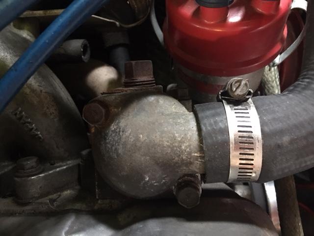

Would it be best just to replace this with an  identical  unit or should I install a  temperature sensor in  place of the threaded plug of the thermostat housing? If so, does anyone have an idea what the threading is on this plowed?

The plug on the thermostat housing looks more accessible so I'll unscrew it and take it to a hardware store and maybe I'll bet lucky.
Would that lug on the thermostat housing be on the hot side or cold side? I thought the sensor in the side of the block gave me the most consistent block temp.
