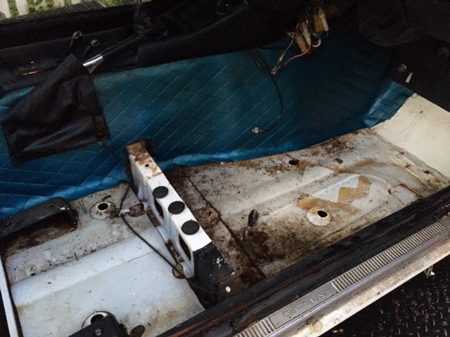

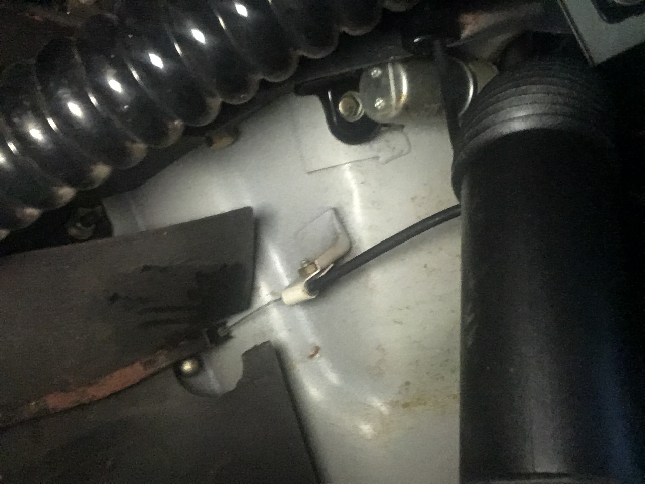

This Z seems to have the throttle control still intact. The lever is still present on the console and the cable is still attached to the gas pedal assembly. The original owner reports that it came that way, he did not add the system back. Interesting.

Yeah. Maybe consider not fully re-attaching that. Honestly, that thing was a seriously bad idea (from a safety point of view).
having said that, now I want to go get the rest of one of those assemblies and hook it up on my car just to see how it works. I have the lever assembly, but not the cable assembly.
Cool, My car had both the bracket and connector on the gas pedal. I found the lever and cable on Ebay. I have always had my hooked up since I finished the refresh on it. It is way too cool to remove. Not sure how it is unsafe?
The bracket and notch at the top of tne pedal came on all cars until the center console was redesigned. They were two verisons of the bracket, an earlet and later version. I posted pictures of the two in another thread years ago. The plastic grommet will usually still be attached tat the top of the pedal if the handthrottle was previously instelled. That is was what I found on all four of my early cars which indicated they came with handthrottles but they had been removed.
