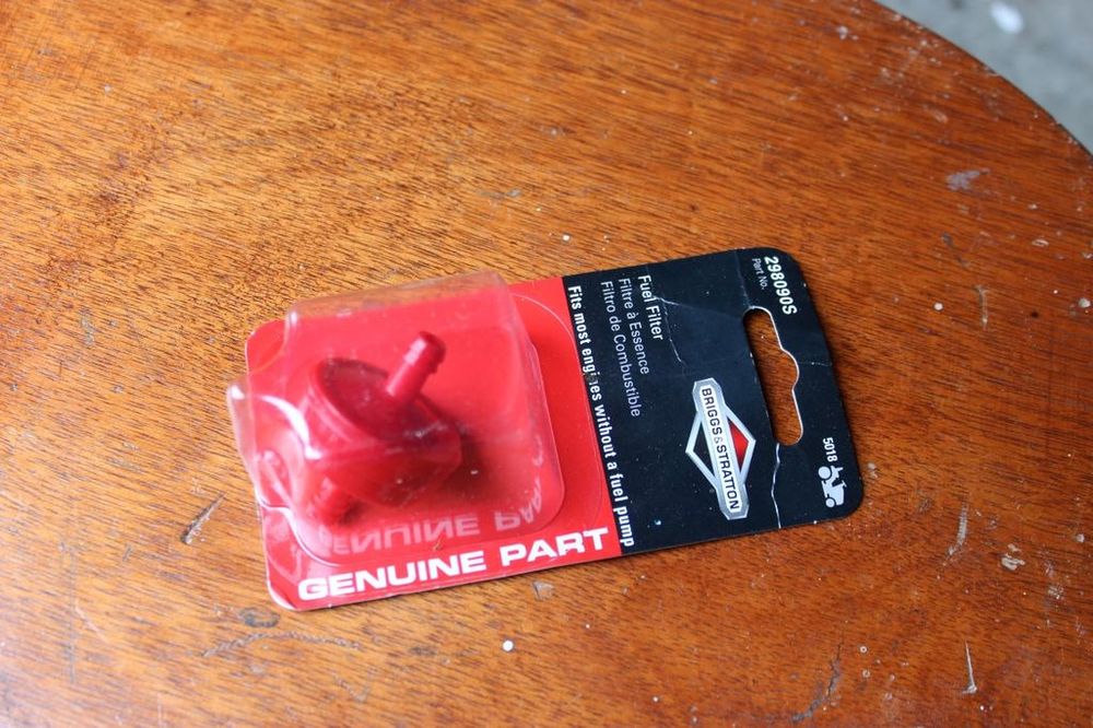

Something else I forgot to mention earlier, when I rebuilt my carbs and cleaned the tank I worried about debris getting into them since I had left the banjo bolt screens off. I googled "push lawn mower fuel filters" and found some UFO looking very small ones with the highest micron number? I think it was. Put one on each short fuel line from the fuel rail to the individual carb. Ran those for a few tanks then removed them, too many potential leak spots and it looked like $^!# with all those hose clamps on my cleaned up fuel system.
Similar to this but mine were clear.
