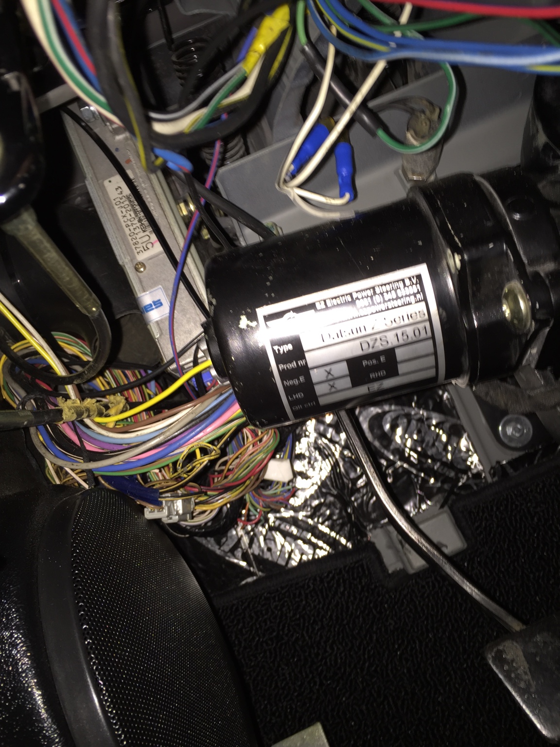

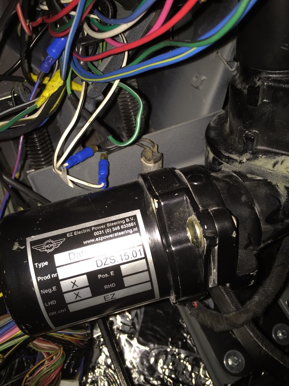

April 25, 20178 yr comment_519137 We installed this one in the S2000 Zbuild. It has a speed sensor that automatically adjusts it based on speed. Photo shows web site. Works good so far with little use. Don's iPhone using Classic Zcar Club mobile Link to comment https://www.classiczcars.com/forums/topic/57571-power-steering-kis-for-z/#findComment-519137 Share on other sites More sharing options...

April 25, 20178 yr comment_519144 Go to their website. www.ezpowersteering.nl/car/7/15/Datsun.htmlThere is a USA sales agent in Tennessee listed on their web site. Don's iPhone using Classic Zcar Club mobile Link to comment https://www.classiczcars.com/forums/topic/57571-power-steering-kis-for-z/#findComment-519144 Share on other sites More sharing options...
