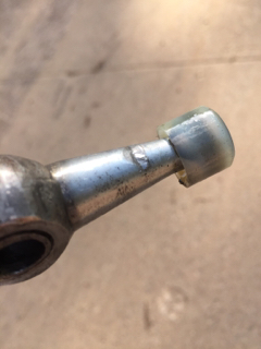

April 4, 20178 yr Author comment_517256 FrontRearSent from my iPhone using Classic Zcar Club mobile Link to comment https://www.classiczcars.com/forums/topic/57424-280z-5th-gear-synchros-gone-bad/?&page=3#findComment-517256 Share on other sites More sharing options...
April 4, 20178 yr Author comment_517259 Removed the rubber that was at the bottom of the shift rod and took it out for a spin - same result - popped back into neutralSent from my iPhone using Classic Zcar Club mobile Link to comment https://www.classiczcars.com/forums/topic/57424-280z-5th-gear-synchros-gone-bad/?&page=3#findComment-517259 Share on other sites More sharing options...

April 5, 20178 yr comment_517279 Looks like you have a short through selector stick with a short eared guide. What that means is your selector has a longer section under the cotter pin and the guide ears (where the cotter pin anchors) is short. Common for people to swap these selectors to get a shorter through when changing gears. The problem is it can bind and you need to remove (grind) sections for clearance. It looks like your could be hitting. I can't really see fresh marks on the selector. To check, you can put it back together with cotter pin in place and slide a piece of paper down in there. Push it into 5th hard a couple of times and check the paper for pinch makes. The clearance you need is about the thickness of cardboard used in a Kellogs cornflakes packet. Cliff (siteunseen) posted photo's of the selectors on another thread on this site. Can't find it now. I don't know what the rubber hose is doing on the selector. I'd remove it. Link to comment https://www.classiczcars.com/forums/topic/57424-280z-5th-gear-synchros-gone-bad/?&page=3#findComment-517279 Share on other sites More sharing options...

April 5, 20178 yr Author comment_517292 Looks like you have a short through selector stick with a short eared guide. What that means is your selector has a longer section under the cotter pin and the guide ears (where the cotter pin anchors) is short. Common for people to swap these selectors to get a shorter through when changing gears. The problem is it can bind and you need to remove (grind) sections for clearance. It looks like your could be hitting. I can't really see fresh marks on the selector. To check, you can put it back together with cotter pin in place and slide a piece of paper down in there. Push it into 5th hard a couple of times and check the paper for pinch makes. The clearance you need is about the thickness of cardboard used in a Kellogs cornflakes packet. Cliff (siteunseen) posted photo's of the selectors on another thread on this site. Can't find it now. I don't know what the rubber hose is doing on the selector. I'd remove it.It could be that or a ZX transmission possibly, right? The pics I posted of the marks were after I cleaned them... they had some fluid in the mark when I pulled the rod out, which leads me to believe it's still hitting Sent from my iPhone using Classic Zcar Club mobile Link to comment https://www.classiczcars.com/forums/topic/57424-280z-5th-gear-synchros-gone-bad/?&page=3#findComment-517292 Share on other sites More sharing options...
