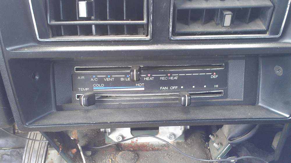

March 23, 20178 yr comment_516157 Nuh uh: Interesting! My 76 says A/C on the slider but never had it from the factory! So does my friends 76... Link to comment https://www.classiczcars.com/forums/topic/57315-buying-1975-280z-and-have-some-questions/?&page=3#findComment-516157 Share on other sites More sharing options...
March 23, 20178 yr comment_516166 Mine... Link to comment https://www.classiczcars.com/forums/topic/57315-buying-1975-280z-and-have-some-questions/?&page=3#findComment-516166 Share on other sites More sharing options...
March 25, 20178 yr comment_516319 On 3/23/2017 at 10:23 AM, wheee! said: Mine... You also have a "Recirc heat" setting that CO doesn't have Link to comment https://www.classiczcars.com/forums/topic/57315-buying-1975-280z-and-have-some-questions/?&page=3#findComment-516319 Share on other sites More sharing options...

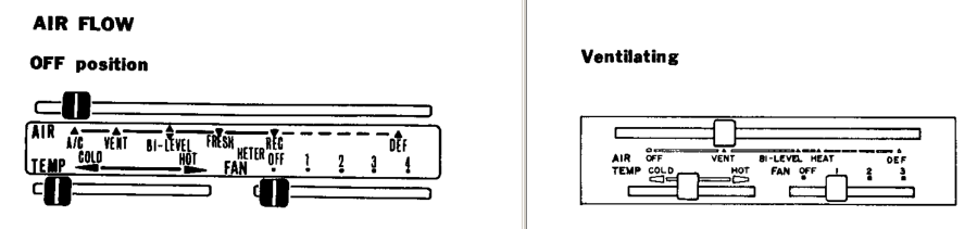

March 25, 20178 yr comment_516322 Here are the two panels shown in the 76 FSM. They put one in Body Electrical and the other in Air Conditioner. Edit - oddly, the AC unit has an extra fan speed. Edited March 25, 20178 yr by Zed Head Link to comment https://www.classiczcars.com/forums/topic/57315-buying-1975-280z-and-have-some-questions/?&page=3#findComment-516322 Share on other sites More sharing options...
March 25, 20178 yr comment_516360 Yeah, there's all kinds of changes between the A/C and non A/C manual system. One of the differences is that the only way I can change mine from fresh to recirc is to move it to OFF. In other words, the only time my system closes off the fresh intake is when it's in the OFF position. The fan still works even in OFF and the ducting is in the VENT position, but the only thing I can do is recirculate the same stale unheated air out the dash vents. I wish I had independent control over that duct, and it's on my list of pending future changes. Link to comment https://www.classiczcars.com/forums/topic/57315-buying-1975-280z-and-have-some-questions/?&page=3#findComment-516360 Share on other sites More sharing options...
March 25, 20178 yr comment_516365 Well then mine makes no sense with the slider on the bottom being connected... all one opening. Link to comment https://www.classiczcars.com/forums/topic/57315-buying-1975-280z-and-have-some-questions/?&page=3#findComment-516365 Share on other sites More sharing options...

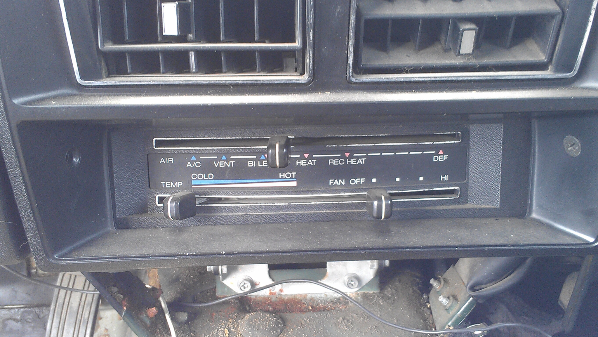

March 26, 20178 yr comment_516414 I didn't even notice that until you pointed it out. What's up with that? My 260 (which had A/C) didn't look like that. It had two separate slots for the temp and fan controls. I see that the chrome is missing from the middle of the top slot... Maybe someone removed the section between the two slots and mounted it upside down? I know I'm reaching here and I don't know why someone would do such a thing, but that's all I got. Link to comment https://www.classiczcars.com/forums/topic/57315-buying-1975-280z-and-have-some-questions/?&page=3#findComment-516414 Share on other sites More sharing options...
March 27, 20178 yr comment_516479 Yikes!!! You might be right. It definitely looks like that and I checked it today... the PO has cut open the slots because it was mounted upside down! The label was affixed after obviously. Now I need to check with@zkars to see if he has a faceplate that has not been cut that will fit my 76! I wonder if anyone makes the labels still....? Link to comment https://www.classiczcars.com/forums/topic/57315-buying-1975-280z-and-have-some-questions/?&page=3#findComment-516479 Share on other sites More sharing options...
March 27, 20178 yr comment_516510 Whaaaaaat?... I can't imagine a reason someone did that. I wonder if there was some weird HVAC customization planned that necessitated opening that slot. I cannot believe he simply didn't realize it was upside down!! As for replacing the label, don't forget that it's backlit. It's actually a piece of polyester on which they silk-screened the colors and text on the back side. Light shines through it. I doubt you could (ever) purchase just that label independently from other parts of the assy. I've had that part of the assy apart a couple times for my dash light LED conversion, but I can't put my fingers on any pics of that part of the process. I suspect I was in a hurry at that point and stopped taking pictures. Link to comment https://www.classiczcars.com/forums/topic/57315-buying-1975-280z-and-have-some-questions/?&page=3#findComment-516510 Share on other sites More sharing options...
