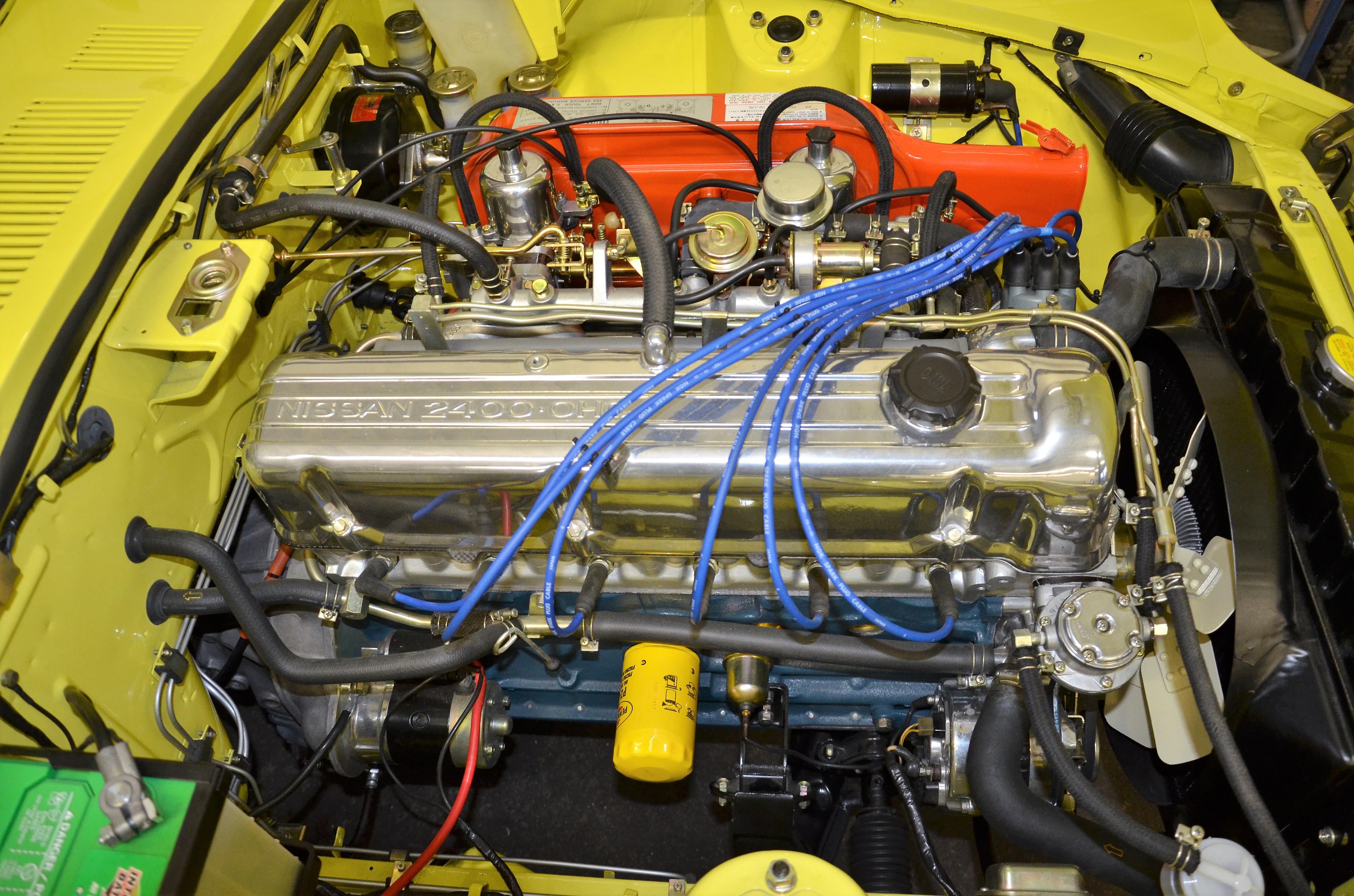

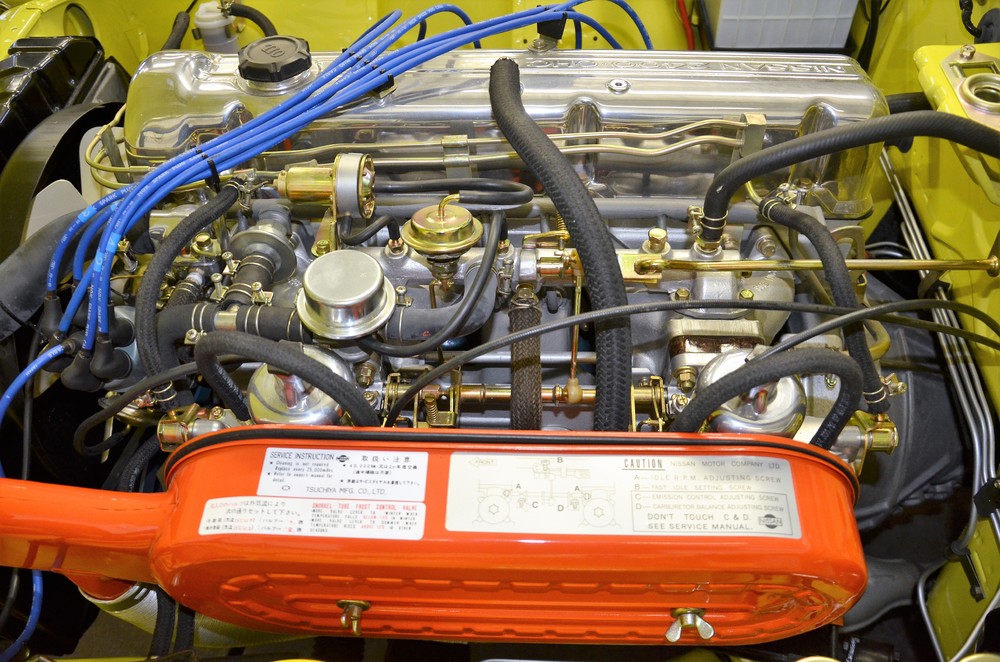

My car was built 4/71. So what I have done here is wrong. Water hoses, PCV and breather hoses are to be the cloth braided hoses. My fuel lines are to be the cloth wrapped. My float bowl vent lines to the air cleaner are to be what material?  Smooth fuel line hose? The sizes for the fuel lines are to cloth wrapped in 6 and 8mm? I did my clamp in yellow cad. Is that correct or are they to be like in the picture Clear Zinc. I have been also told not to use yellow cad plating. It was yellow zinc. Which is correct? I know I need black spark plug wires.

It seems to me I remember some hoses actually being a better fit with 1/4" hoses. I think maybe the supply from rail to carbs is actually 1/4". The 5/16 will work clamped down hard enough , but the 1/4 slides on tightly
I ended up with 4.5MM and 7.5MM hose. They are both a tight fit. I believe they will work well for this application and look good once the bling (restored yellow zinc original wire hose clamps) is added.B)

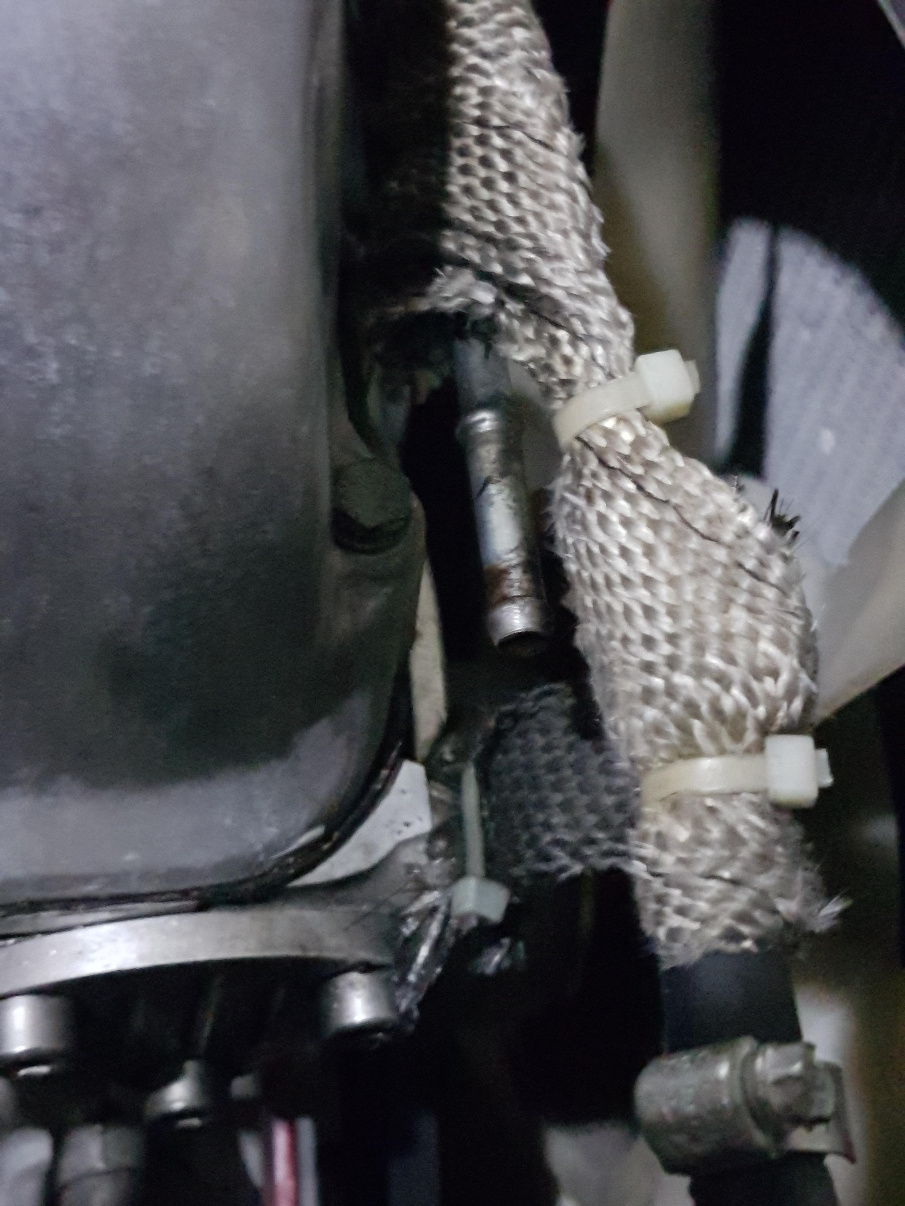

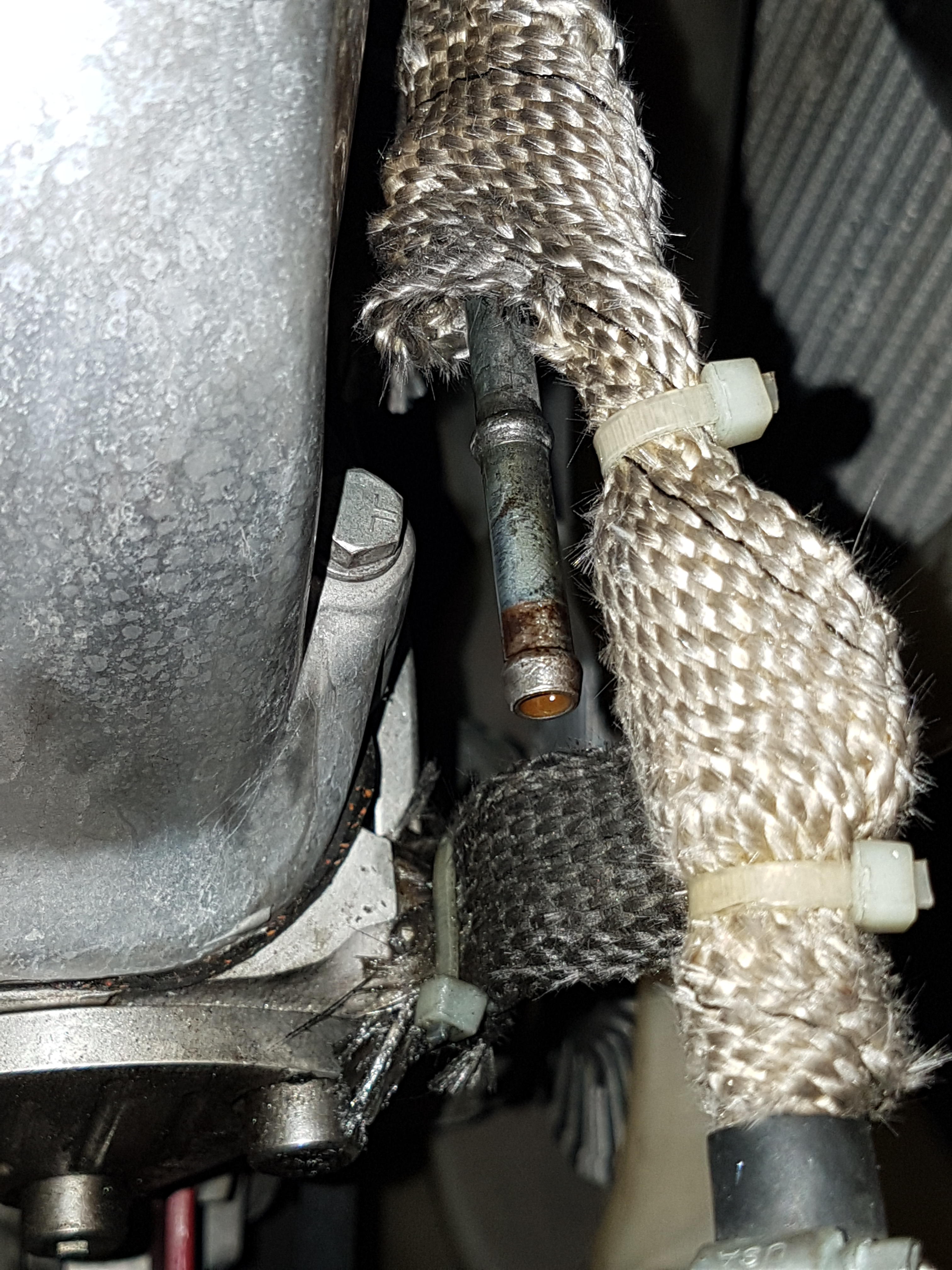

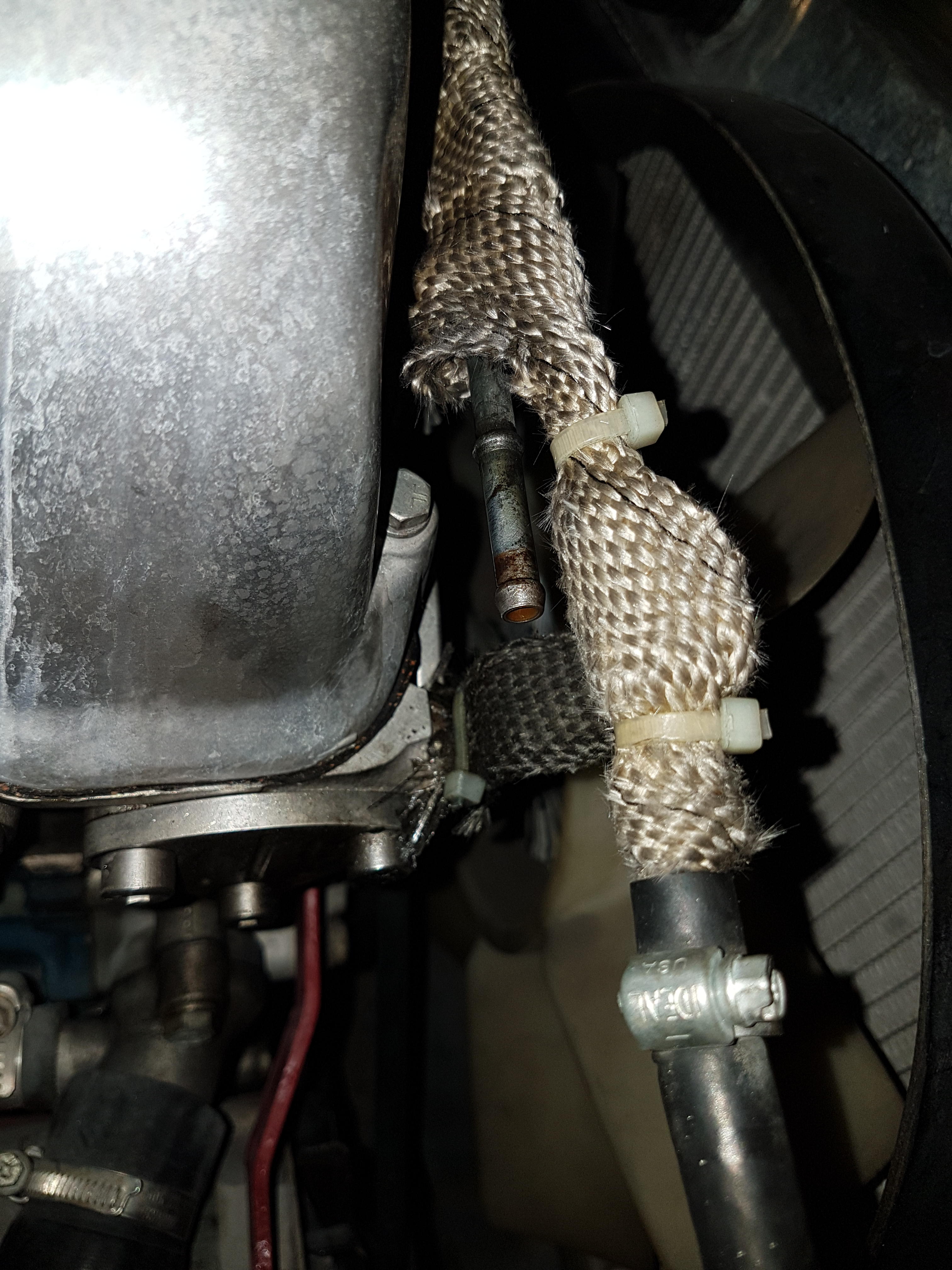

So which size are you using here for a snug fit?  This is the fuel rail  line that connects to the line that comes from the engine floor. I tried 5 /16 but need to clamp it down very tight.

1 hour ago, w3wilkes said:
If this is the return line from the fuel rail I used 3/16 as I stated in the prior post. The supply side (where the stock fuel filter is) is 5/16.
Its the sending supply side.
I used 5/16 on the line from the tank to the fuel rail. 3/16 on the return line from the fuel rail to the tank. What's the possibility that you have the lines on the fuel rail reversed?
Seems like if these were inadvertently reversed it would cause all kinds of engine run problems.
