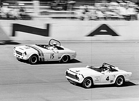

I read that Brock suffered car failures at the 1969 ARRC at Daytona due to fuel delivery.

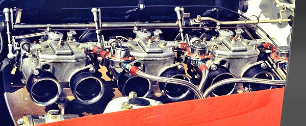

I noticed that in 1970 he seemed to dead head fuel to each weber with an individual fpr near each carb.
Dan Parkinson (15) & Brian Fuerstenau (4)
Is the high bank issue related to the fuel pump having to work harder to pull/push fuel up to the engine under the extra G forces caused by the turn (causing a lean feed to all carbs)?
Is the float also part of the issue where it, the needle, and the fuel would both be pulled towards the bottom of the bowl and thus causing a higher fuel level?
Or would it simply be the fact the cars would run  WOT on the straights and continue at or near WOT in the turns thus demanding more fuel for a longer period of WOT time and possibly emptying the fuel bowls by consuming more than the stock design could supply?
