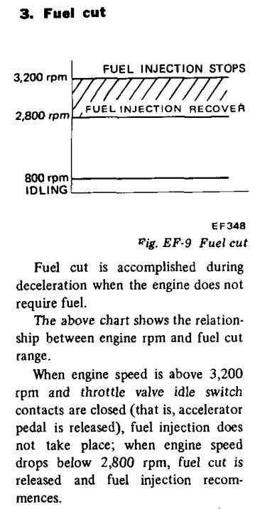

The "relaxation" that you feel is the fuel coming back on at 2800 RPM.  All the car reviewers hated it.

agree with the throttle cut is prob what I am experiencing (seems to be the RPM ranges I am feeling the effect in). I am pretty sure the BCDD is doing nothing at this time, but at least its stuck in the no bypass mode.
