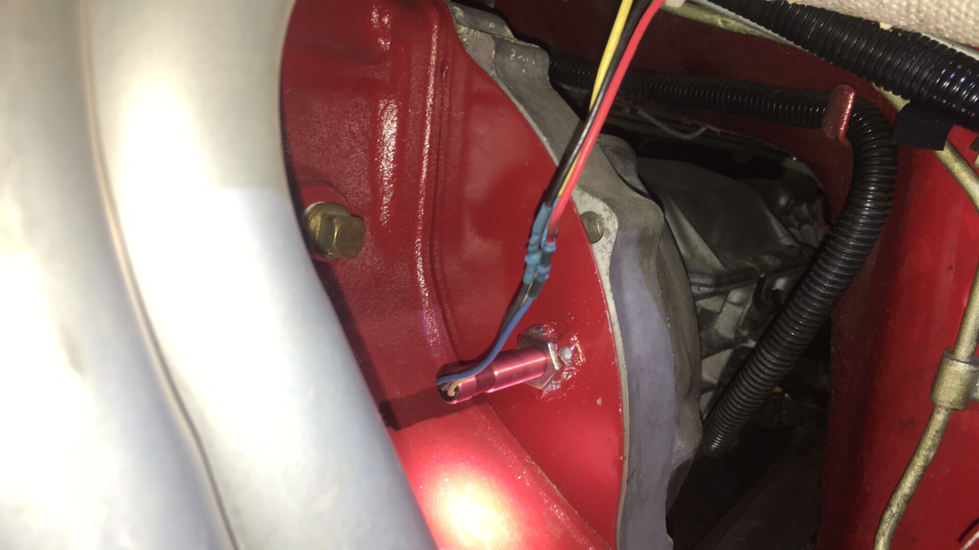

December 16, 20168 yr comment_508232 That's why I also opted for using my flywheel for the trigger- less stuffSent from my iPhone using Classic Zcar Club mobile Link to comment https://www.classiczcars.com/forums/topic/56686-just-another-damned-project-thread/?&page=3#findComment-508232 Share on other sites More sharing options...
