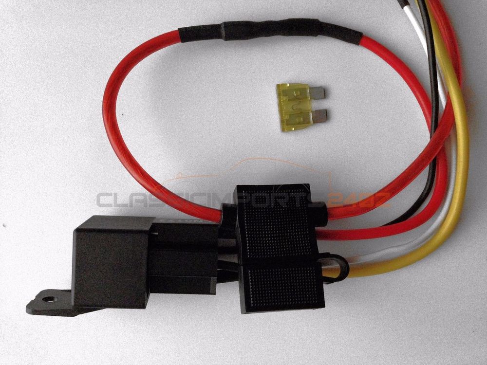

Had the same problem with our 260Z.  Turned the ignition click, click (as many as 5-10 times) and then it would fire up.
Assumed that it was the starter itself which looked to be the original to the vehicle so swapped that out.  Certainly an improvement, but clicking never fully went away.
A little reading suggested that the solenoid wasnt getting enough juice which lead me to a relay fix which touch wood, is working great.
http://www.ebay.com/itm/162167687783
Edited by Dublin Z
Added video
