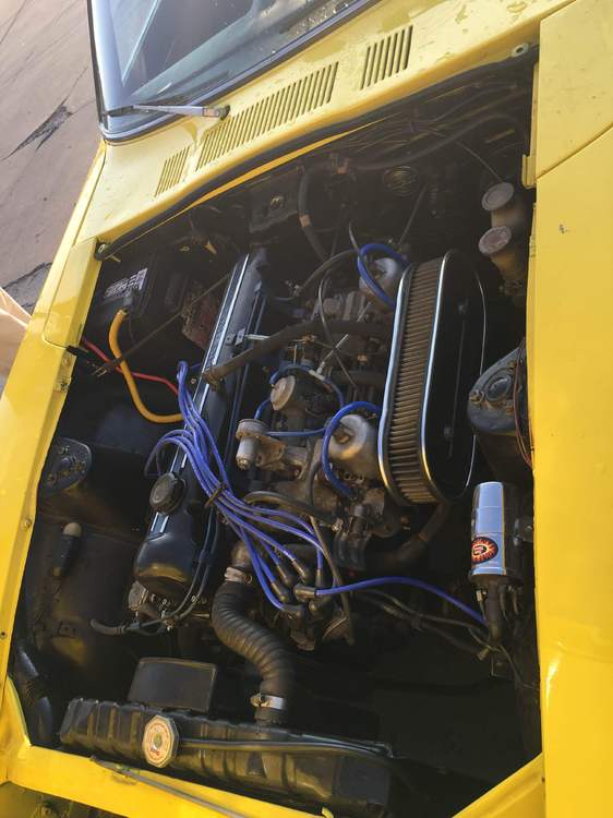

Literally just bought a 1972 240z with an l24, 4 speed, r200 diff swap, dual su carbs, MSA stage 2 cams and springs, and E31 high compression head, and adjustable dump valve for decibel levels. The previous owner said that the car is just barely making too much power for the stock clutch in the car. I had to drive it home from Kansas City to where I live back in Arkansas, I immedately felt the clutch start to slip once I got about 250 miles down the road, it was either on it's way out, I burned it out (doubt is the case after owning a z33 for 6 years with stage 2 JWT clutch), or it has too much power like he had said (taken with a grain of salt). What are the chances that this is the case, and if so, what clutch should I get that would safely grab any power I might be putting down? Additionally, I notice most of the slave/master cylinders are all original on the car. Car has 88k original miles on it, what brand cylinders should I get? Any input would be appreciated as this this my first 240z. Cheers.
