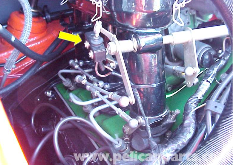

Got this picture from Patcon's link.  Porsche 911.
If I'm reading the numbers correctly, the hose in the picture is Cohline type 2122, and the catalog page can be found here:
http://www.newcoproducts.com/cohline/catalog_page19.htm
And on the catalog page, it says it conforms to DIN 73379 type B.
If your still interested, research that standard online and see if it fits the application?
Maaann, I saved that picture and blew it up but didn't know what I was looking at.  Good eye.
I still see some flags but I've reached my negativity quota for the day.
