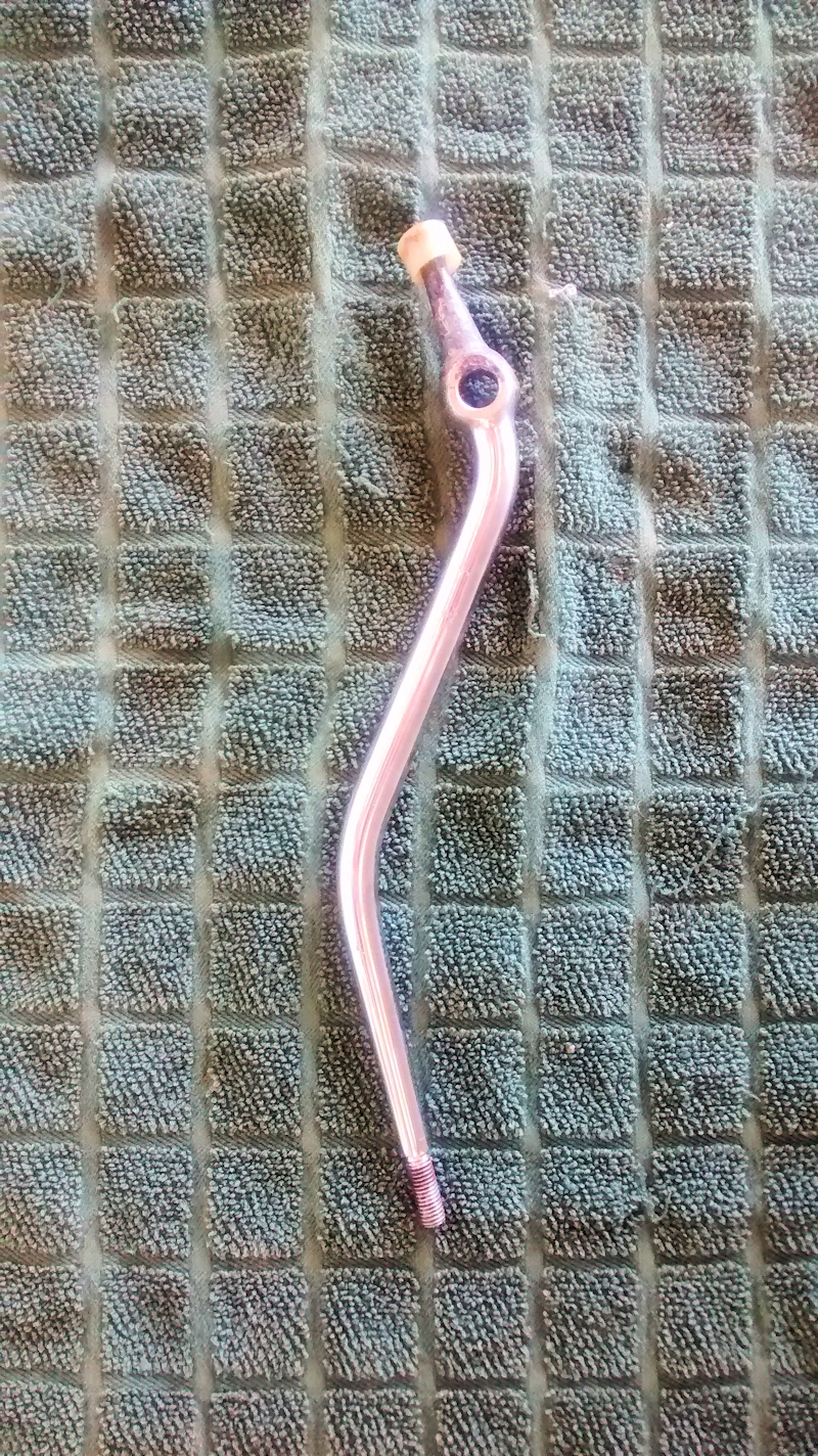

I have a 5/71 240 that had "series 1" style center console fitment issues because the shift lever kept touching the front of the console.  I found later that  the transmission was replaced with the later Type B transmission.

Do you have this type of shift rod?  Check out Carl Beck's site (http://www.zhome.com/) for a good discussion on the differences in the two transmissions.  Find the Index of Technical Articles on the left side menu, then Swapping The Transmissions in a 240Z article on the right side.
Yes absolutely.  The problem is now that I know I have the later B transmission, I am not sure what year car it came from.  Since there were so many later model transmissions, if I need a new clutch for example, I suspect I will need to be able to identify which year the donor car was.
