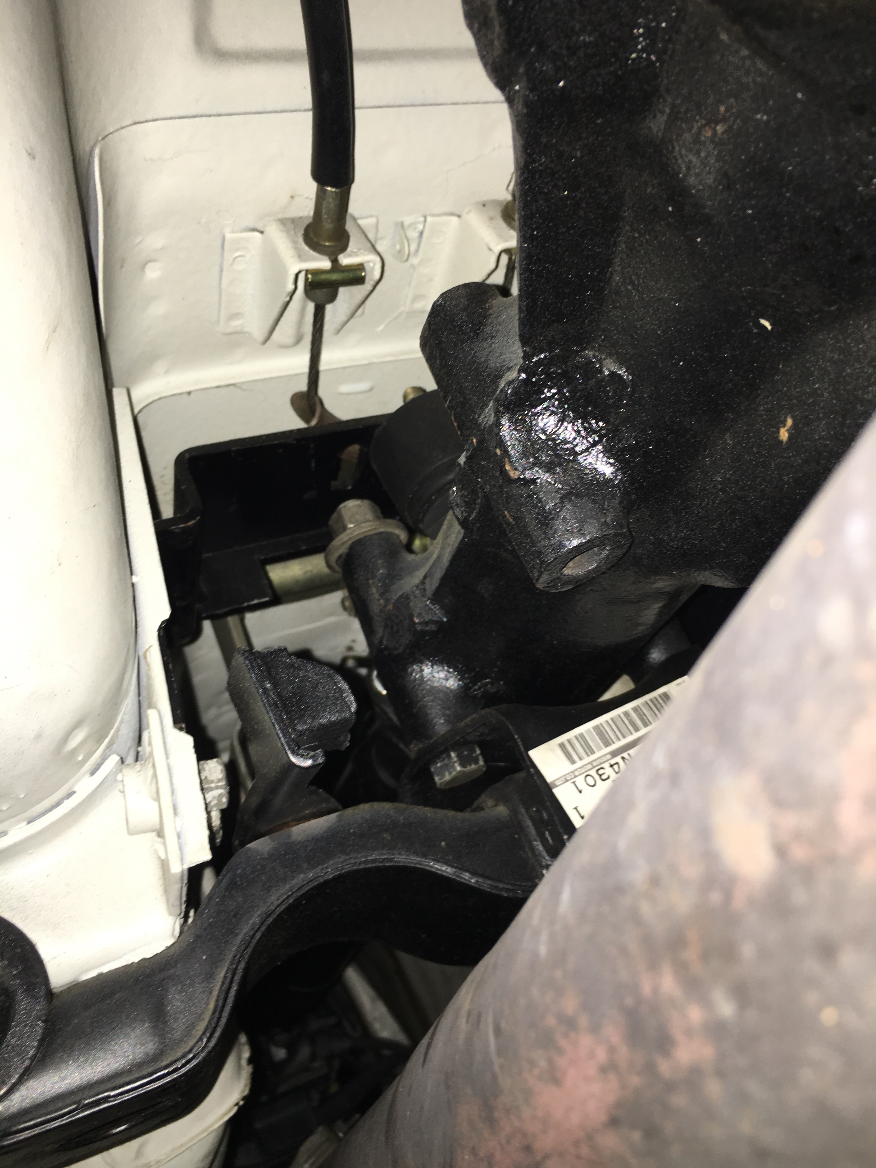

Yes sir. Below is a picture of what I actually have and you can see where I did cut the stud off flush with the bolt ... but the two systems still interfere with each other. The bottom of the parking brake assembly equalizer is maybe 1/8" above the top surface of the mount ... so even a thin washer and nut wouldn't solve the problem. Now that we know it isn't just me and my car (i.e., operator error), I'm going to shoot some pictures of my actual setup and send them to Brian at TechnoVersions. He's being a real pro about helping me sort this out.

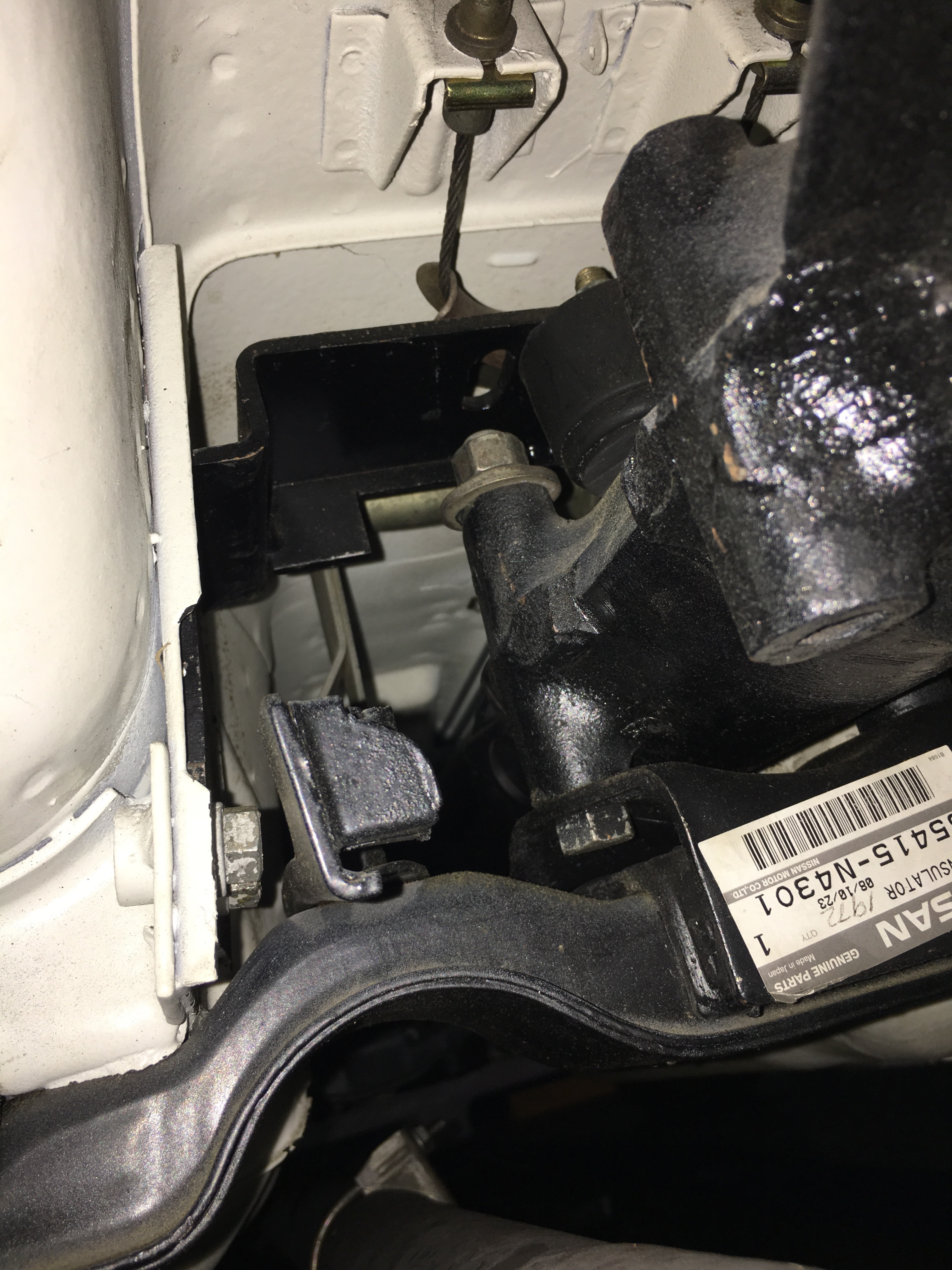

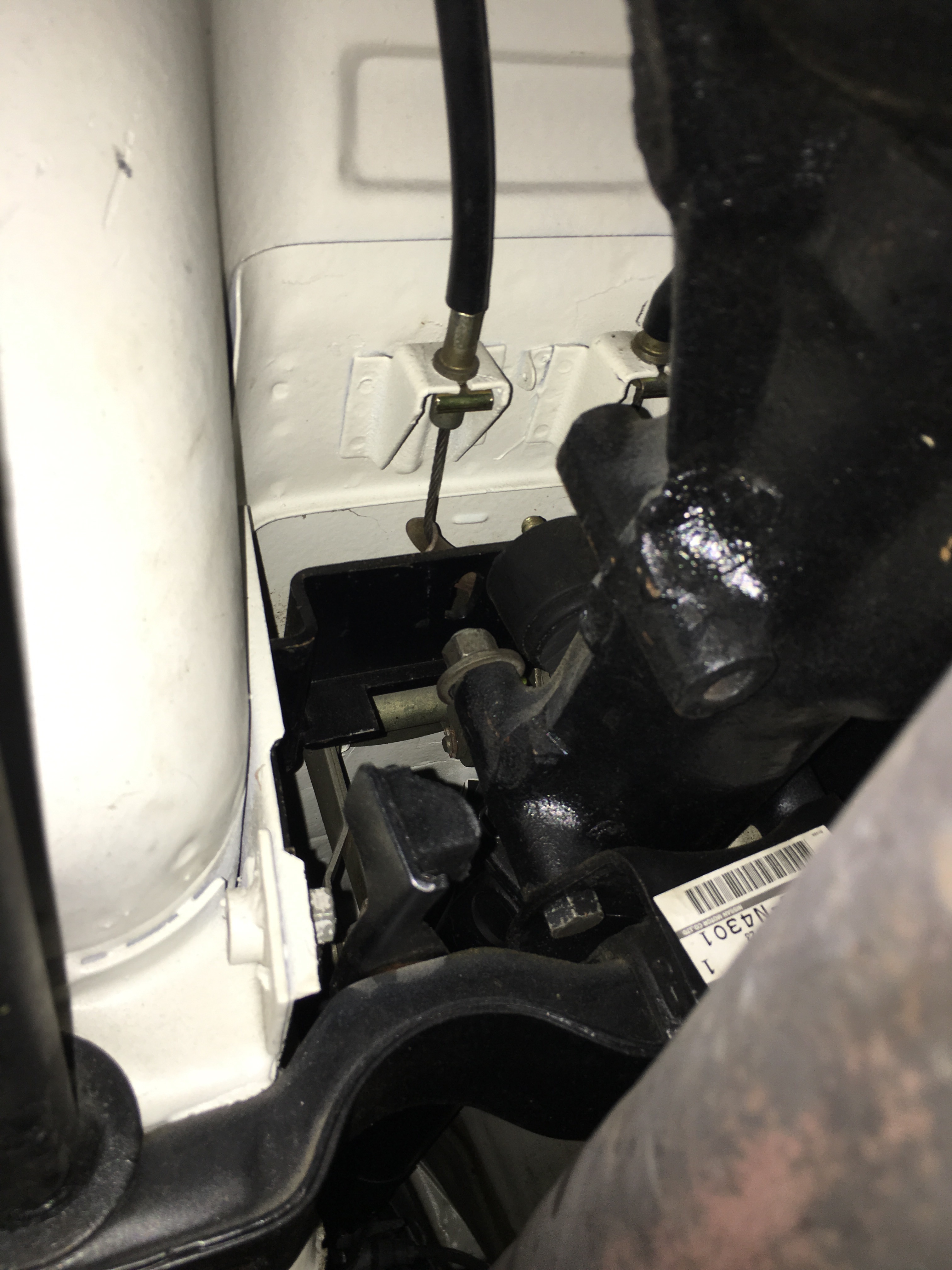

Is your Z an early Series 1 or transition Z? I had the same problem with my 70 Z. Seems the attachment points on the later model cars are farther back. My solution was I rotated the mount 180 degrees. Can't remember whether I had to drill another hole for the bump stop or not (don't think I did)..The notch for the brake lines will be on the wrong side, but there was no contact with the lines anyway. My Series 2 cars worked fine.....just the early cars.
Here's a couple shots (from the rear). If you look close, you can see the step (brake line step) is now on the left, but the bump stop (still centered over the diff) is back behind the bow of the e brake ....even when pulled. Works perfect, and as I said, no contact with brake lines even though the step is on the wrong side.
BTW, mine had a support bracket that I dremeled off so the drive shaft cleared, but it doesn't look like yours has that buttress. If you expand the pic and look close, you'll see that the part of thebump stop is hanging off the mount. Works perfect. Good luck!
Diseazd, I think that you must have drilled a new hole.  That's why the stop hangs off the edge of  the mount.  Since it's a snubber, it doesn't matter much where it hits the diff.  Easy good idea.
Yeah Zed probably did......if you look close, you'll see that I also cut a notch out of the forward support bracket. If Tomcat's mount has that bracket hanging down like mine, he'll have to notch it for driveshaft  clearance (easy to do). Just wondering now.....if you trimmed a notch in the support bracket wide enough to hang the bump stop off of the back of the bracket, maybe you could drill a hole on the back of the bracket as it stands to hang the bump stop off the back slightly......that might work without flipping it 180 degrees. Just a thought. BTW.....It's a great system.....you'll love it!
