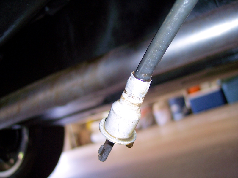

A few weeks ago I swapped out the transmission fluid for the magic elixir ACDelco Friction Modified stuff.  And it seems the transmission is shifting more smoothly.  I guess that stuff is really slippery as I've now developed a fluid leak at the speedometer cable right where the black housing is fitted into the pressed collar.  I guess a new speedometer cable is called for, right?  Is it normal for this connection to have transmission fluid present or is there some other seal I should also be replacing?
Thanks,
Jim
