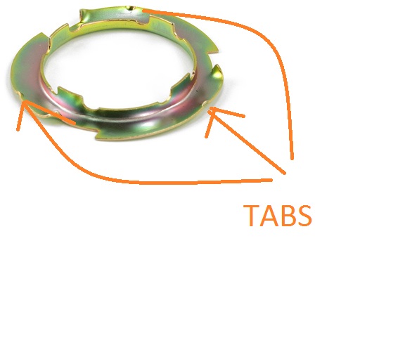

Is there a special tool for these lock rings?  I used the screwdriver/hammer method.  There is a small tab on the locking ring that I cannot tighten further.  (How far am I supposed to turn the locking ring?)  I cannot tighten the ring any further, it started bending the tabs.
Here are the tabs I cannot tighten further.  Is it supposed to tighten to the arrowed tabs, or all the way the the sharp "stoppers"?
I just used my hand to tighten most of the way, and then some water pump pliers set wide open to get on the tangs for the last few degrees. I stopped at the tabs indicated. the hardest part was keeping the gasket in place. I used a little dab of fuel resistant gasket sealer to make sure it did not get displaced. no leaks so far.

It has been a while but I think you need to turn it until the high points go past the ramps so it cannot back out. Use a lever and grab it by the tabs across the ring to turn it smoothly rather that using impact.
oh now that makes since, I better go tighten mine a touch more then.
I used a tire changing tool for dirt bikes, we always called them spoons, flat steel with the ends angled up for prying under the beads. Put one across the locking ring and turned it until it hit the notches pass the ramps.
Thanks for the replies, I'll try to tighten it a little further.   The electrical connectors seem to be in the way if I try to use the lever across the ring method, but I will try it.
My intuition told me what has been mentioned, that I should tighten it past the tabs, then the tabs keep it from backing out.
There is a youtube video of a guy fixing this leak on a 240z and he stopped at the tabs, so I thought I'd verify.
Thanks for the feedback

Past the ramps!
Can't edit from my phone, don't understand that.
Perhaps I am using the wrong terminology. The o-ring has to be held between the tank and the sender unit to seal. Either the lock ring or the tank has ramps (wedges) that the other half rides on to make the seal when you rotate the lock ring. As you tighten the ring those tabs (shown in Ramsesosirus's photo) go past the end of the ramps and fall into a depression which prevents the lock ring from rotating the other way.
