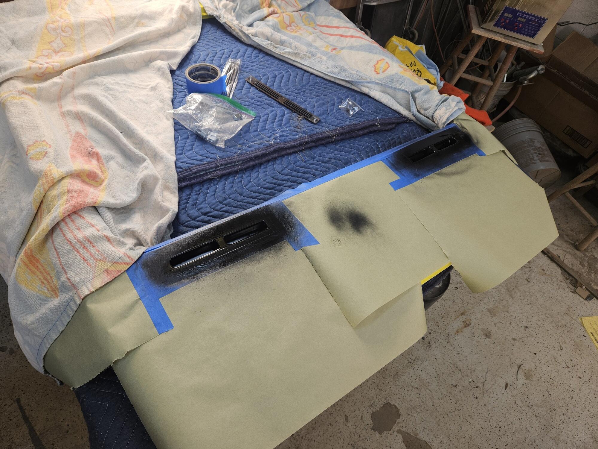

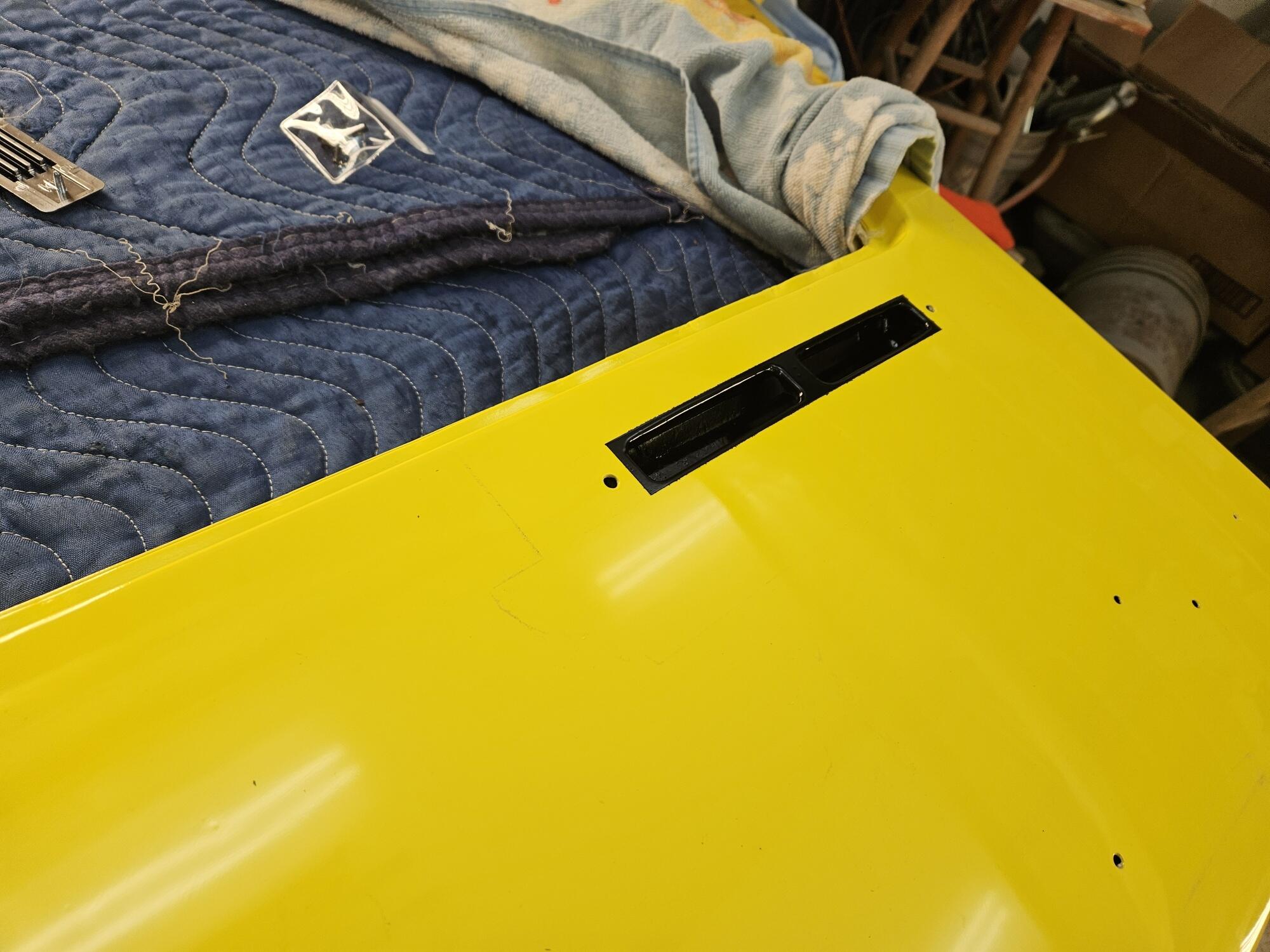

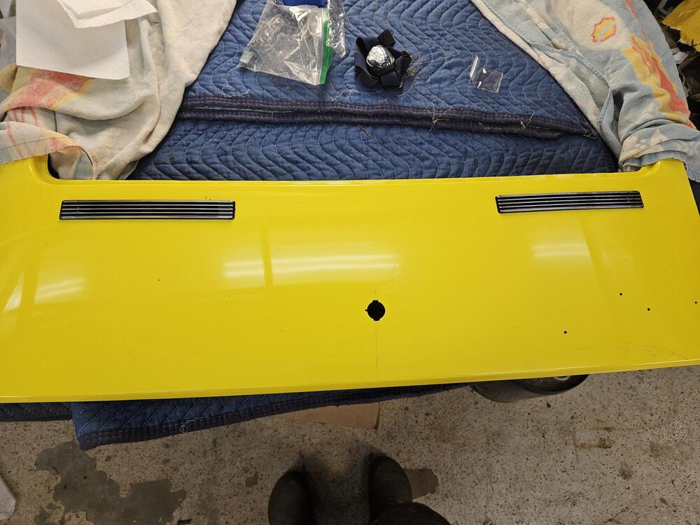

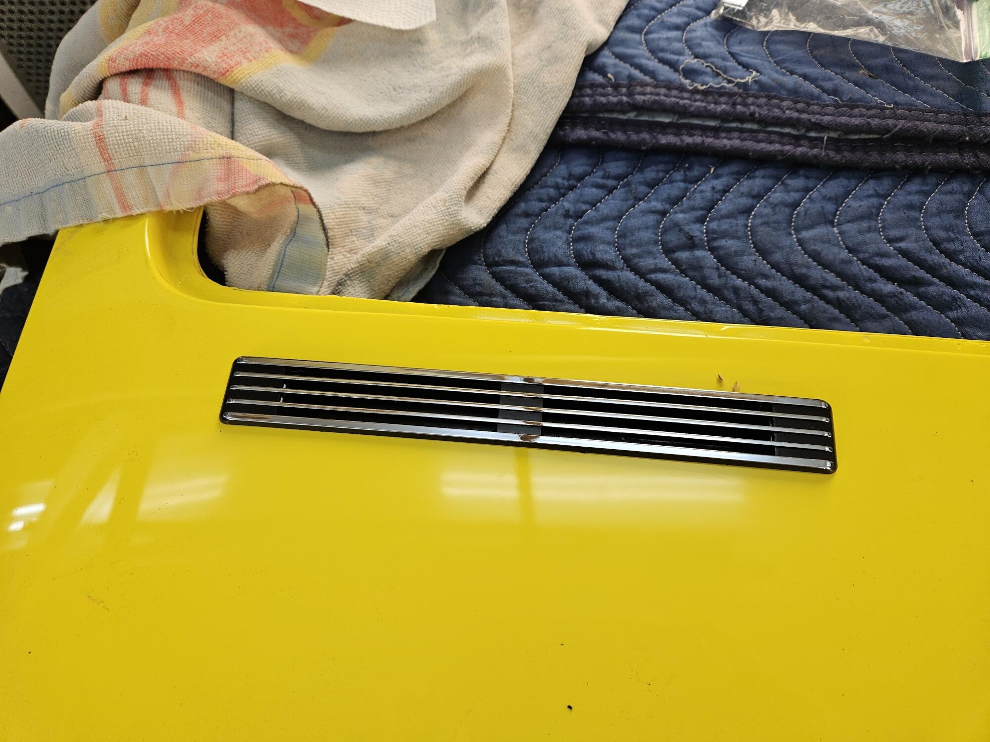

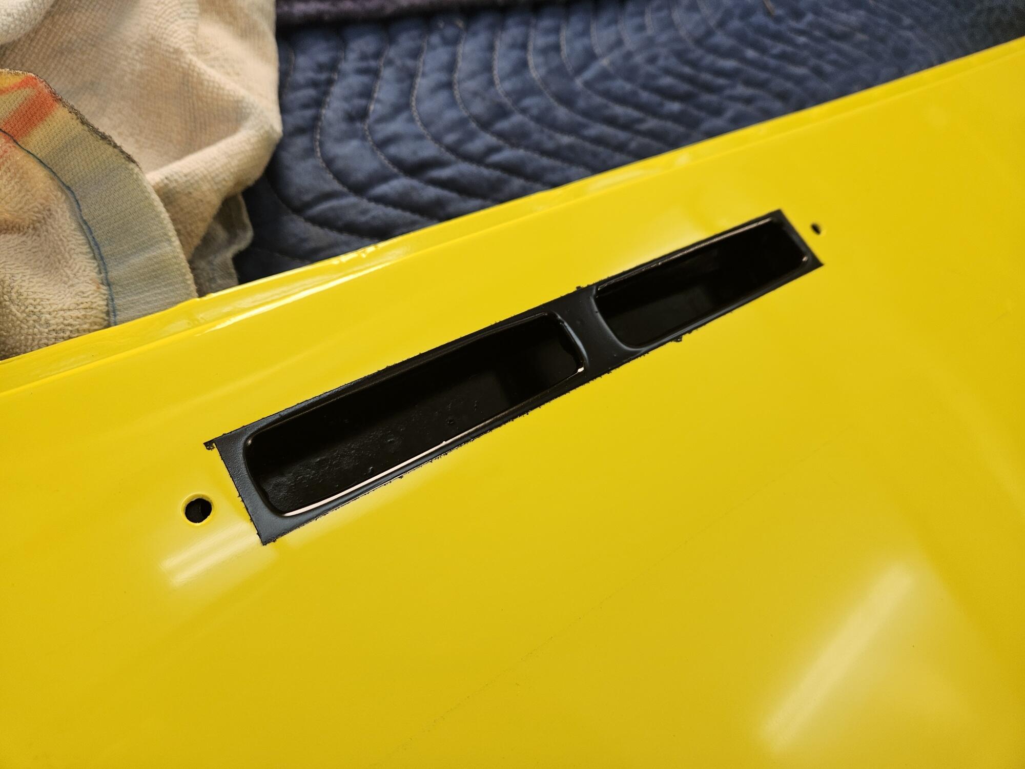

A little more tinkering

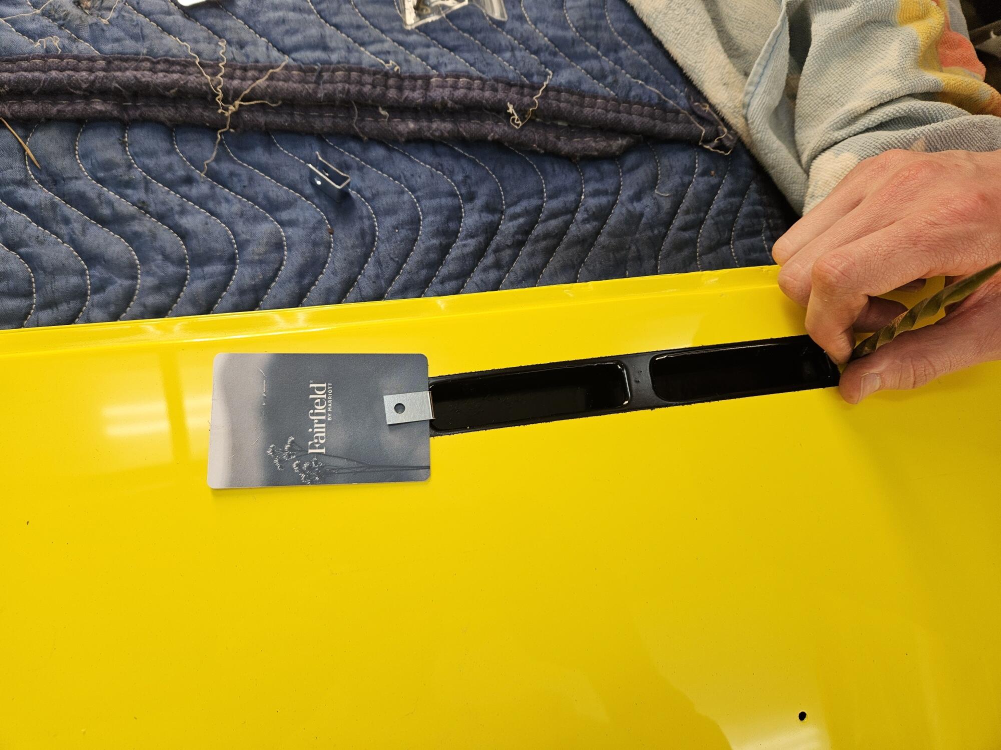

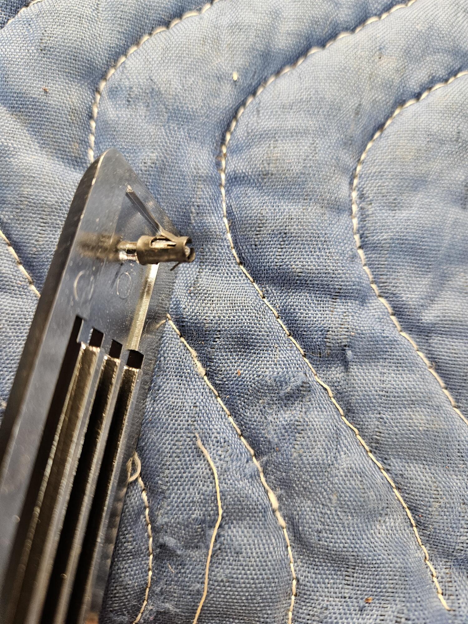

So I used an old hotel key to help get the clips on
Thanks @Namerow
It also helps to lift the scupper from the underside in order to get the clips on
Here are the pin clips that come with the badges from Resurrected Classics

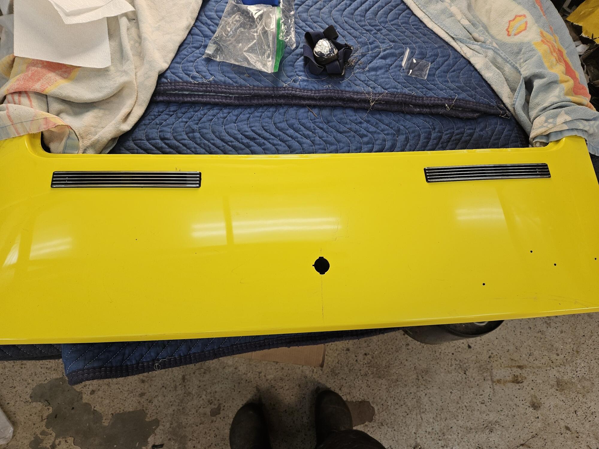

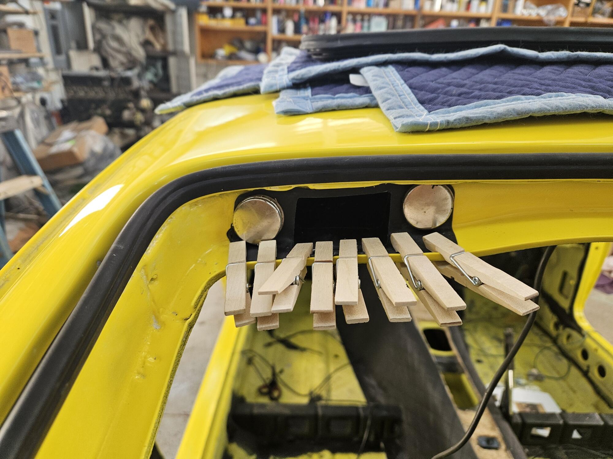

I applied a tiny bit of urethane sealant at each post too. Then I covered them with towels and added some weight overnight

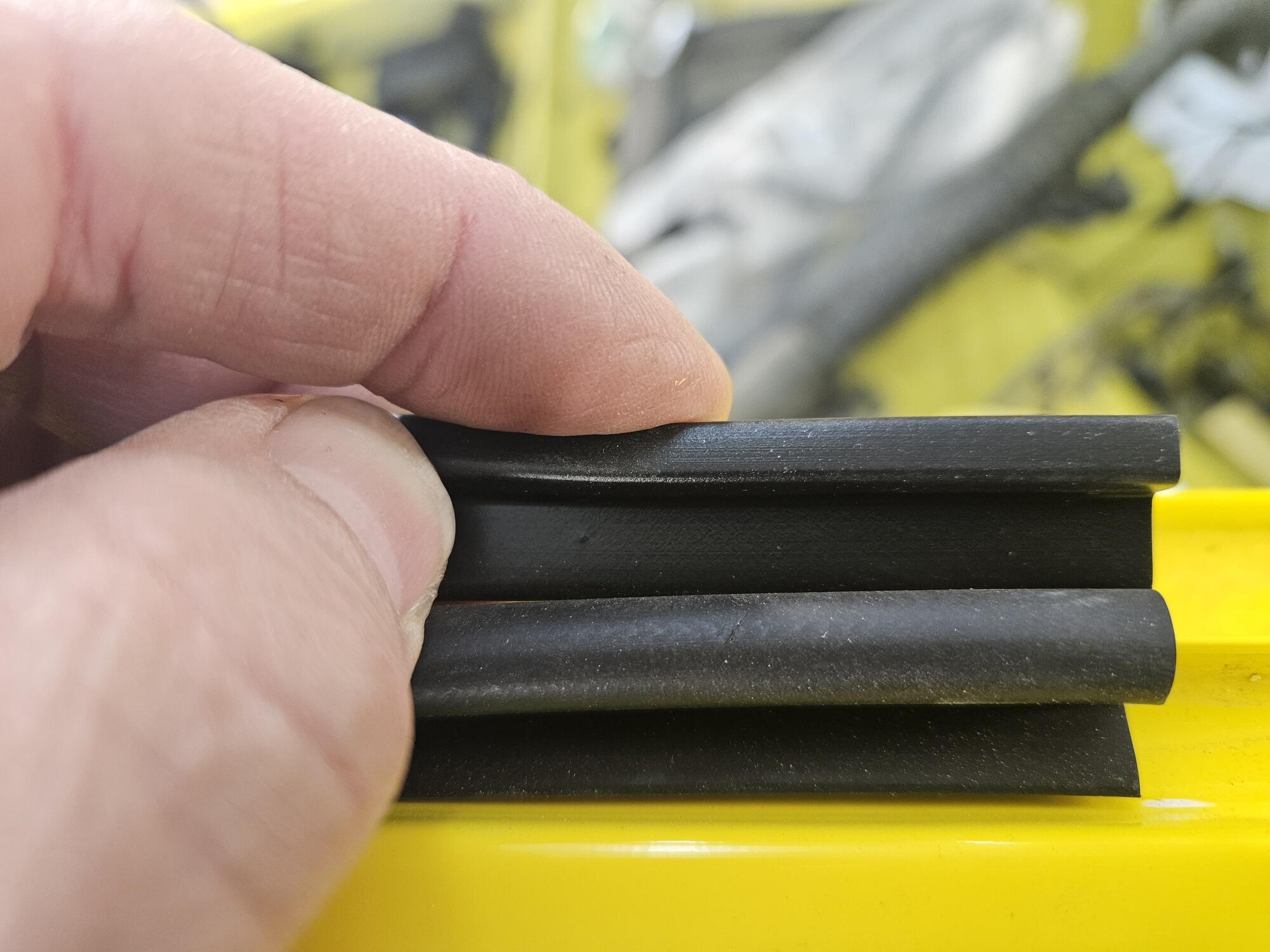

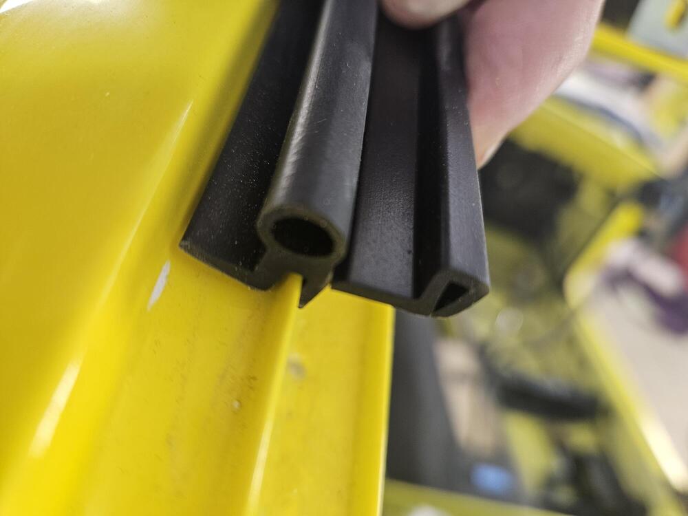

So here's a question, I have the upper outer hatch seal. It has a bulb on it. But the lower side seals are squarish. Is this correct?
On the outer hatch seal, that is the OE configuration. MSA also sells a modified vesion with a full bulb seal all around. I made my own version years ago before MSA offered one.

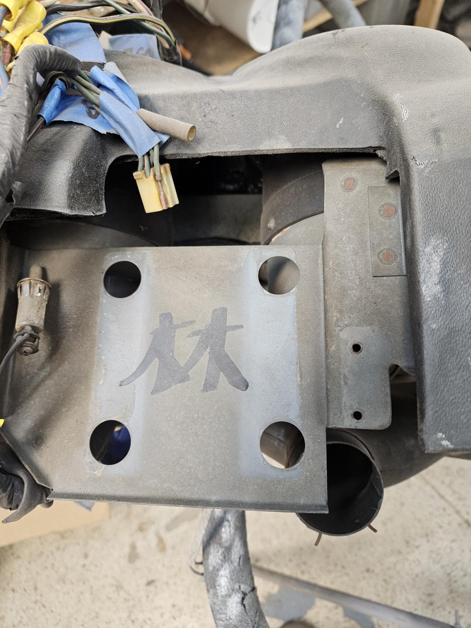

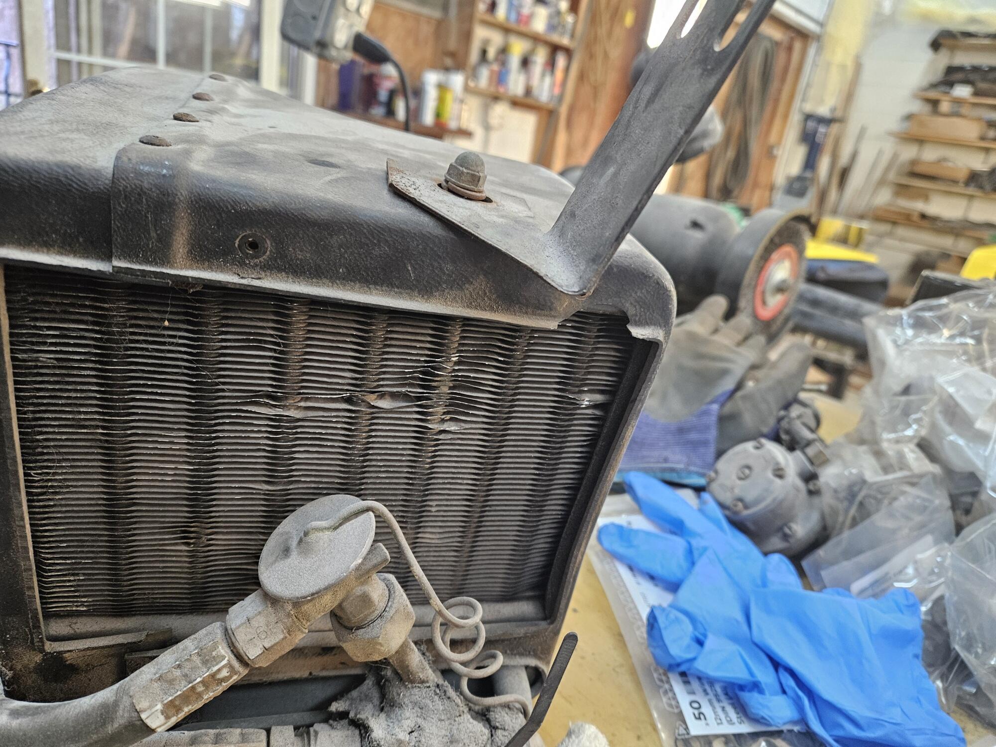

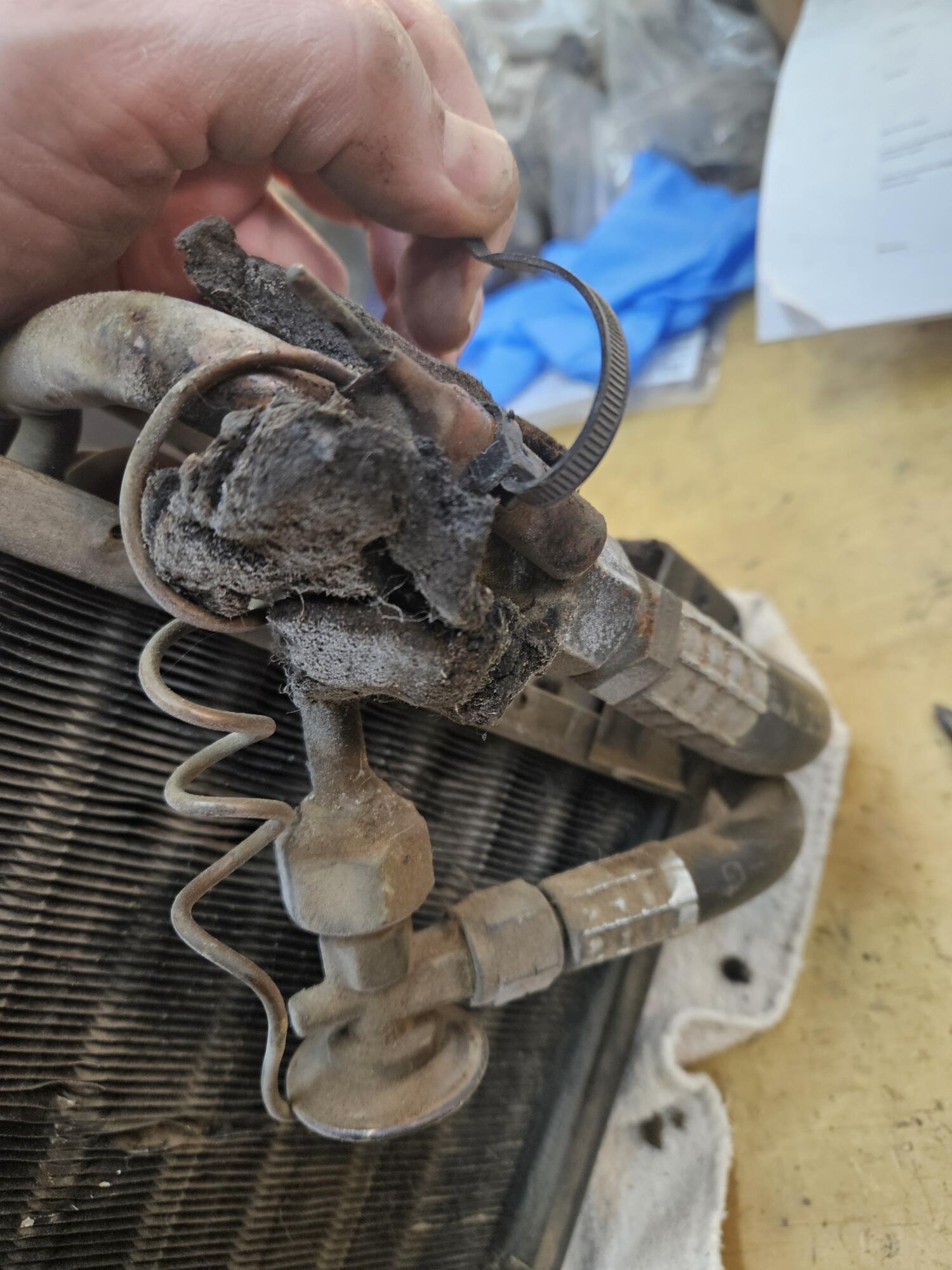

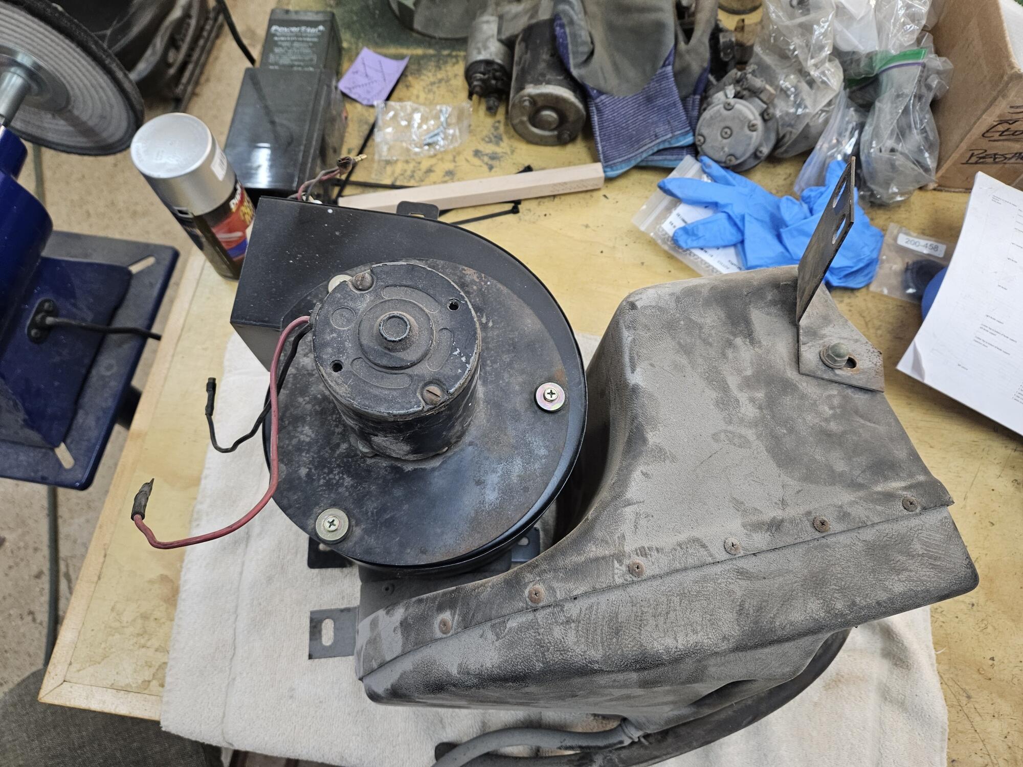

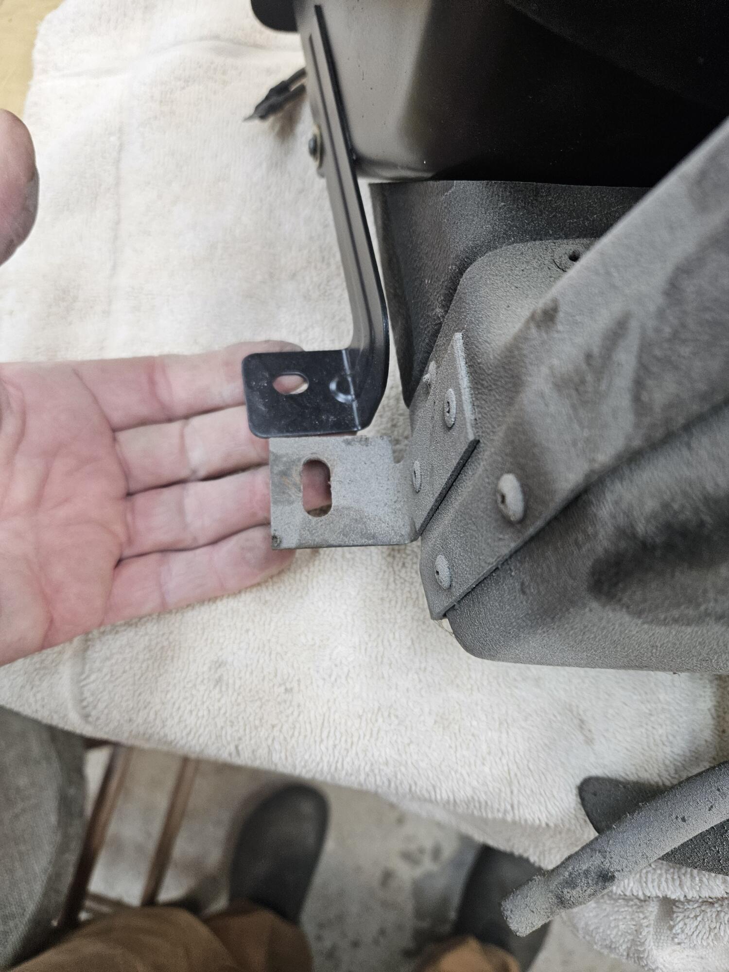

So best I can tell. The AC evaporator connects like this.
There must be a piece of metal here that helps connect these two to the factory mounting point

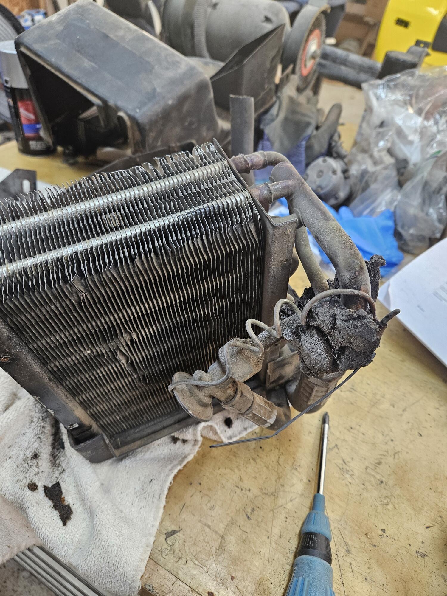

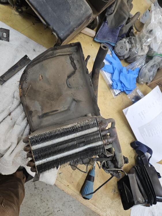

Here are some pics of the stock evaporator
BTW this thing is fragile as egg shells!
How exactly does this little valve work and will it work with 134a? I was thinking I would run a rotary pump under the hood and use the "stock" AC evaporator.
I'm not interested in going vintage air at this point
For your possible interest, someone - Eastwood, I think, sells a 'comb' for straightening out heat exchanger fins.

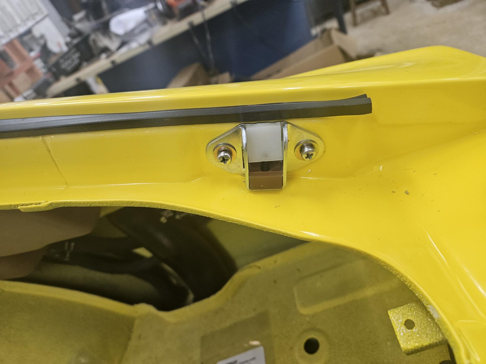

Can't work on the heater because I'm waiting on a valve. Can't install the fender because the weather strip I had for fender sealing panel is not thick enough. I also need to touch up the engine bay paint. Can't install the hatch because I am gluing the hatch boots in... on and on
So I piddled some
I did get the catch down stoppers in. They are available new from Nissan currently
I found the bolts for the hatch but two are the wrong finish. So I will need to redo them. I did glue the hinge boots in. I used a black latex caulk. I didn't want to use anything more tenacious in case I need to get them out

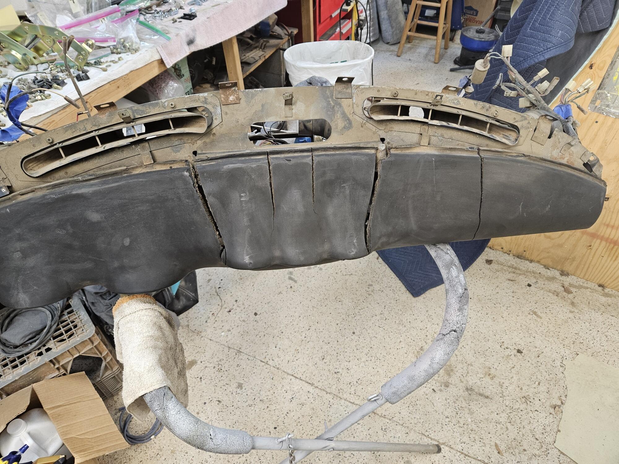

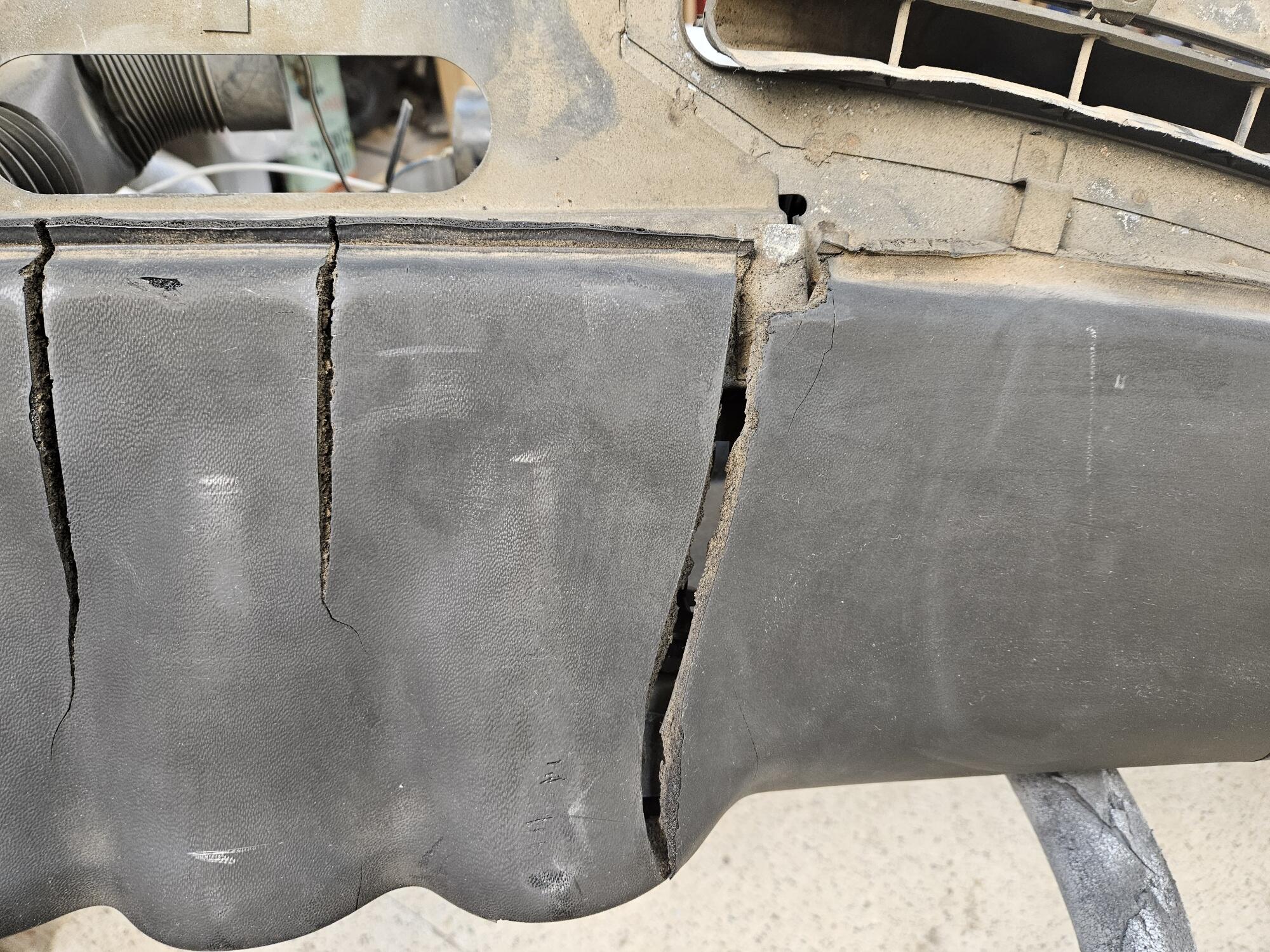

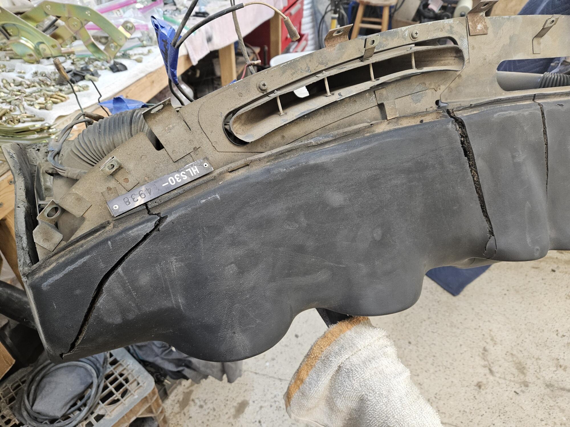

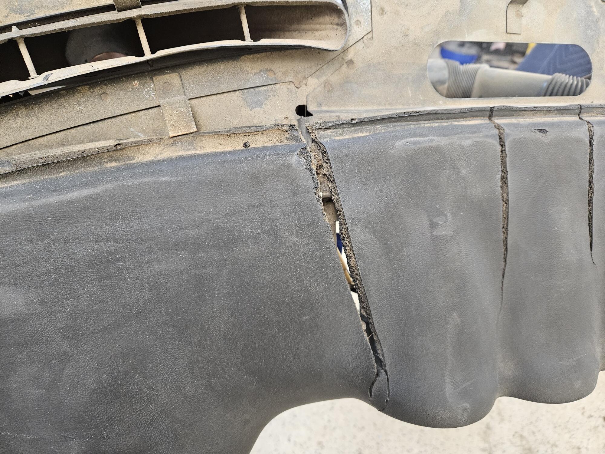

I pulled the dash out and was going to clean it up. Wow, is it rough!! I guess I will see about getting a new dash.
Where is the best place to source the reproduction dashes?
I had thought I would try repairing this one but I didn't realize it was totally broken through in a couple of places

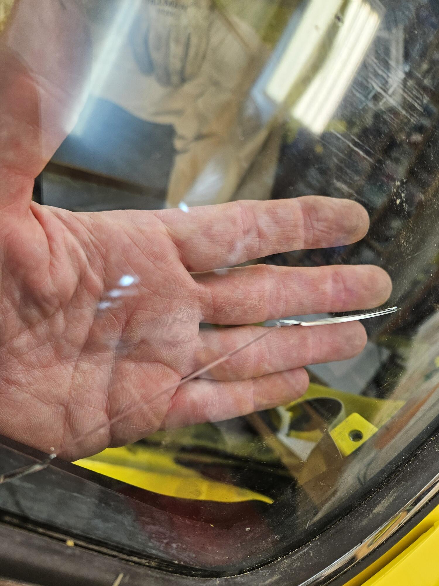

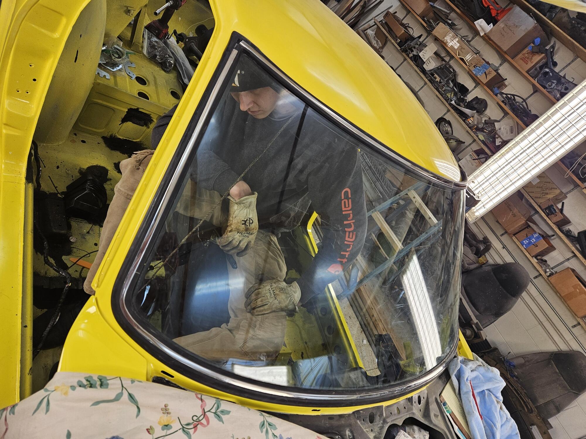

The real pisser of the day was the windshield!!! :angry:
We had it most of the way in, up around the passenger top corner and up to the other top corner and I pushed on the lower passenger corner to seat it and broke it...
Zcar depot has them but the freight quote was like $400+
I will call my local auto glass company and see if they can get one. I plan on seeing if they will install it too. We'll see what they say. Many times they won't guarantee they won't break it. I obviously can break them on my own... All in all, a wizz poor day in the shop!!
