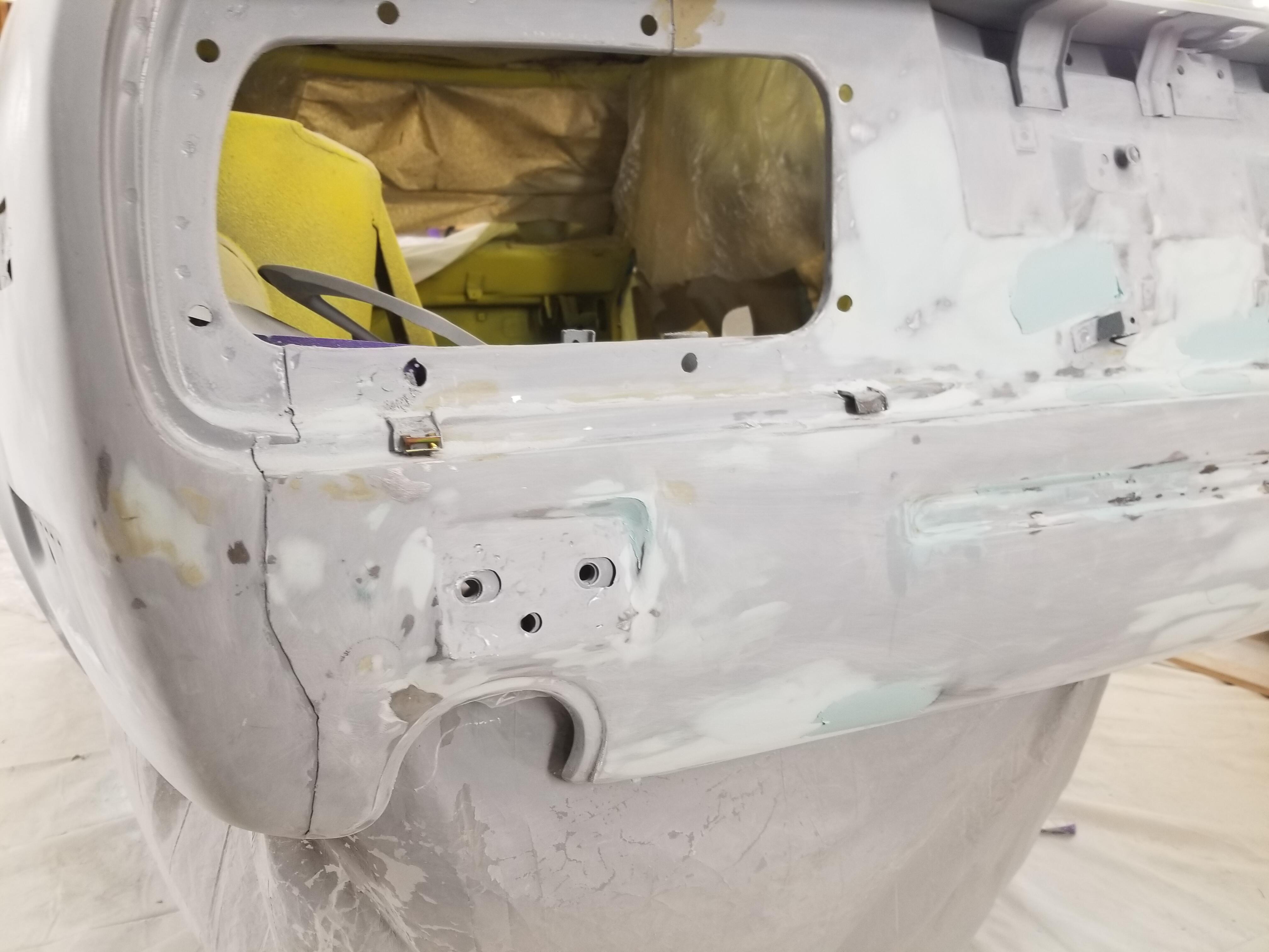

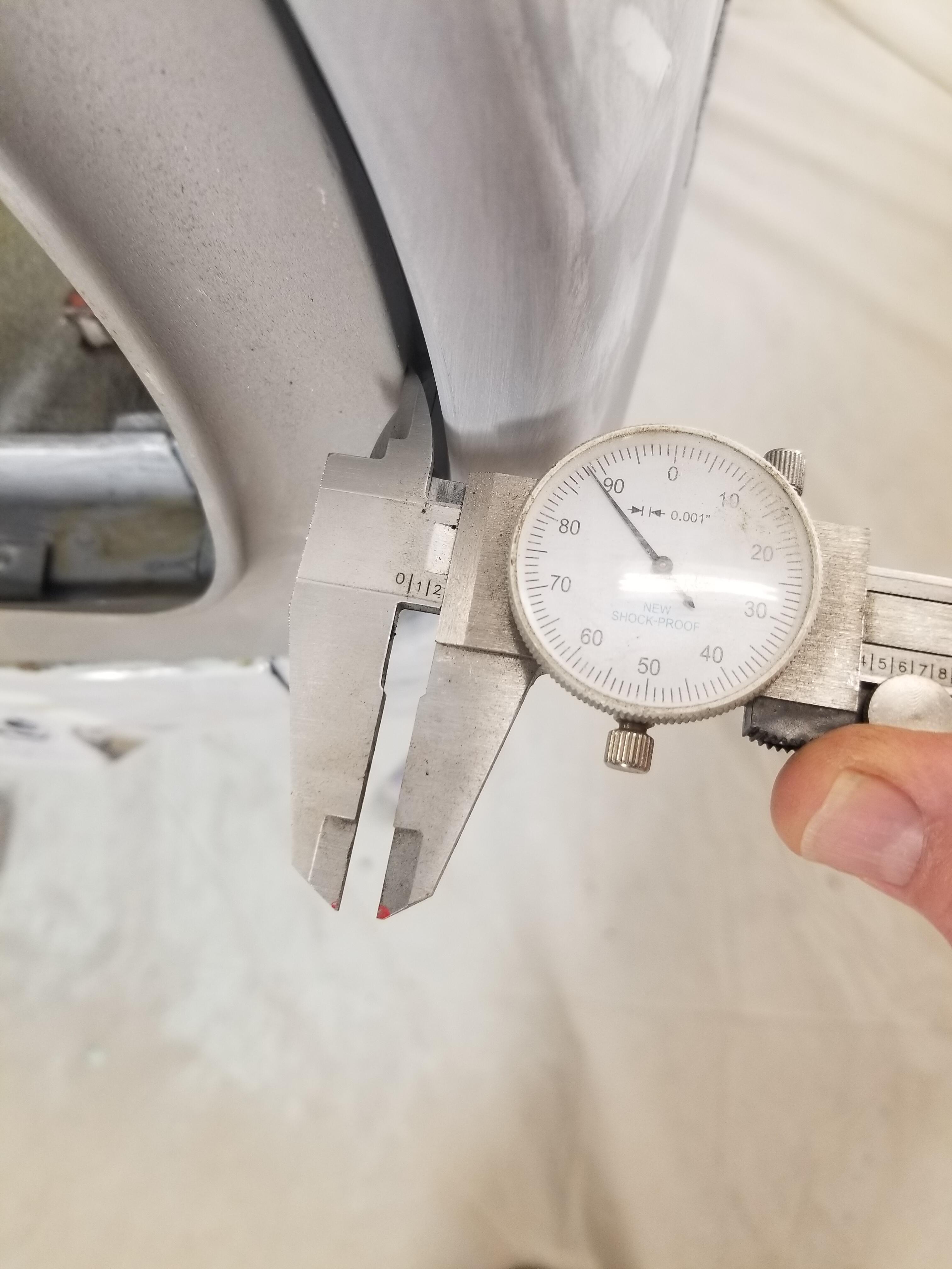

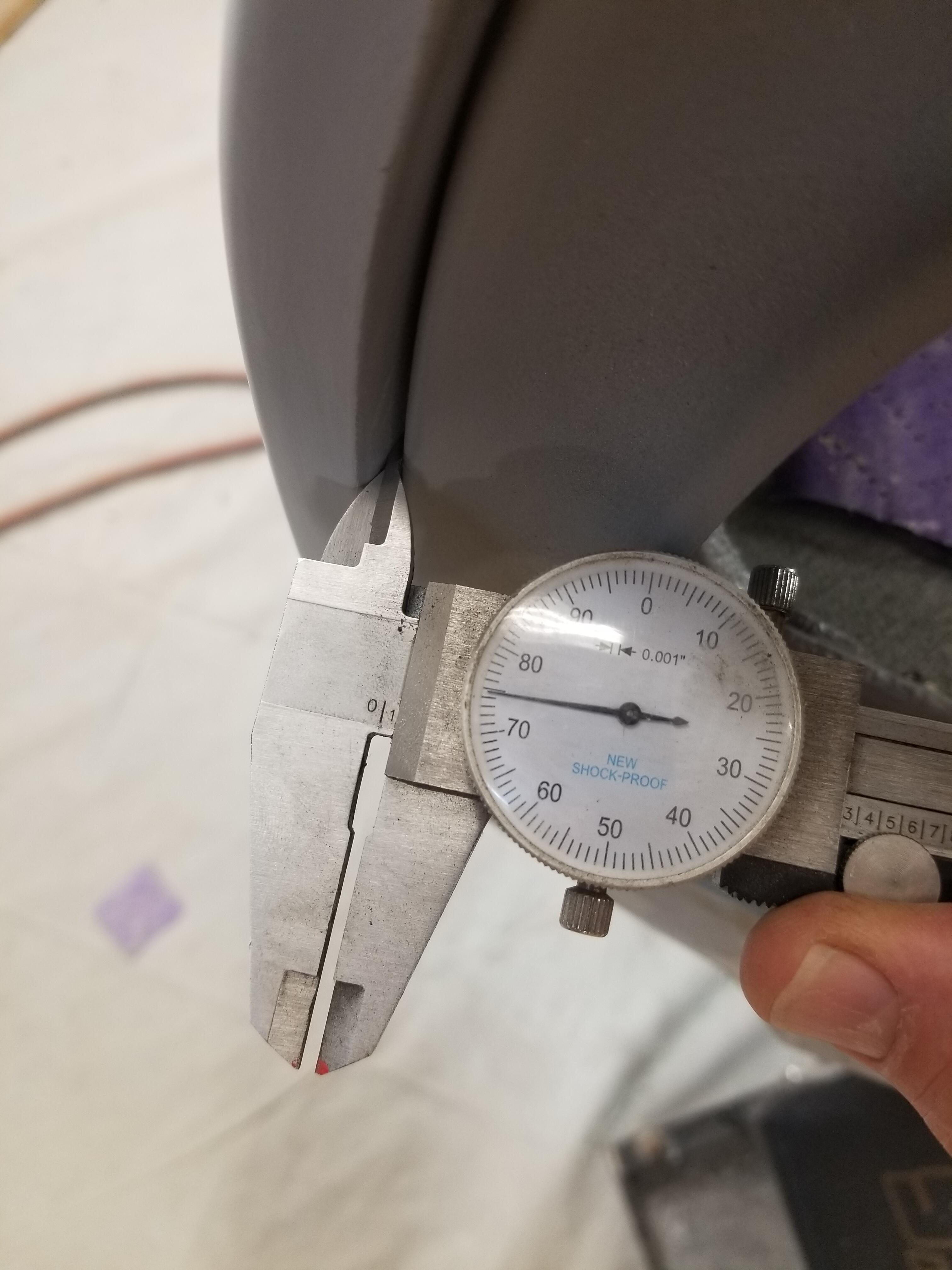

So I found an issue when test fitting the tail light finishers. The gaps on either end were different
About a tenth of an inch different. So what I did was oval out the holes in the top edge of the panels so they can all shift to the right.
After that, the gaps were identical.

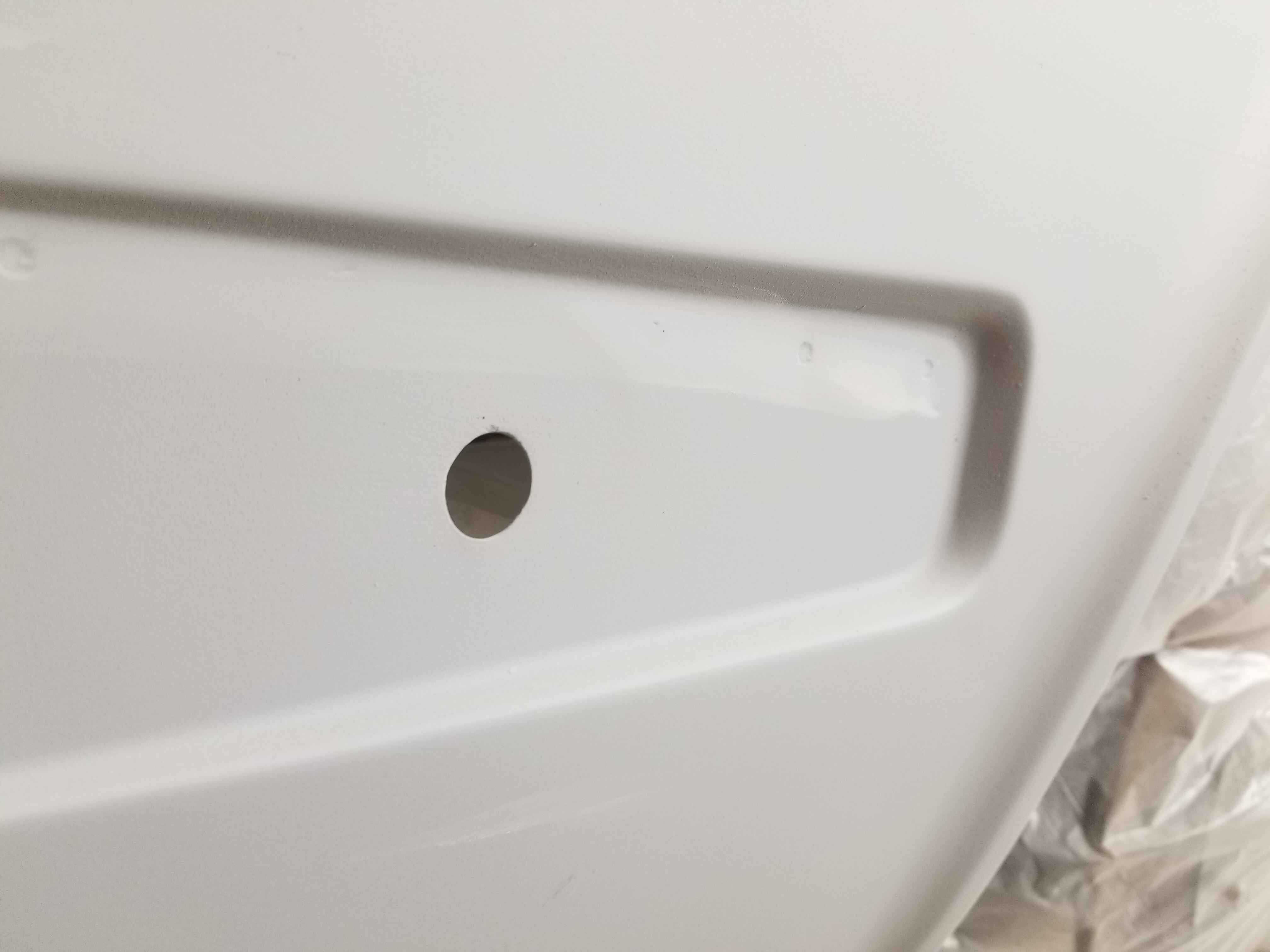

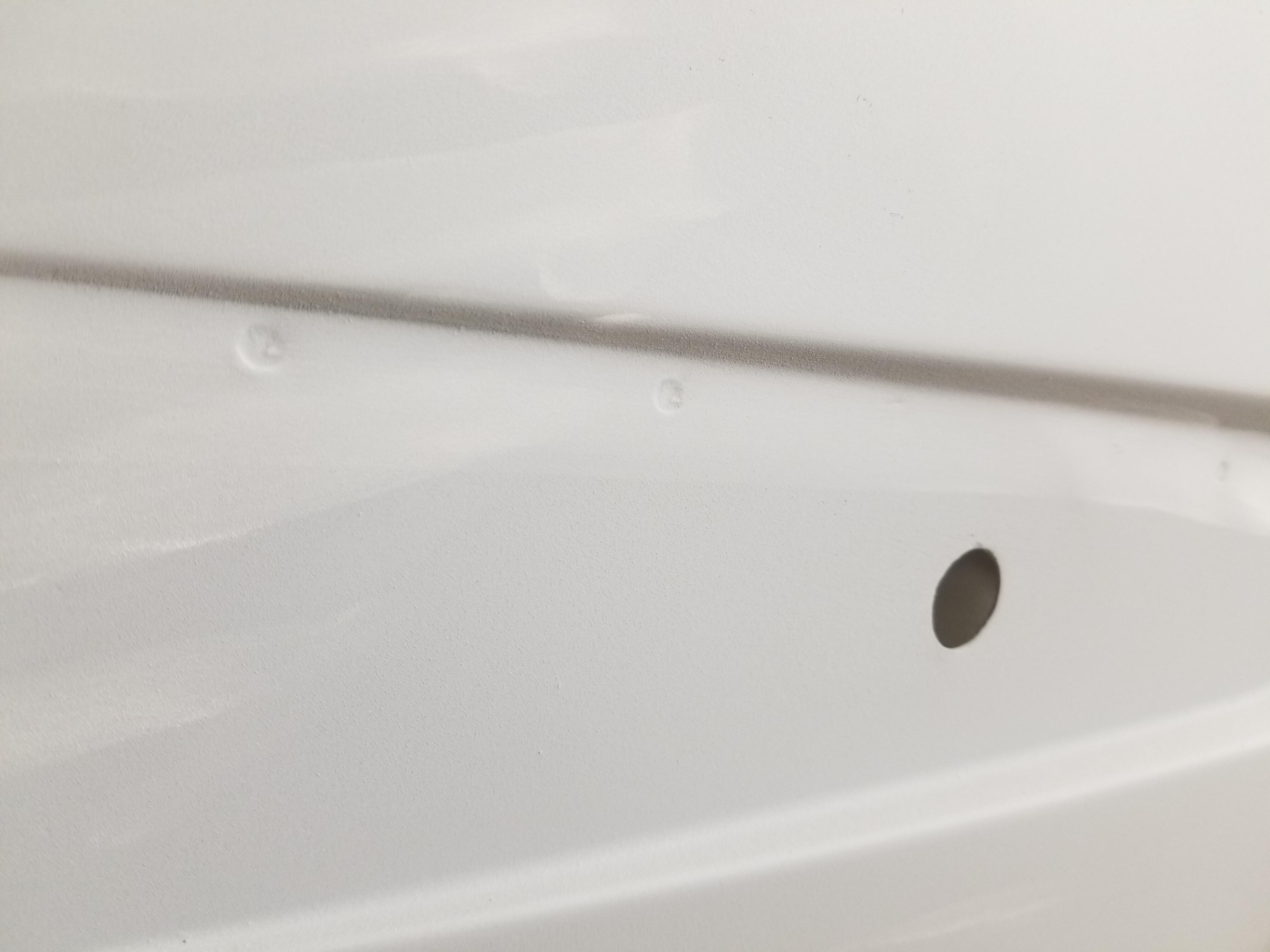

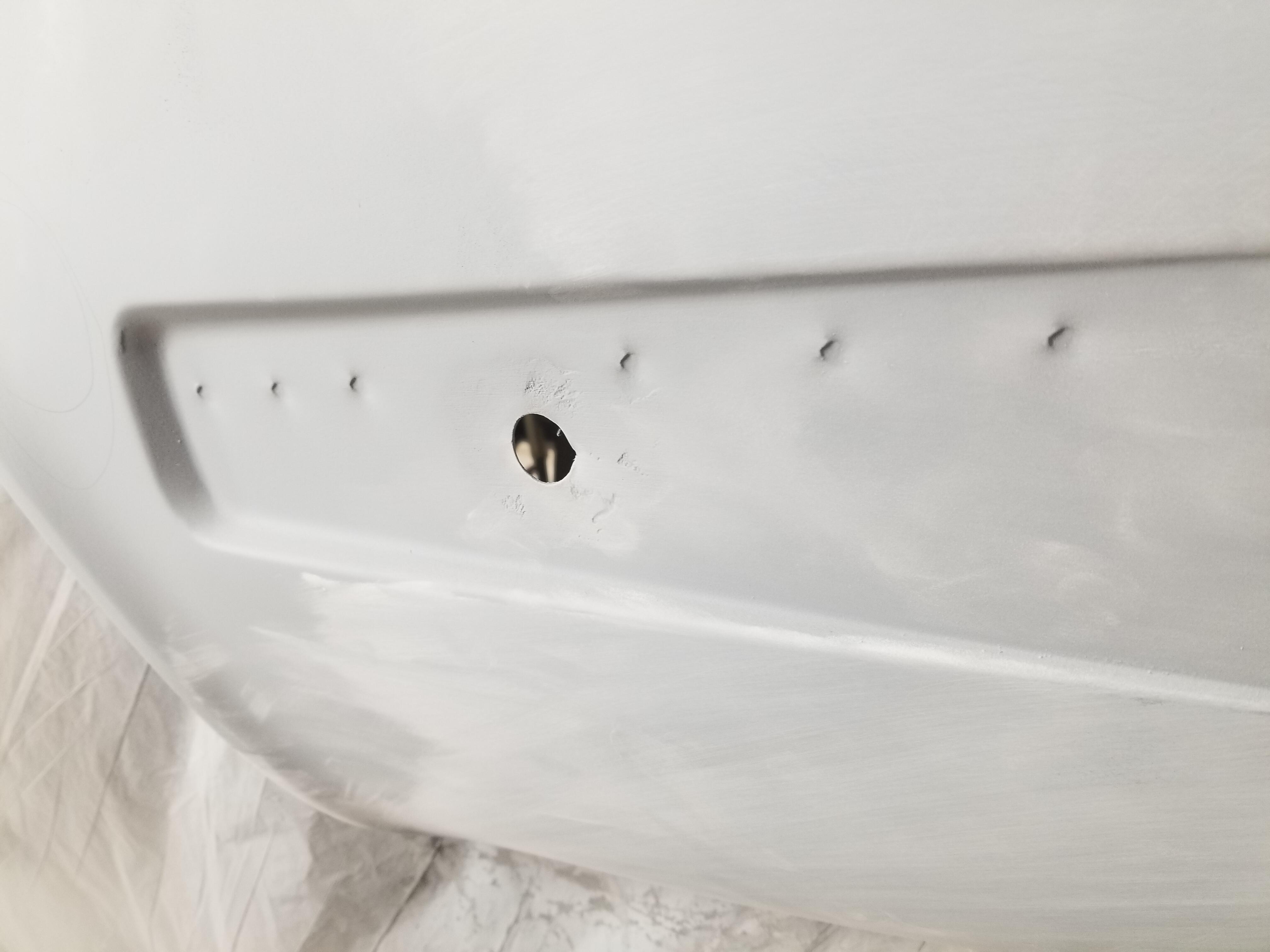

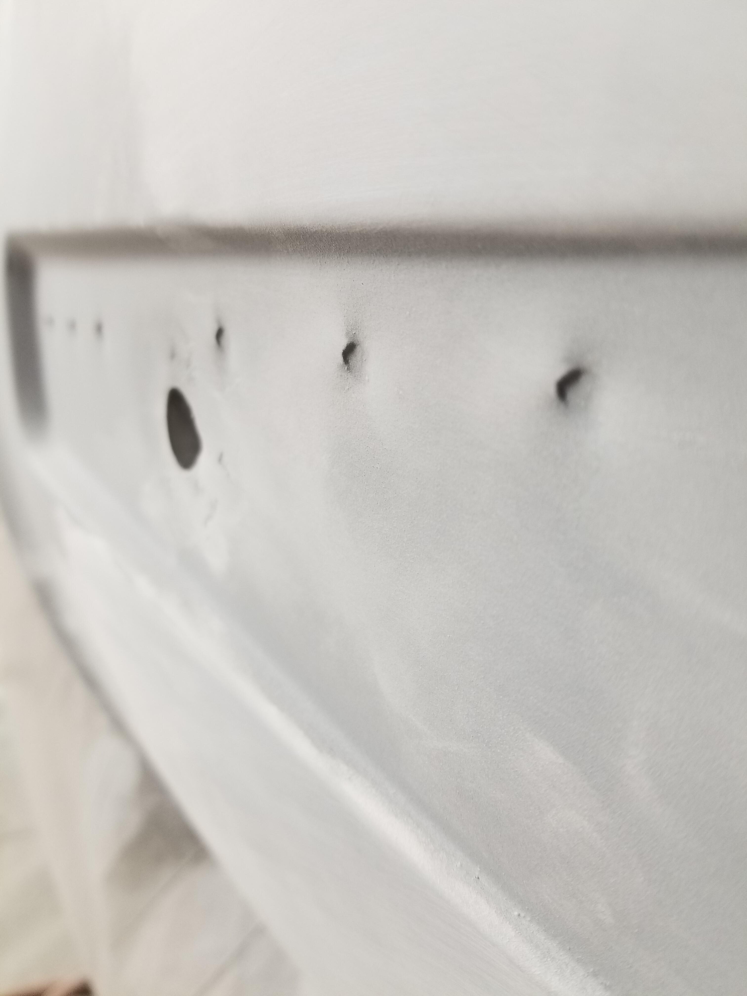

I also noticed something in the bumper indentions on either side.
The spot welds on the right side are nice and uniform
On the left side, not so much...
So I am assuming the ones on the left reflect the impact from a wreck on the rear of the car. The floor board shifted forward enough to pull all the spot welds forward and make them look pulled forward

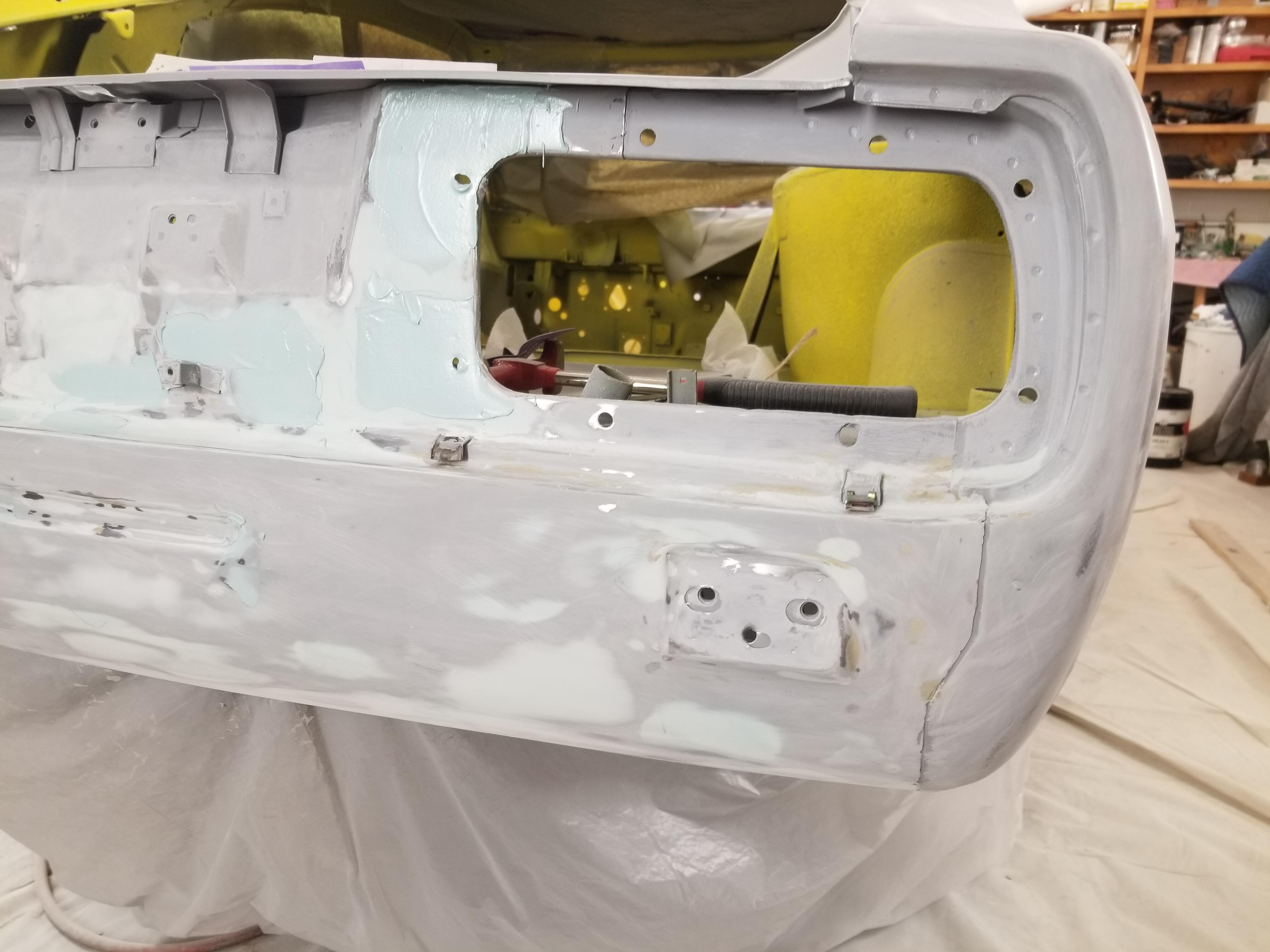

This was the current status at the end of the weekend

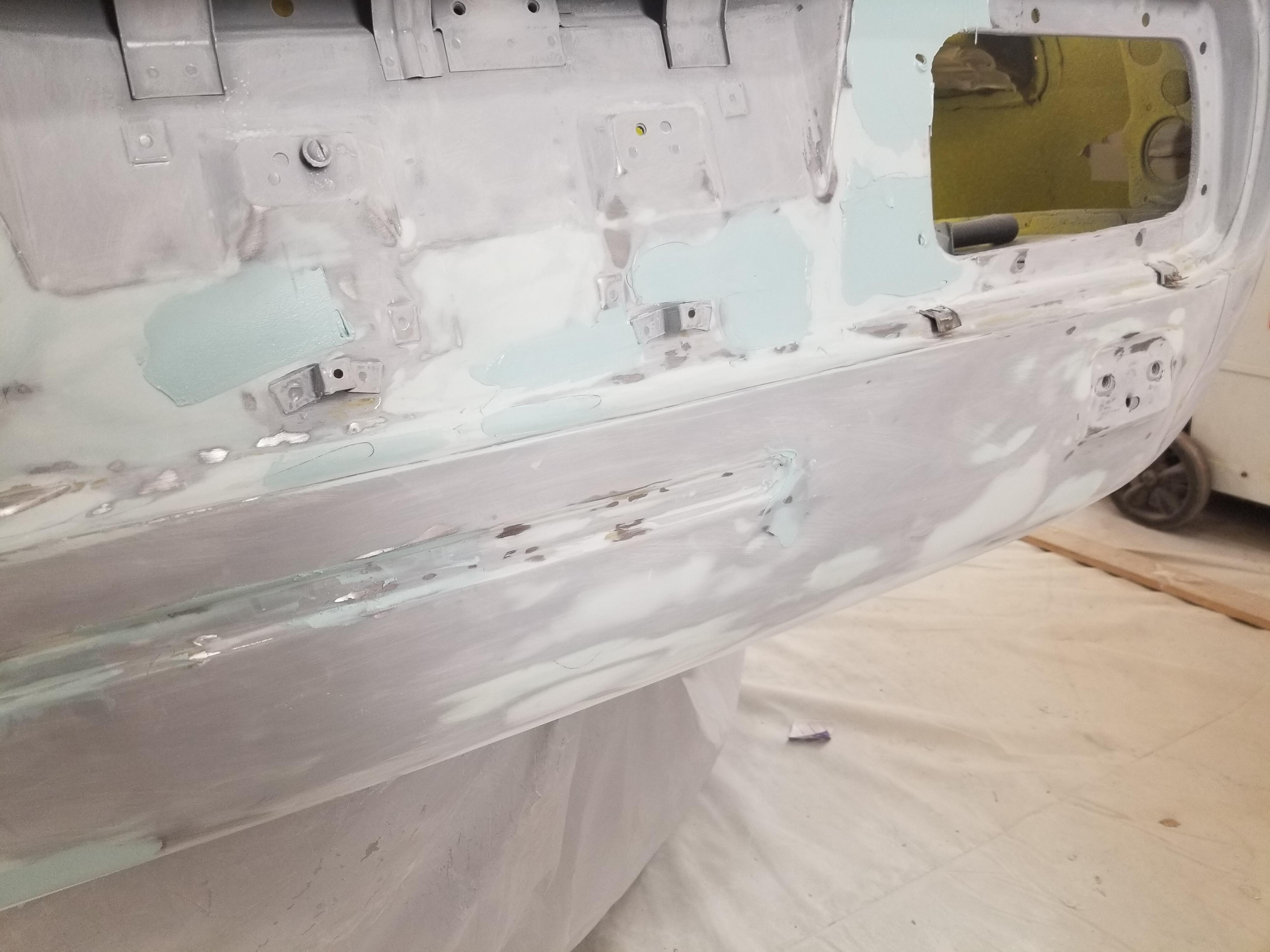

I also worked on the tail light panel some on the right side. I noticed it wasn't flat so I started messing with it and it was badly oil canned. So I worked on shrinking it.
I might could have made one video if I knew how to work my phone but I obviously don't :blush:
The area I tried to shrink got better but I couldn't get it right. So I eventually cut a relief cut and welded it up. That made it very acceptable. I may have over heated the first couple of spots and sometimes that makes it difficult to get it shrunk all the way down. It's also possible when I reinstalled the the tail light panel, I put that oil can in it and it just wouldn't shrink enough. I also don't have a shrinking hammer and dolly. That might have helped especially when you have it hot
