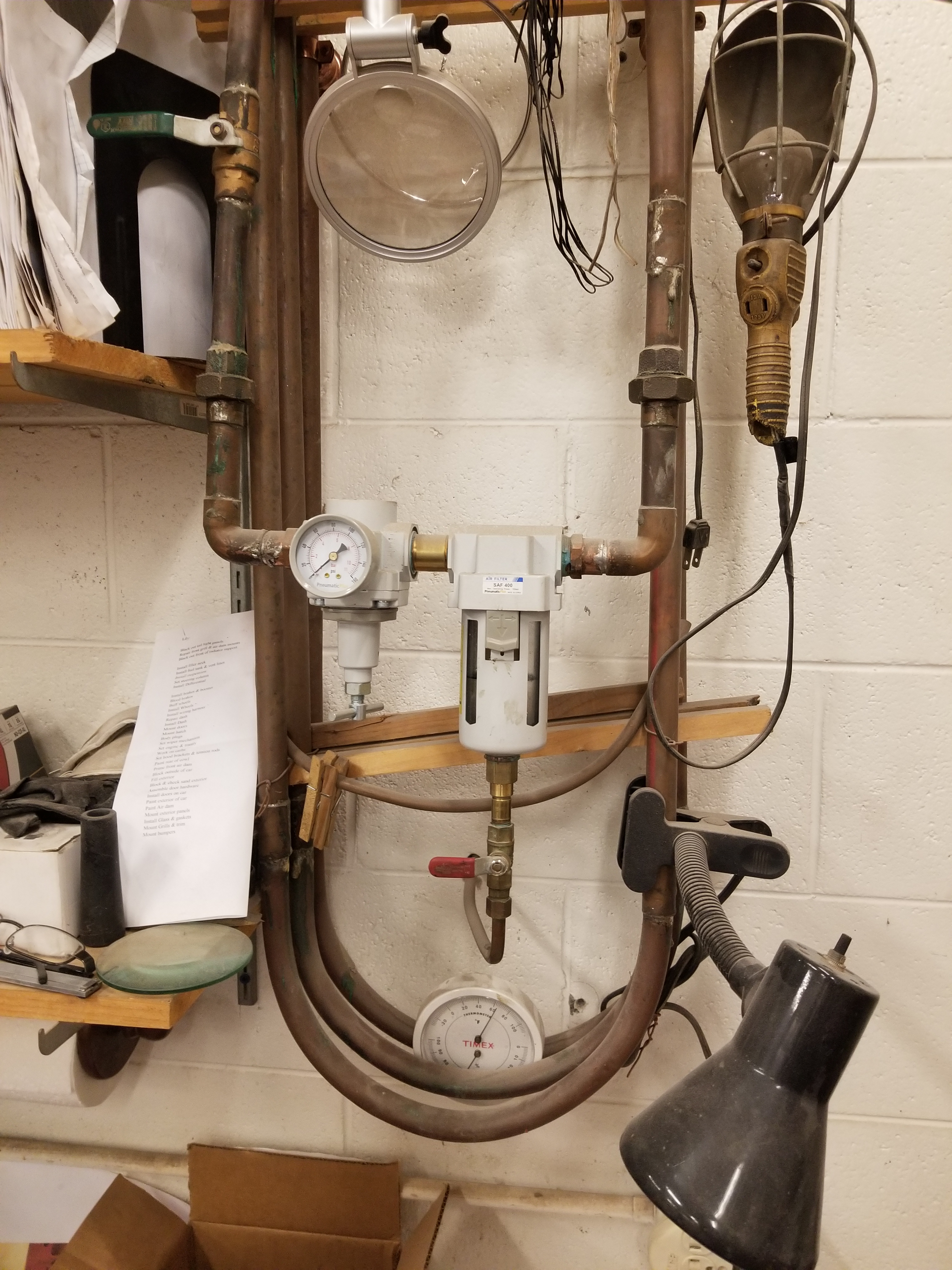

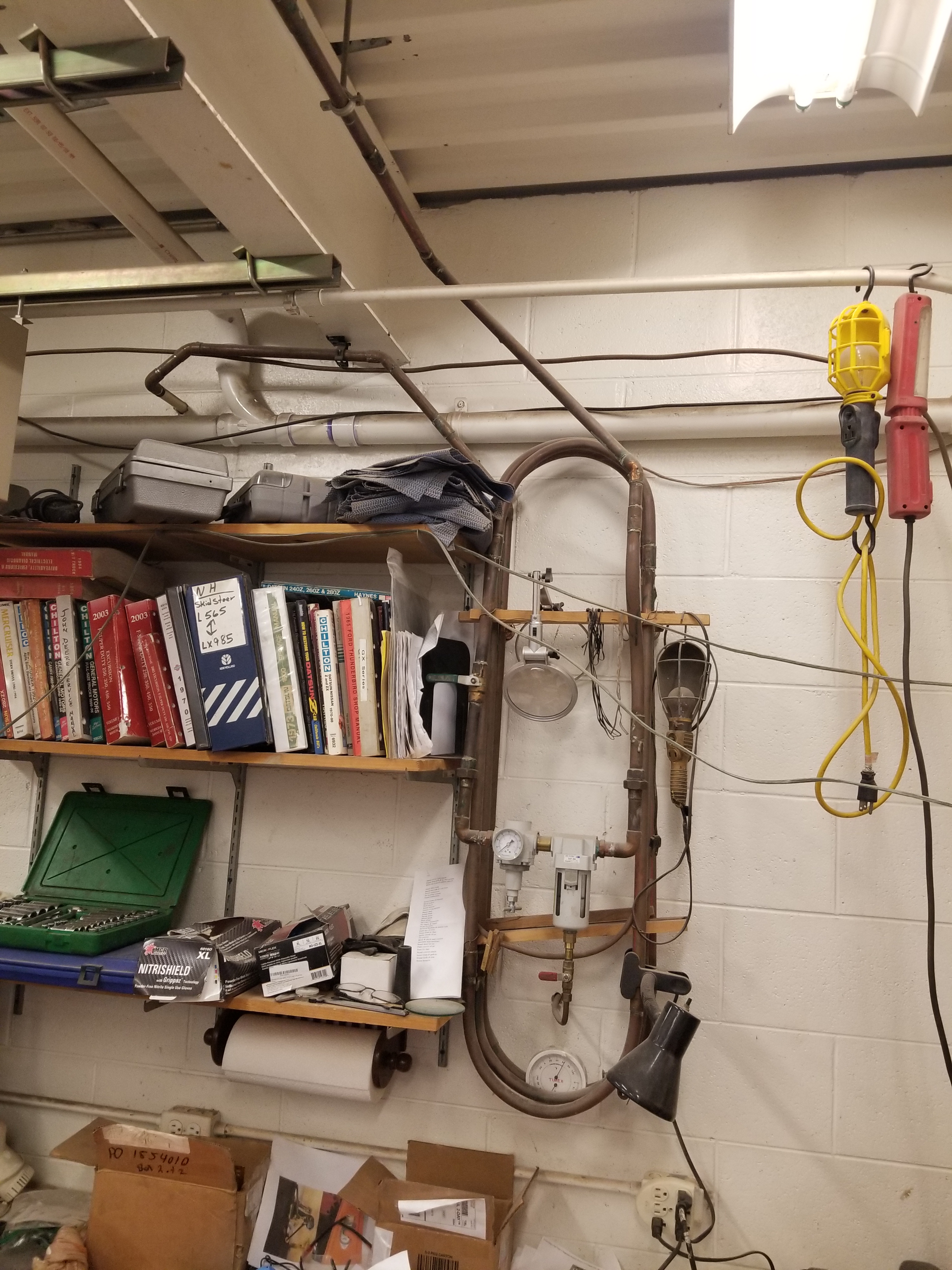

I have a 50 gallon Ingersol rand outside my shop. So cold air in the winter, not so much in the summer.
It comes through the wall and goes into about three loops of 3/4" copper line. Then it hits a pressure regulator and a water separator. The water trap has a drain plumbed through the wall that I can blow down
Then it travels across the shop about 30' and hits my three stage filter dryer. It's a nice unit with desiccant beads but it has gotten kind of pricey in the last few years. I only use this air source for painting and it stays shut off otherwise. When the beads turn pink, I bake them in the oven on about 200F until they're dark blue again
At some point I might rework the loop to be up near the ceiling and horizontal so the loops don't hold water that way. I could also do like you did and use a condenser as a cooler. Maybe, in my spare time 😉
Hope this helps
Hope this helps

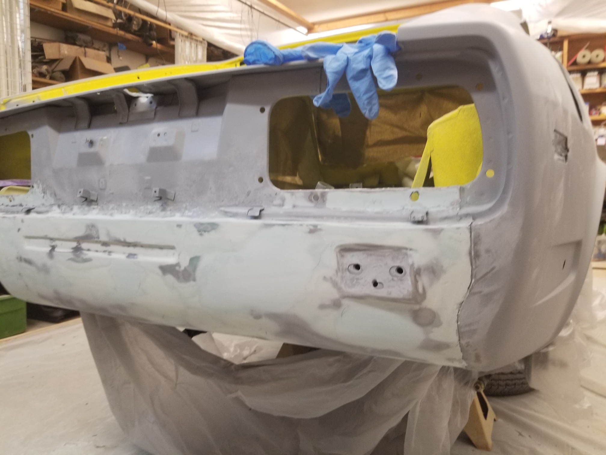

I shot some epoxy over the bare metal areas and then stacked some high build until the gun started acting up

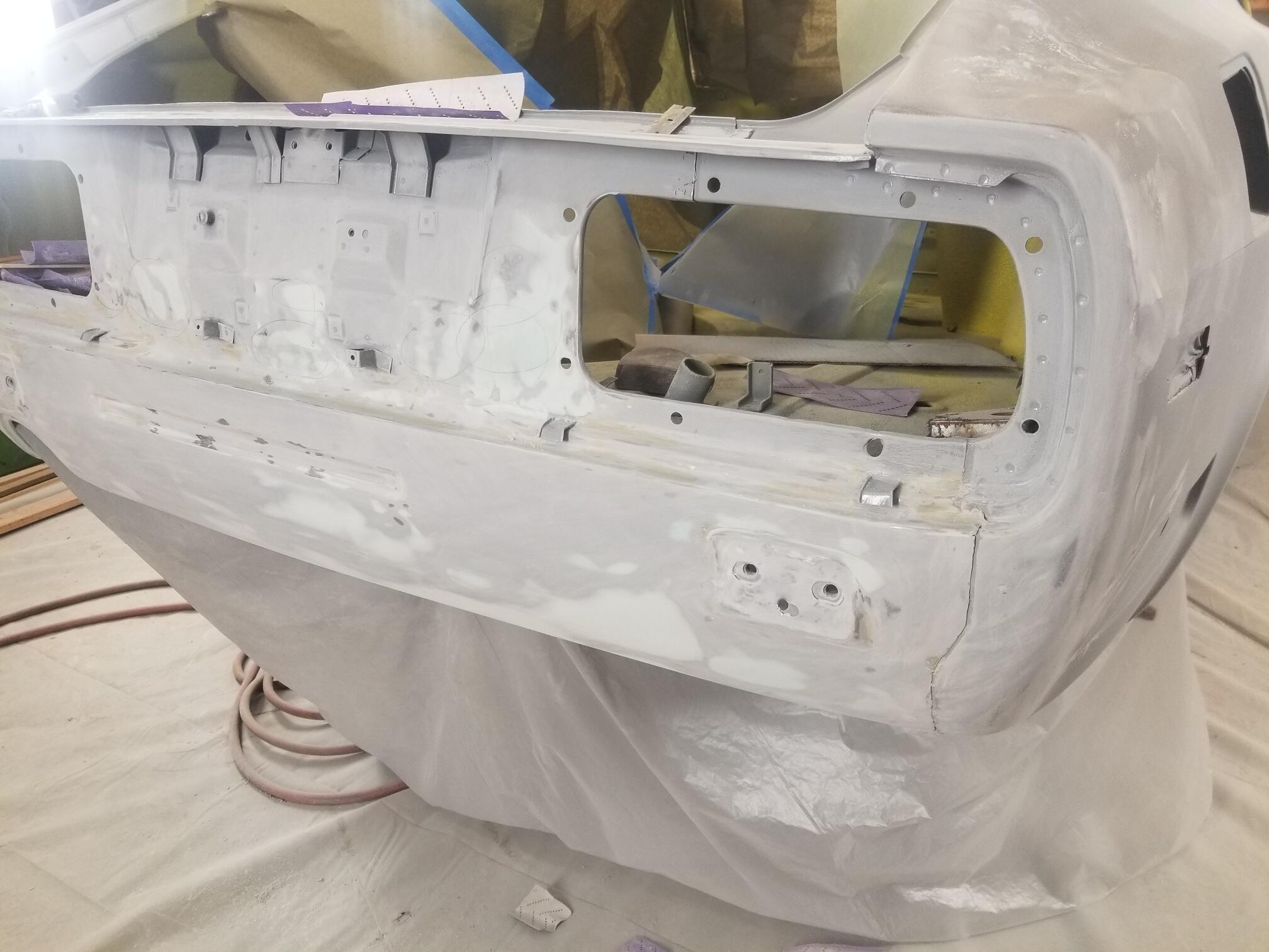

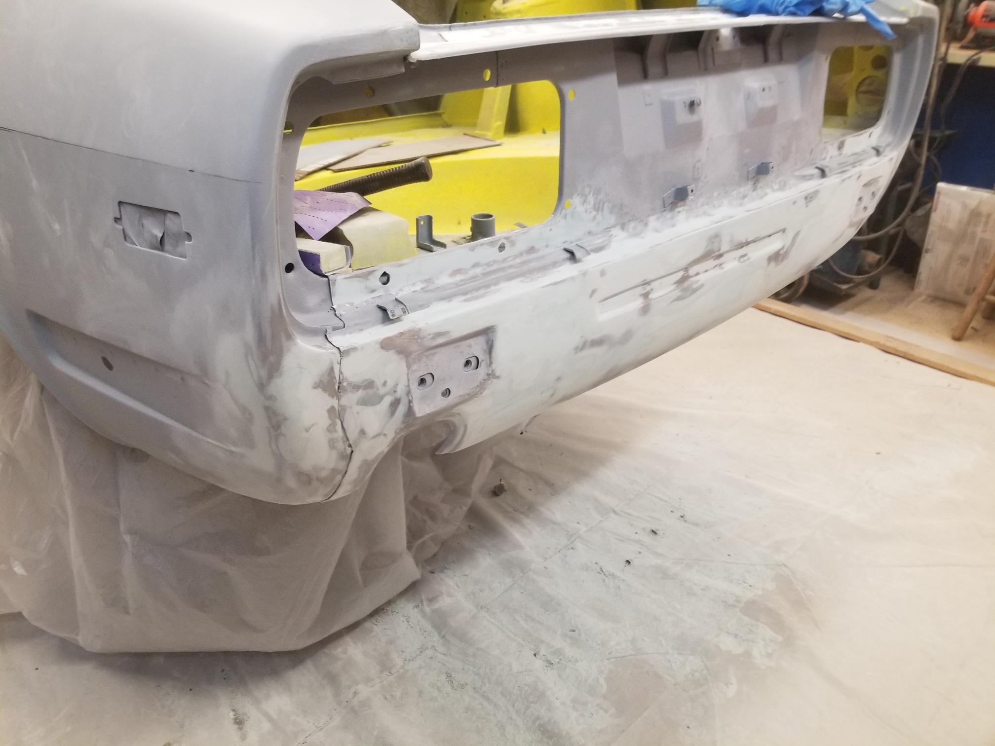

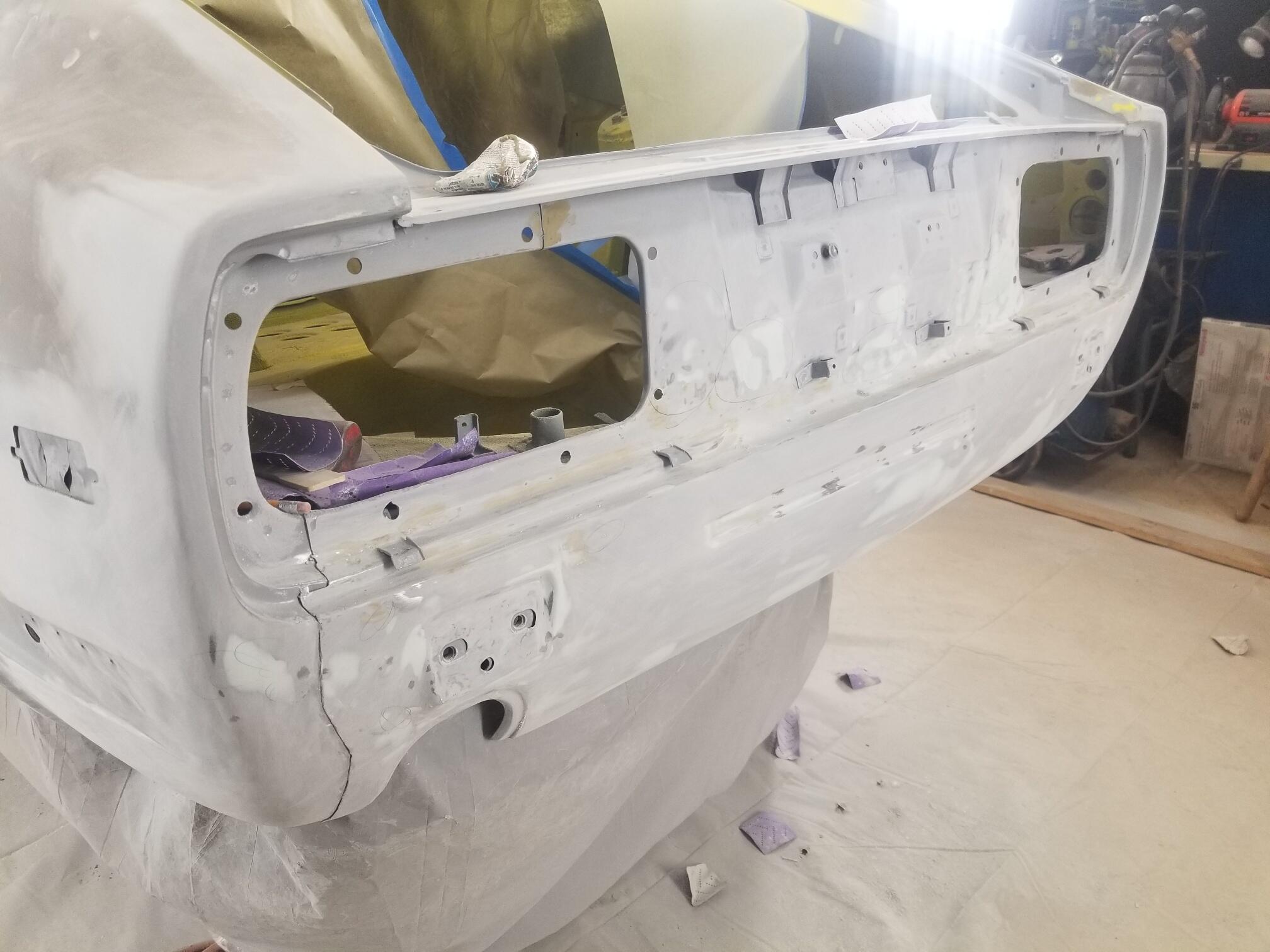

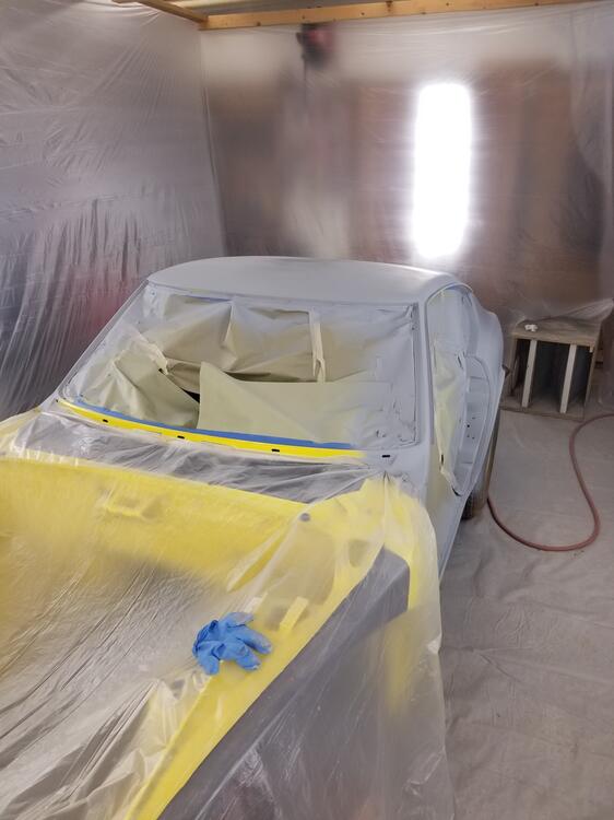

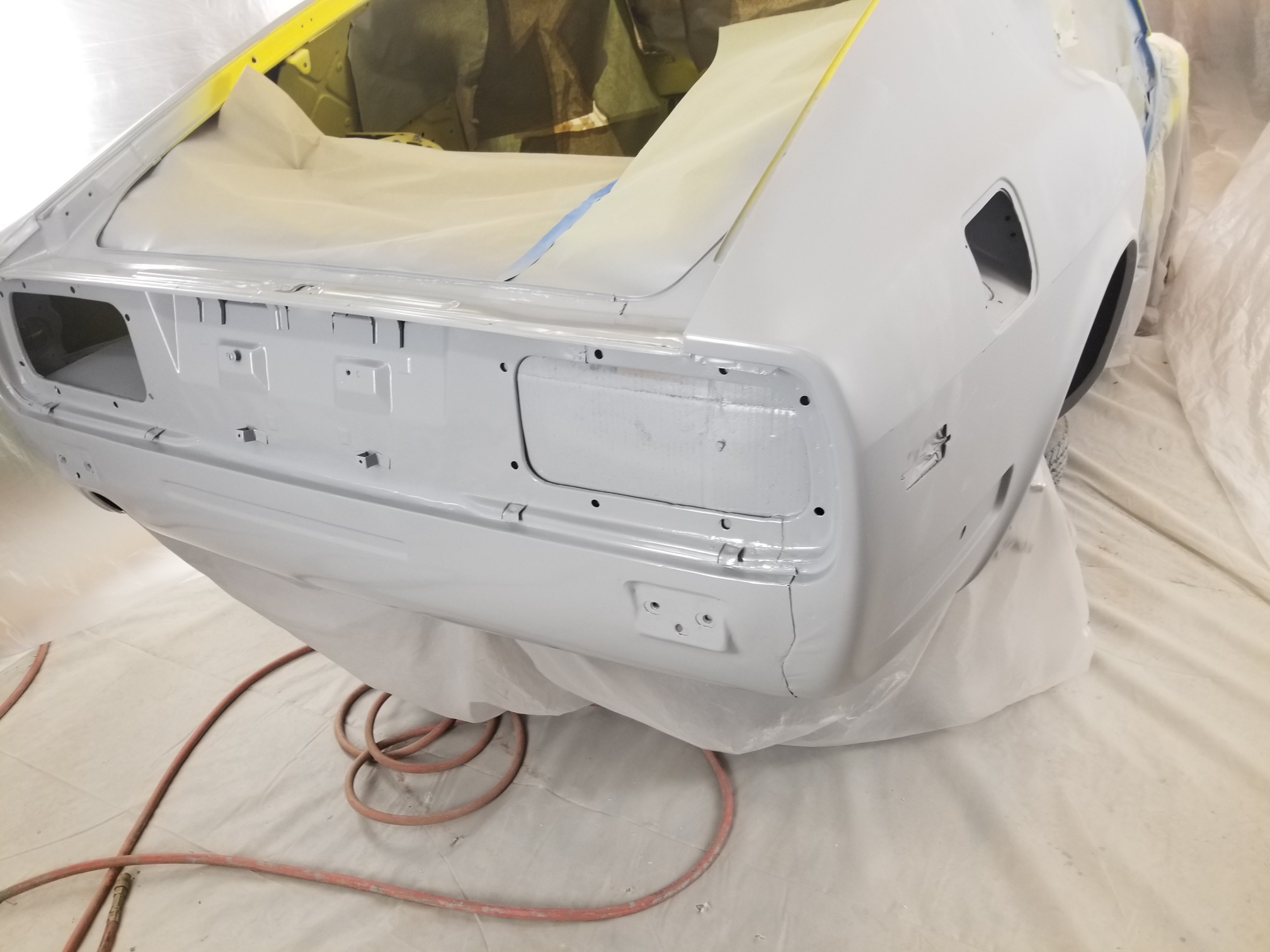

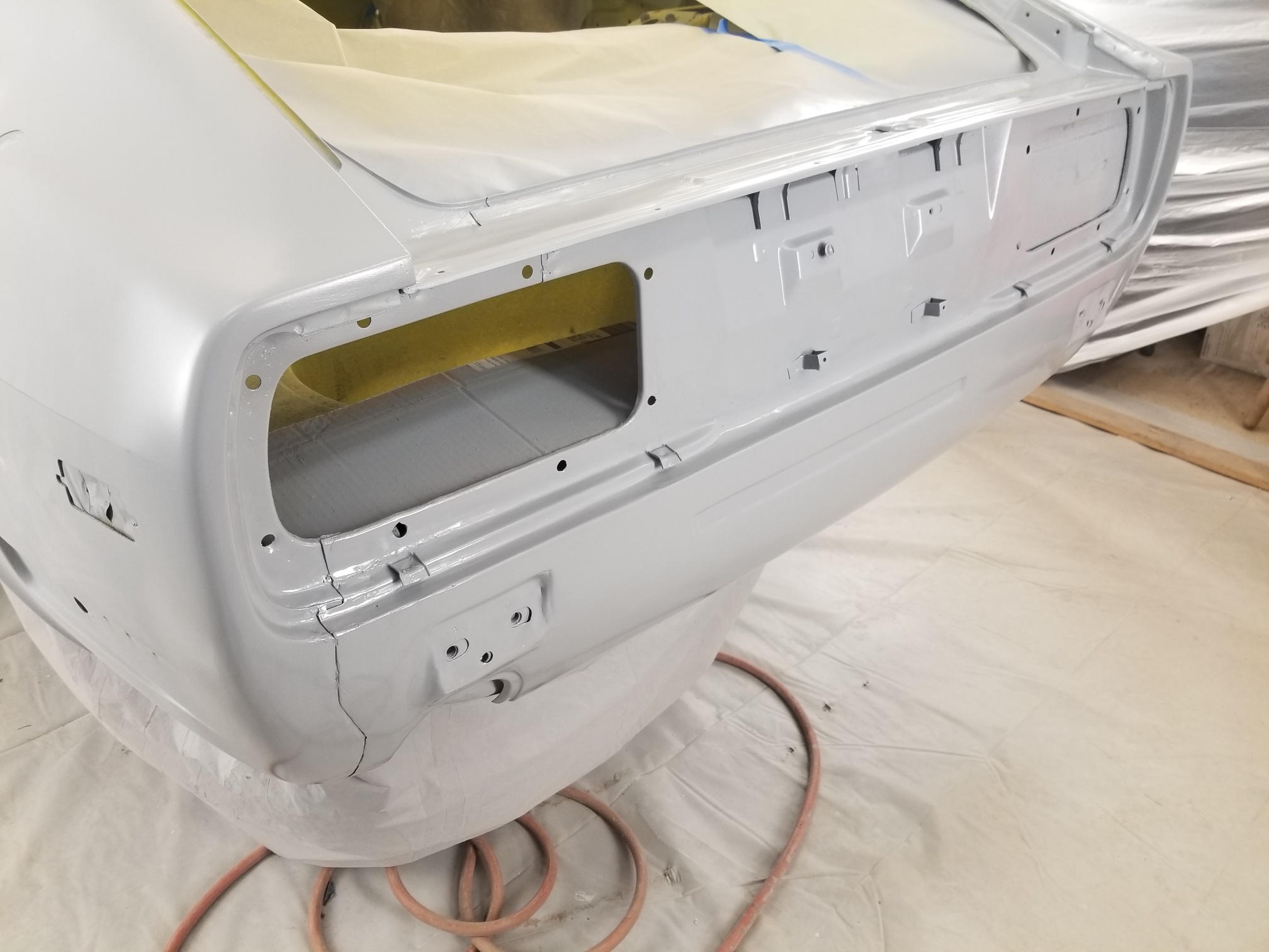

I got 4 coats of high build layed down.
It's always amazing how bad it looks after you shoot a mono color shiny coat on it. All of a sudden there's flaws everywhere! I will use a little spot glaze on the bigger flaws, and then I will start guide coating. It will probably need another round of high build after blocking it down.

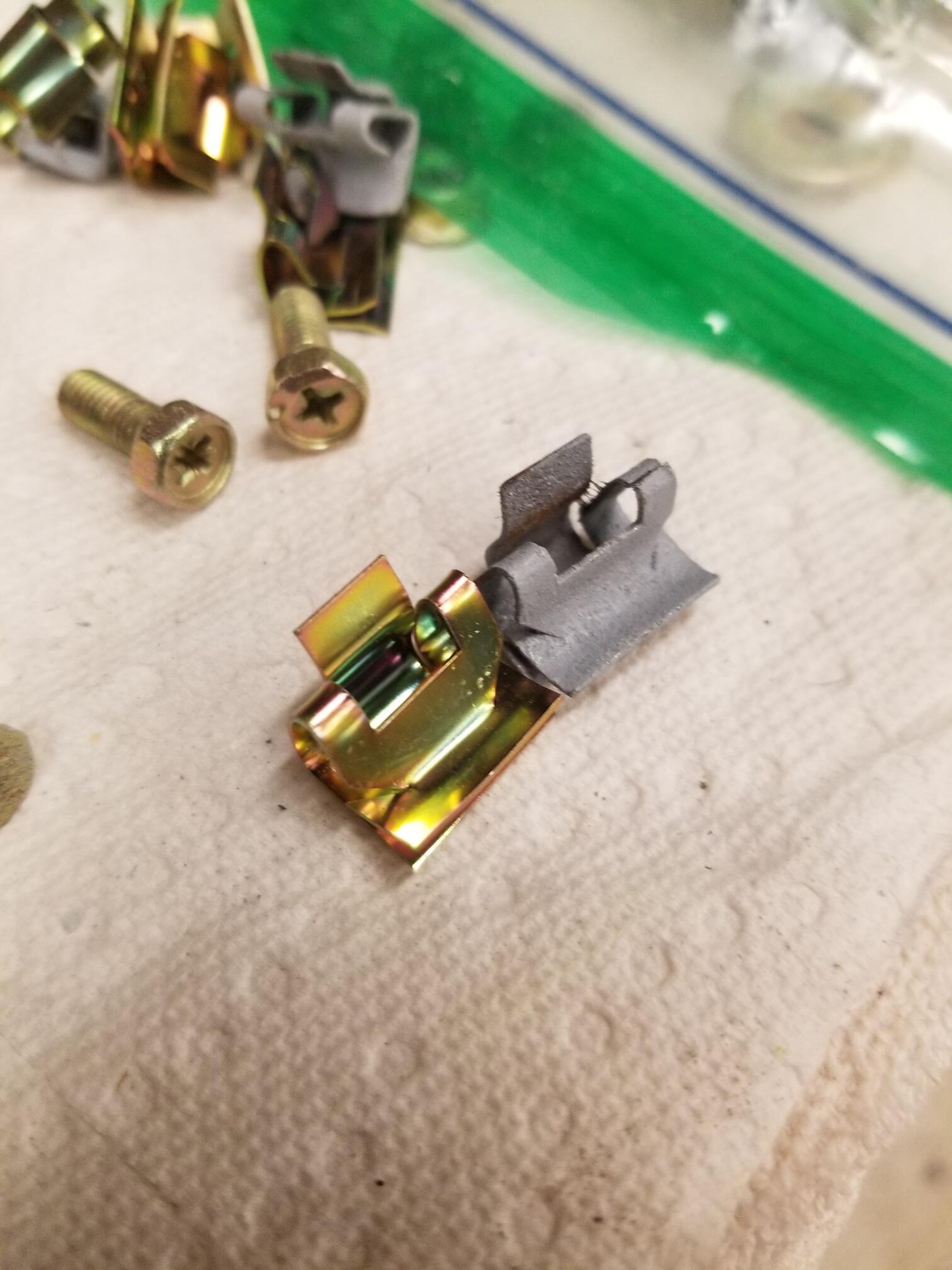

So I am about to double check the tail light panel fitment but I keep breaking the retaining clips. So I had to buy some.
They look really good but they're not cheap!
You can see where the old one is cracked on top
I had one fail the other day and half of it went zinging across the shop.

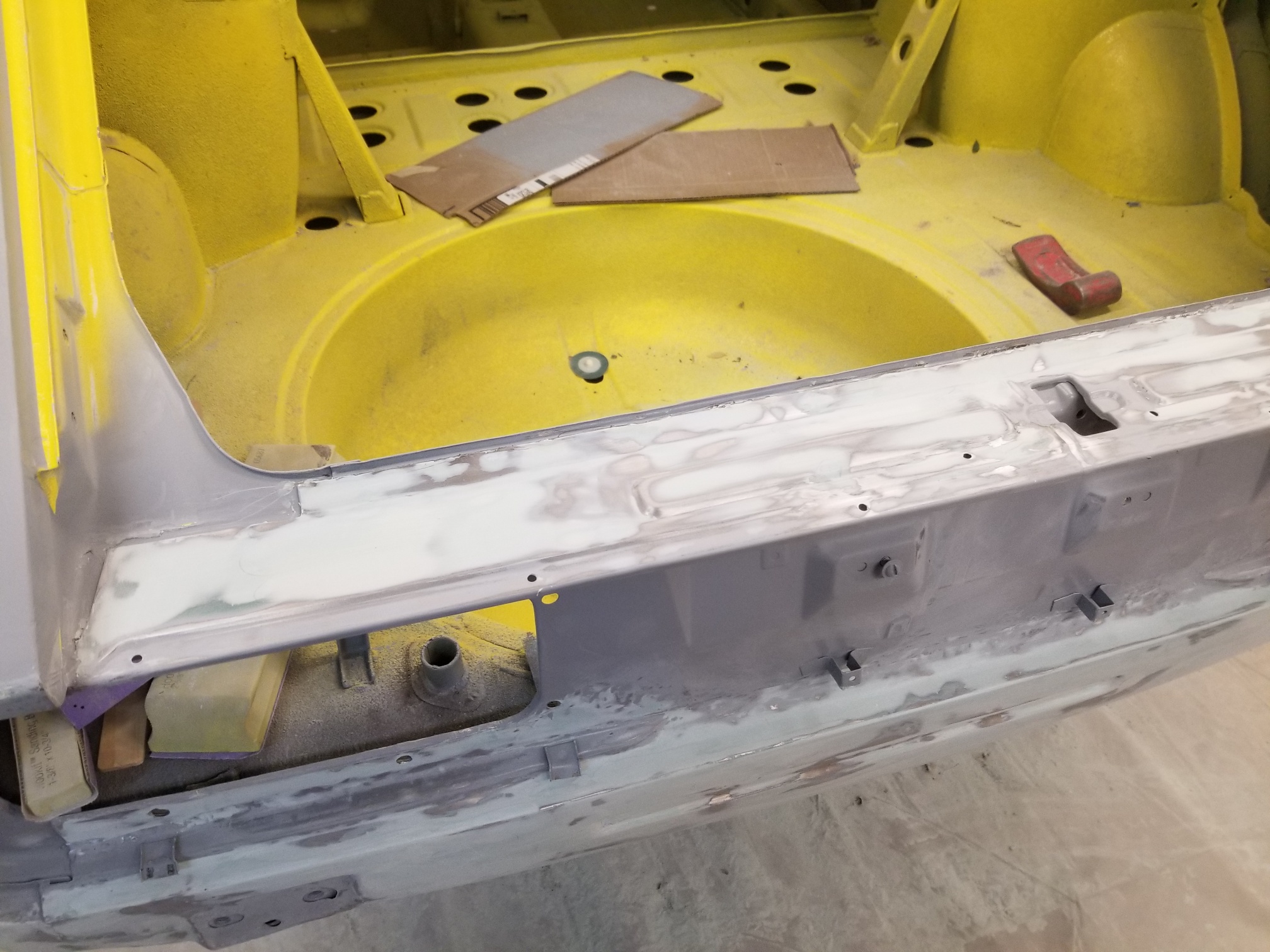

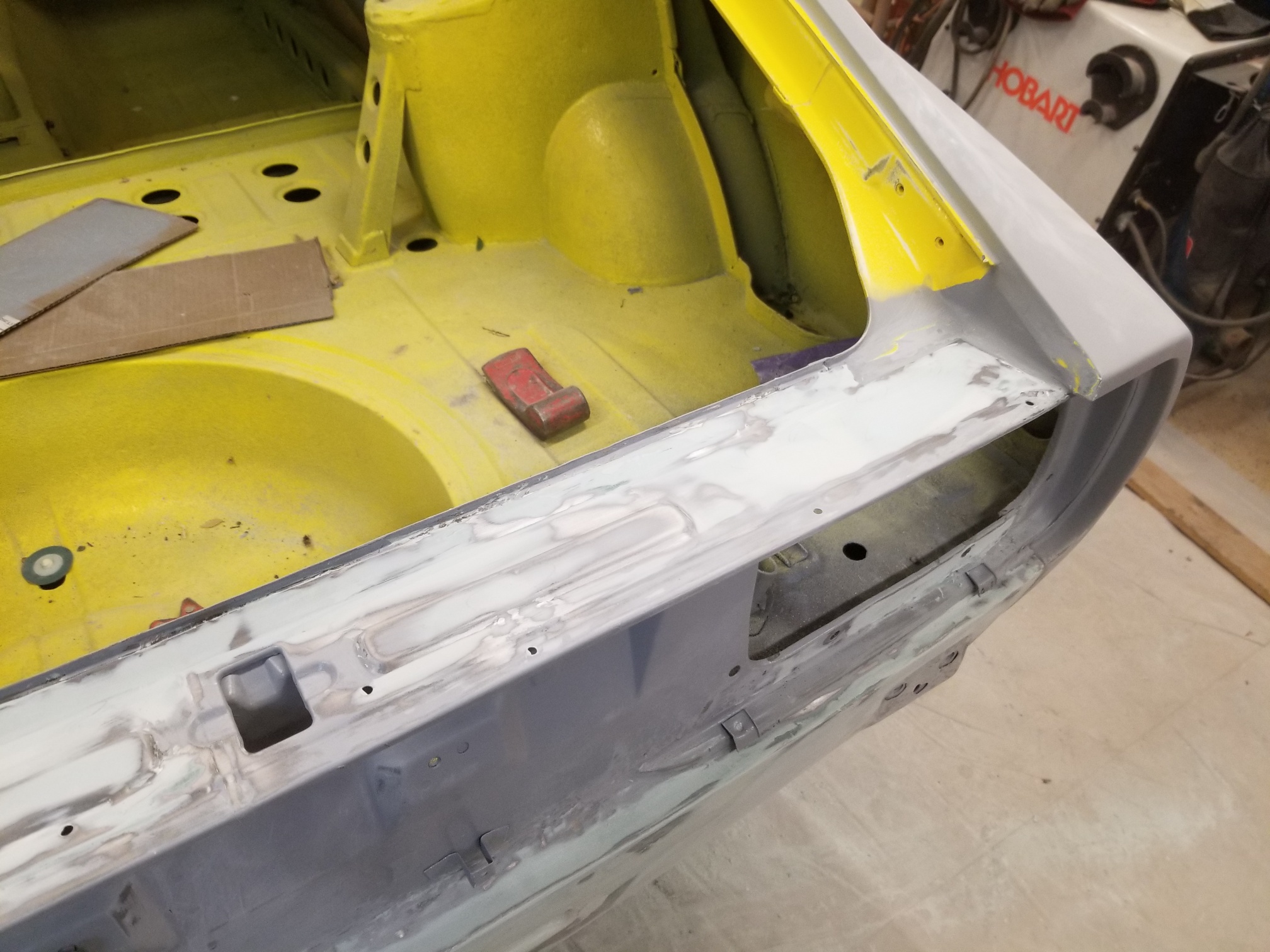

I also started filling in the flaws on the rear the other day. It's gonna need some more high build...
