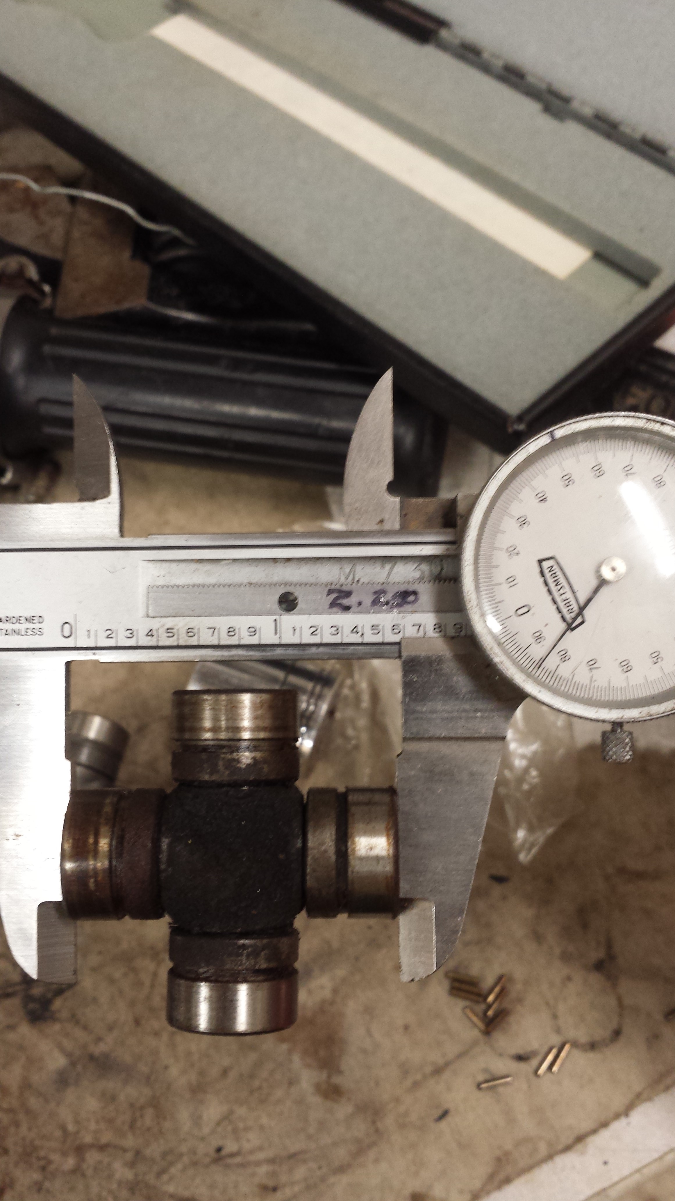

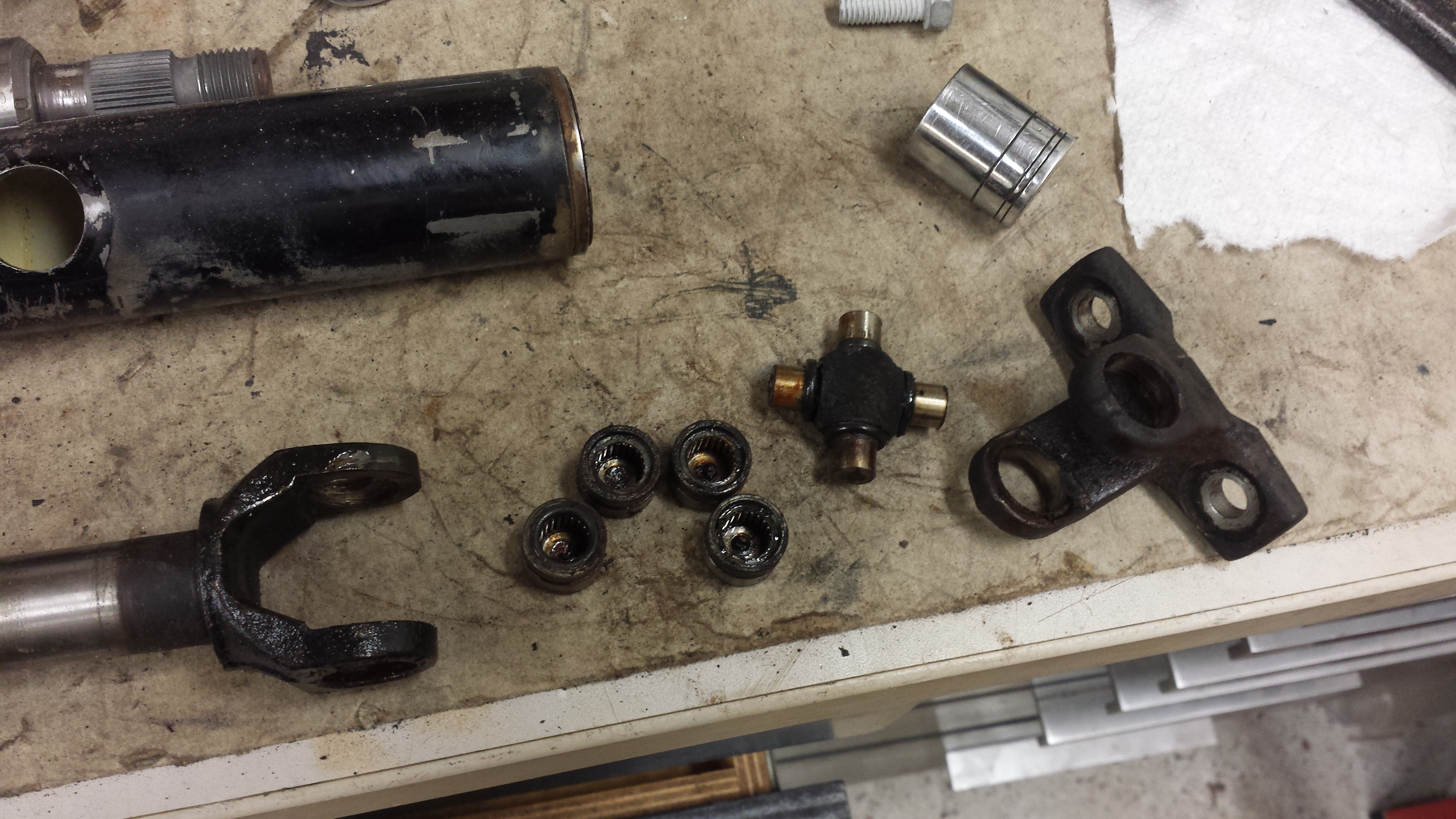

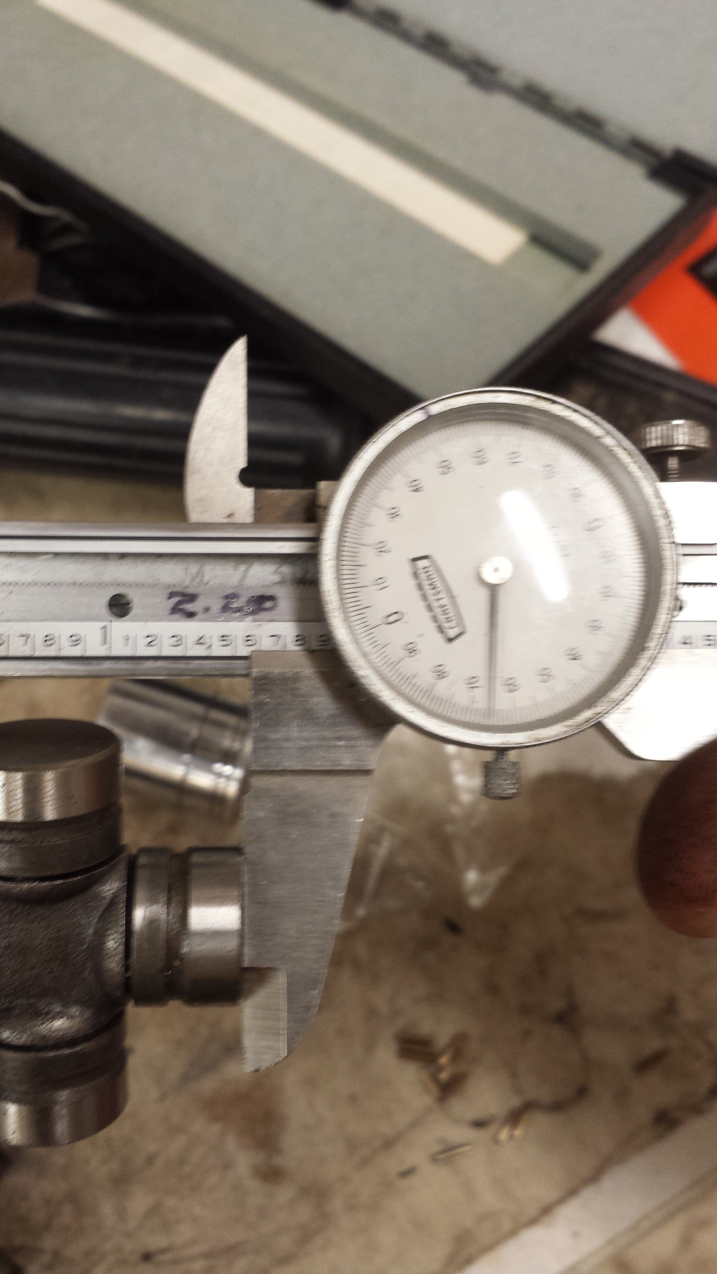

Got the universal joint out of the upper steering column. Pressed it out today after soaking for a couple of weeks...
The new Kawasaki u joint is very similar in size. The caps are the basically identical size. The spoke length overall is very close. Should work great...

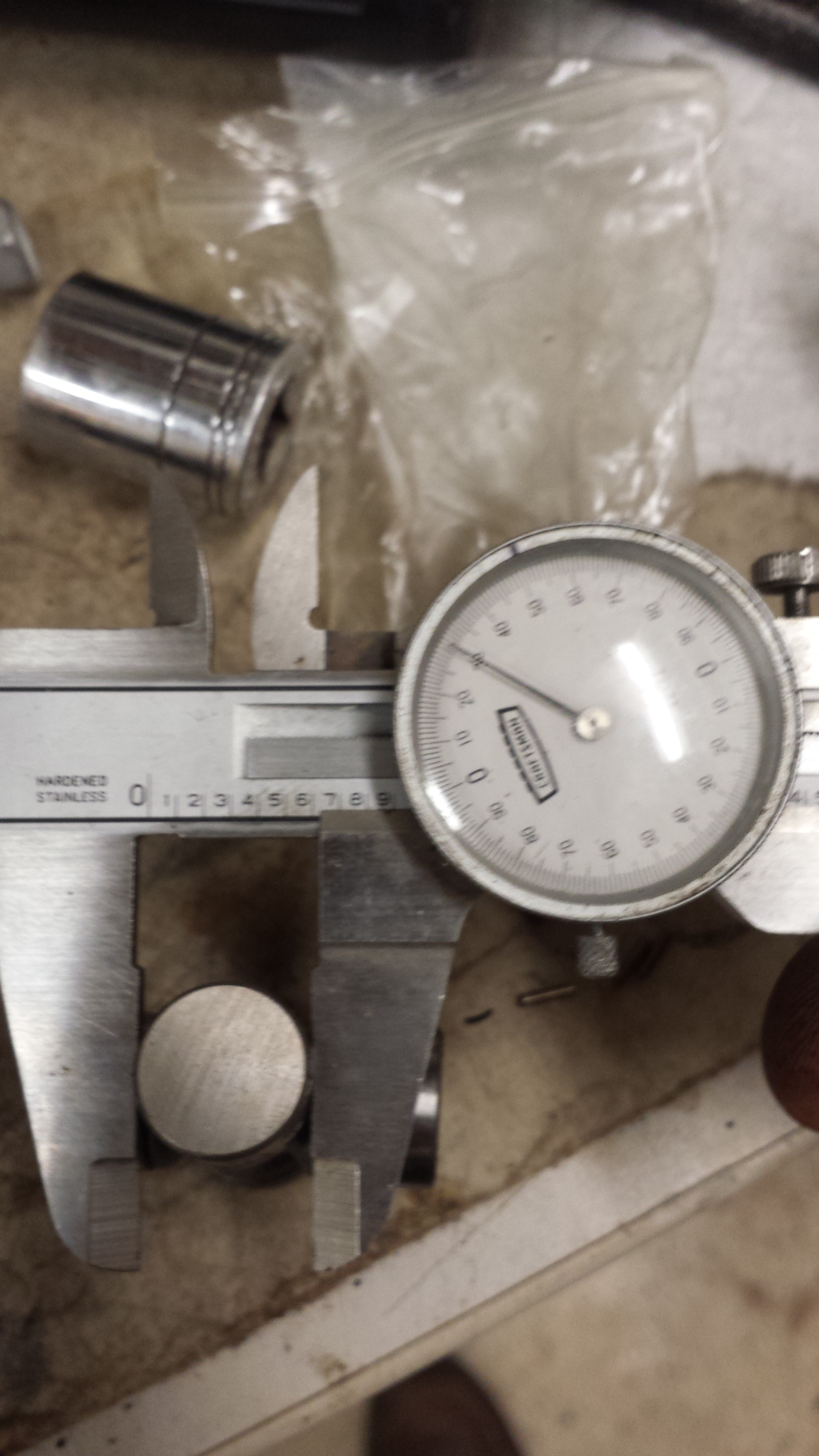

@Captain Obvious
Opened it up today. Looks great!
I had to solicit help from a lathe owner to help with some dies. I found some NOS bushings for the mustache bar. So CO was able to help me out...he might, eventually, sometime, somewhere post up some details... :D

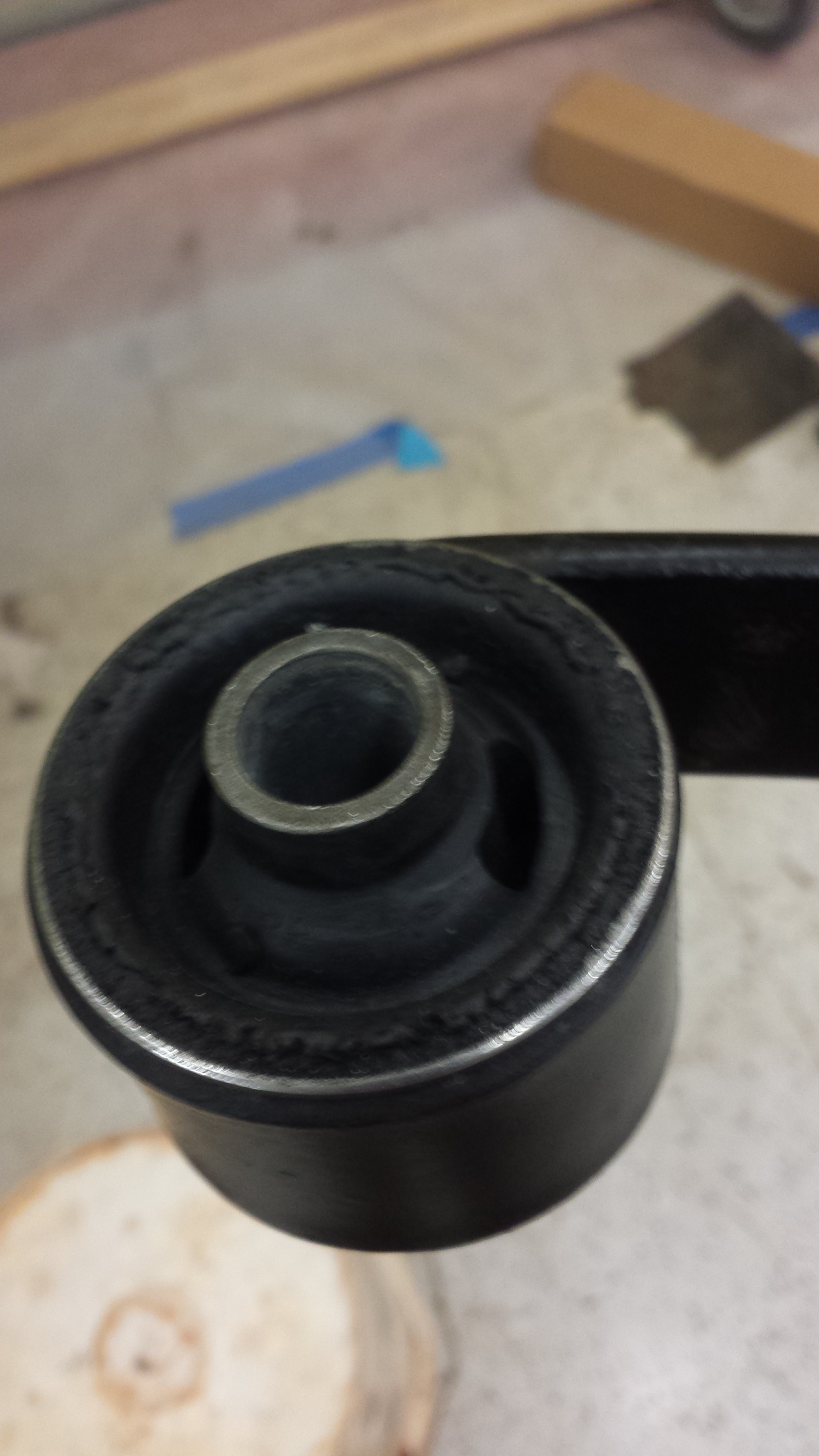

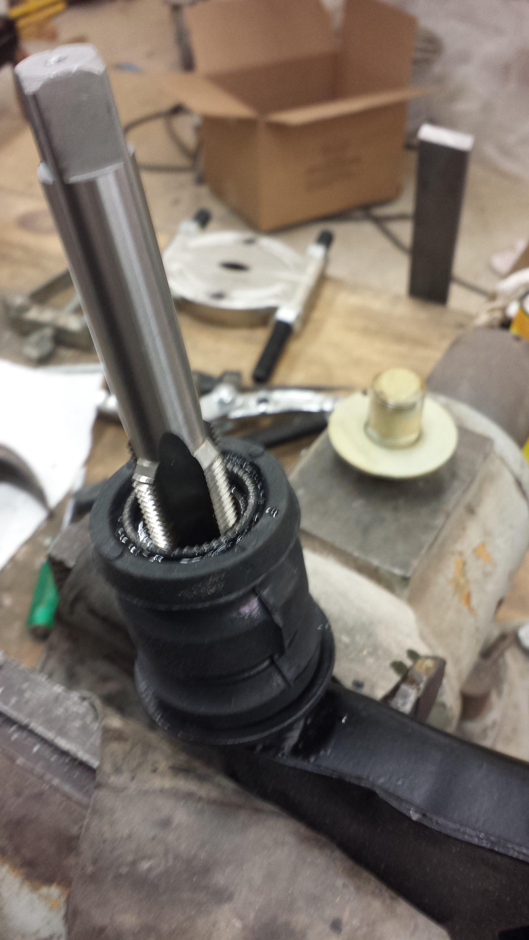

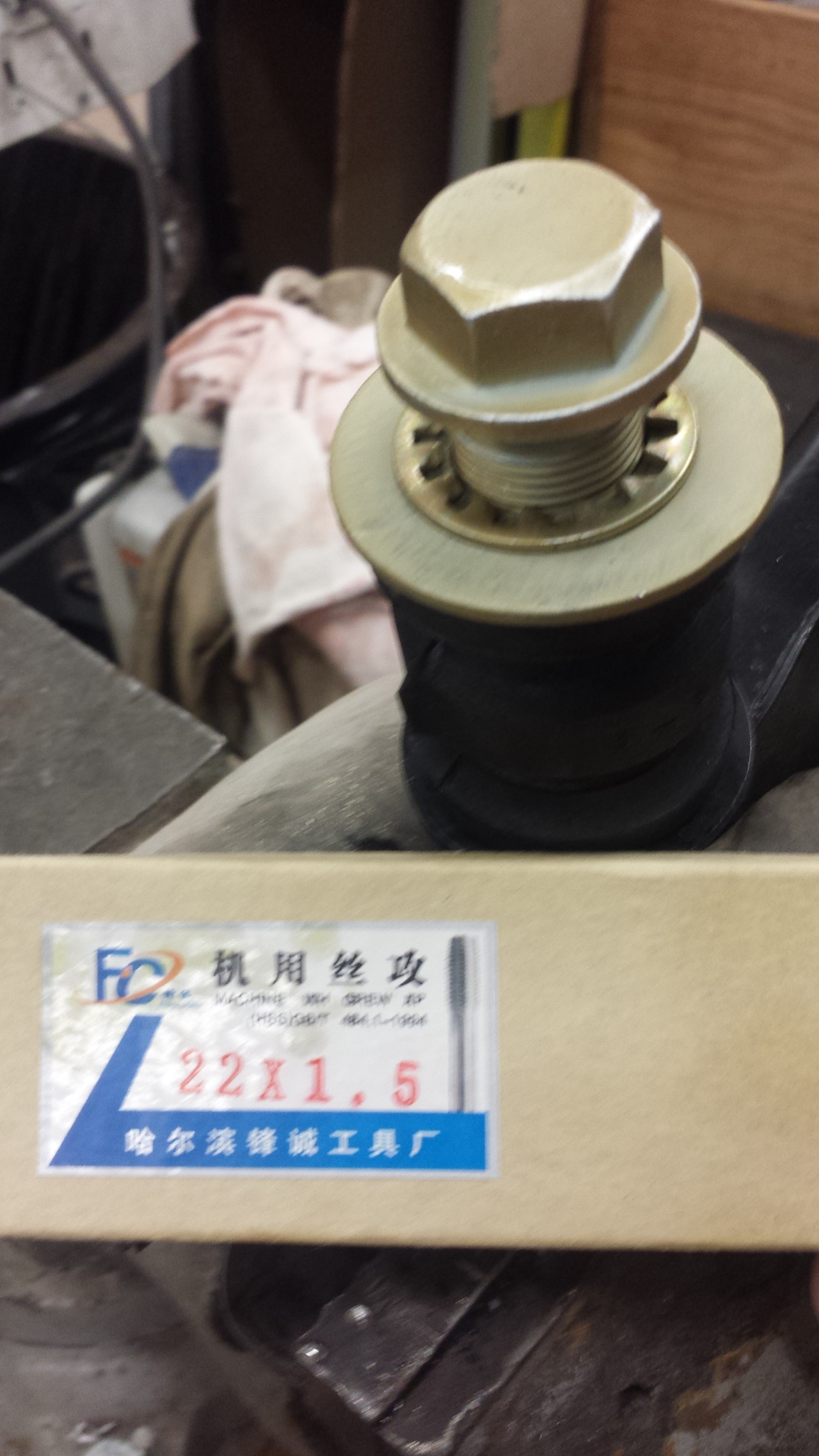

Worked on the lower rear control arms today. I couldn't get the bolts to thread in easily so I found a tap
Retapped them
I bought the cheapest tap I could find. I figured worst case scenario I would only have to tap 4 holes for now...
I did this replacement earlier in the year.  Very pleased with the end result as there is now zero slop (more like, 'click') in the front and rear joints.  A couple of tips:
  • When you reassemble, it helps to chill the needle cups before inserting them into the yoke.  I used a spray can of 'Part Freeze'.
  • Doesn't hurt to also warm up the yoke ears , too. I used a heat gun.
  • When you're pressing the cups home in their bores, be careful not to let one of the cups go too far so that it travels past the inside face of the yoke.  When this happens, the cup behaves like it has a slight draft angle and it won't back up into the bore.  Maybe it gets cocked a bit sideways, too.  Whatever.   Bottom line is that the cups will go one way (in), but they won't go the other way (out).  I learned this the hard way and ended up having to cut a brand-new spider in half in order to extract the cup from the yoke.  After that, it was back to the cycle shop to buy another one.
  • You may need to dress a bit of metal 'flash' off certain edges of the spider casting (forging?) before you'll be able to get the second yoke in place.  You'll know which edges need to be shaved when you try to assemble the parts.  You won't need to remove much more than ~ 1/64", but without doing this there may not be enough clearance to get the second yoke ear to fit over the ends of the spider.
  • What with chilling, heating, and pressing, you're probably going to make a bit of a mess when you're doing the re-assembly, so save any painting until everything's back together.
Progress looks great!
I will post up details of the moustache bar bushing dies when I get a chance. Since the bushings are NLA and you likely have the last two remaining pieces in the world, I'm not sure how much use they would ever get, but I think details would still be fun to look at!
(PS - The thing that puts threads on the outside of a male part is a "die". The thing that puts threads on the inside of a female part is a "tap". You bought and used a tap. Pedantic, I know.  :)  )
Thanks for the tips Namerow. I thought I would do color afterwards so I could color the joint too, since it looks raw.

Did I really do that??? I corrected it now, my back is pissed and it has me out of sorts a little bit...
On 9/23/2017 at 1:50 PM, Patcon said:
Worked on the lower rear control arms today. I couldn't get the bolts to thread in easily so I found a die
Retapped them
What size is the tap?  I need to get one as well.
