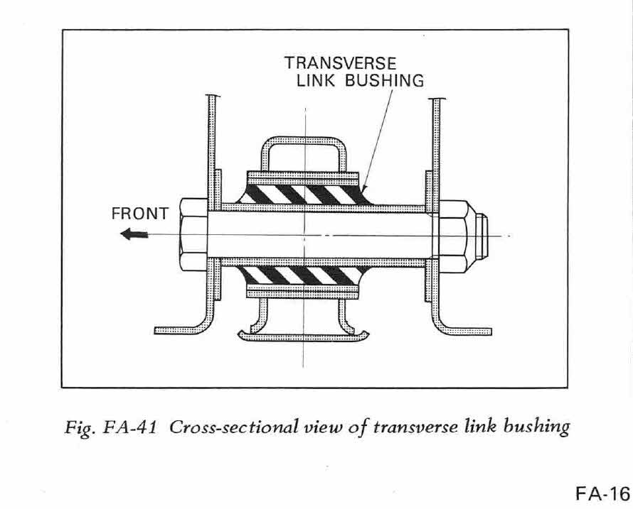

I knew the bushings weren't symmetrical to each other but which way is the bushing supposed to extend, to the rear?
I also found a tiny bit of asymmetry with the rear spindle pin bushings as well. I don't know if it was designed that way, or if it was an accident, but I found a slight difference in the distance the metal collars stuck out of the new rubber bushings. One side was longer than the other, and all of them were consistent (as though it was done on purpose and not an accident).
I put all four of them in such that the smaller distance was inward towards the strut body and the longer portion was on the washer and nut side. I found that with the bushing pressed into the center of the control arm recieving cylinder, the distance between the two bushings worked out to almost exactly the width of the strut knuckle casting.
I found that if I reversed the bushings and centered them, I ended up with a gap where the strut knuckle fit. Of course, it was a small gap and would have easily clamped down as I tightened the spindle pin nuts, but I figued if I didn't have a gap in the first place, that would be better. Also, putting the longer end on the outside allowed more room for the rubber sealing washer.
Don't know if all the aftermarket bushings do that, but I bought Raybestos 570-1030 - There are two bushings per box, so two boxes per car.
If you squint right, you can see the asymmetry in this pic. See how the center sticks out farther on one side than the other:
I bought Nissan bushings, I will see if they have the same offset. So you turned the "small" side in, correct?

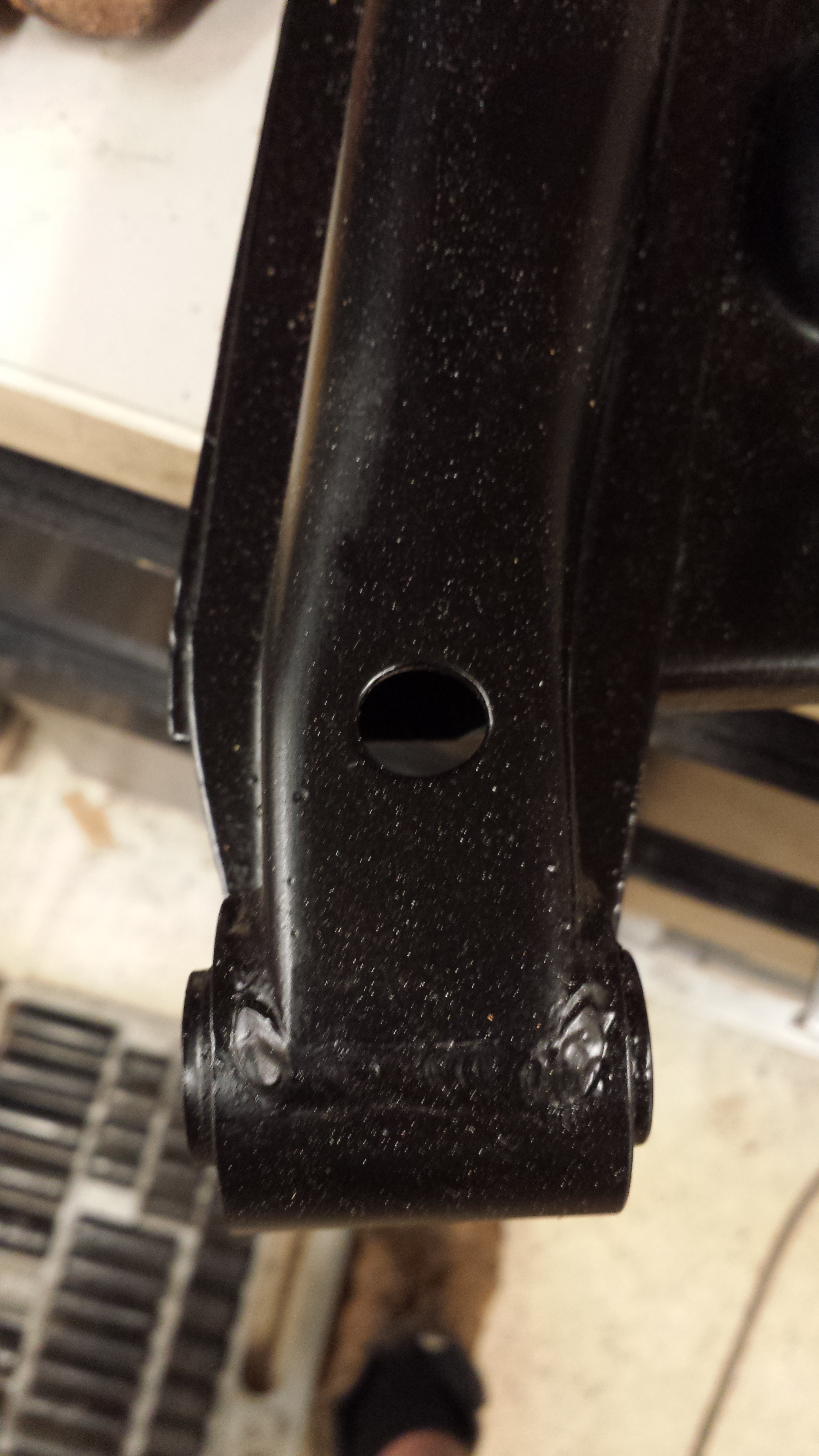

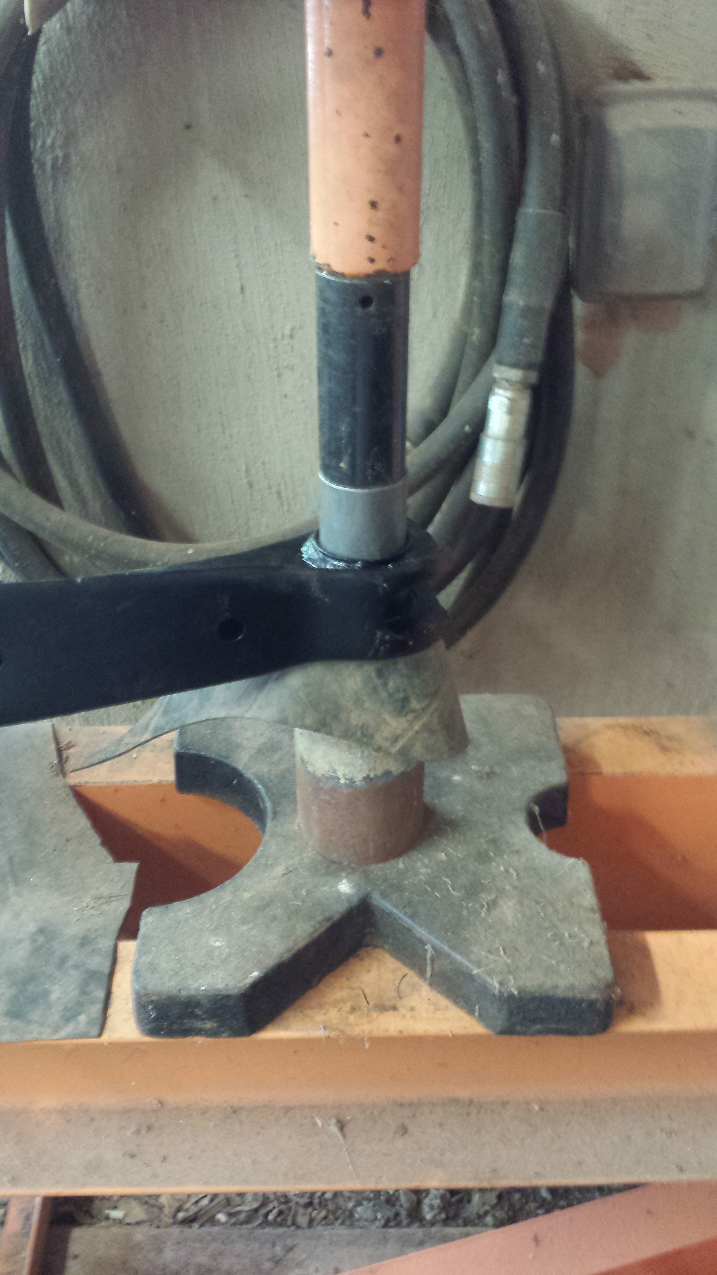

Ok, did the front control arm bushings today

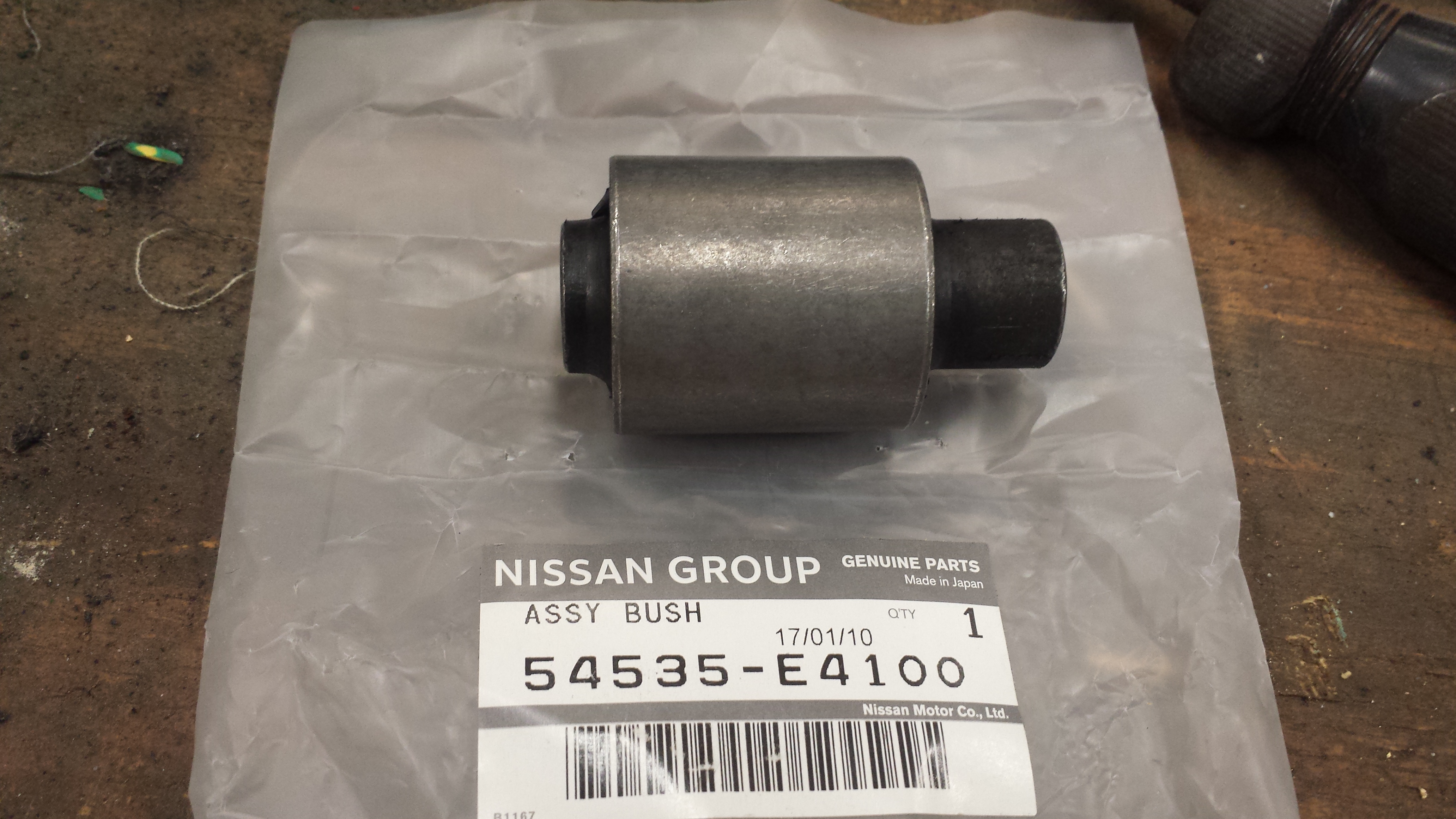

New bushing. Manufactured the beginning of this year evidently

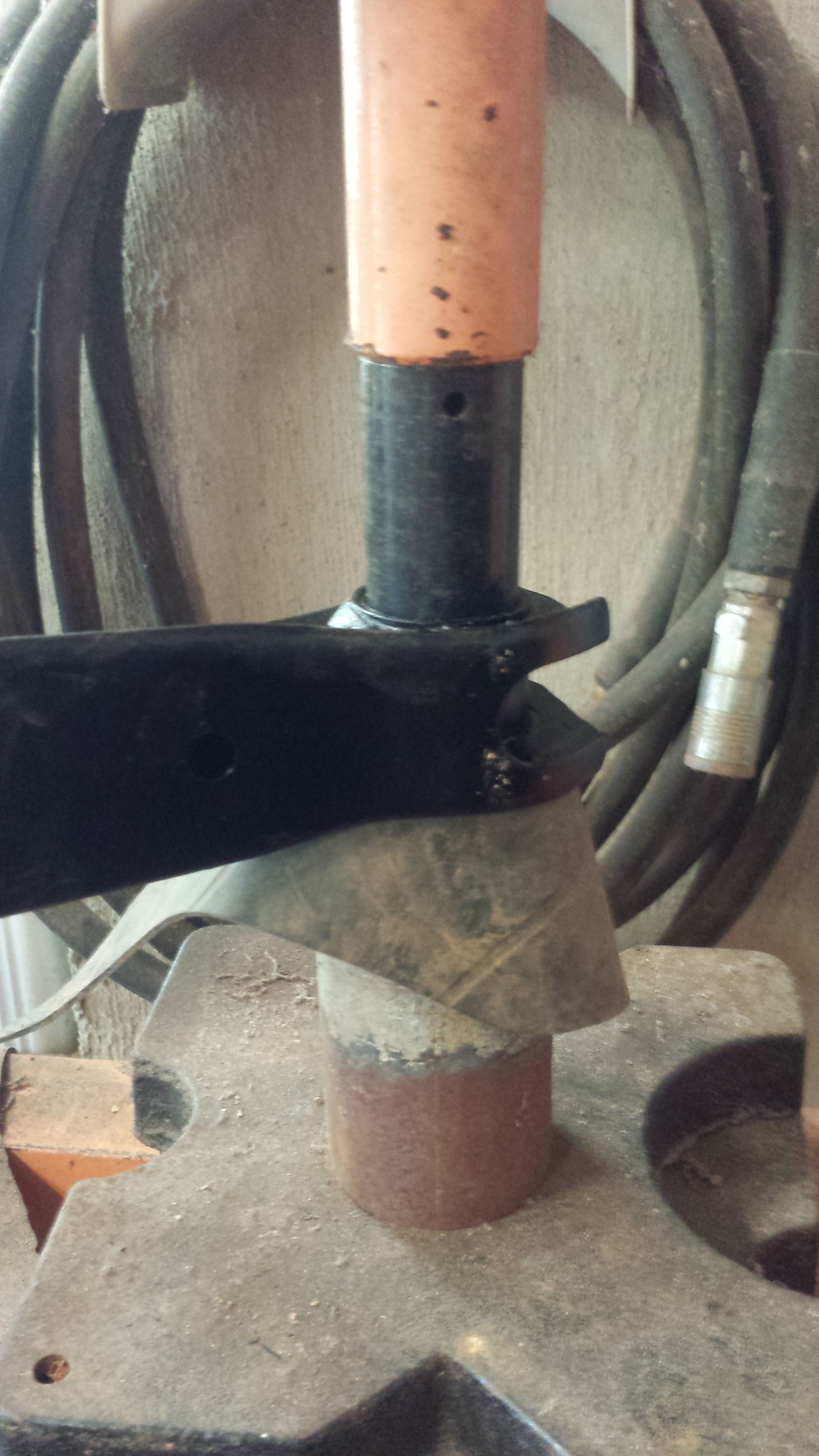

Pressing the old on out. A piece of 2" pipe with some rubber on top and an impact socket to press it out

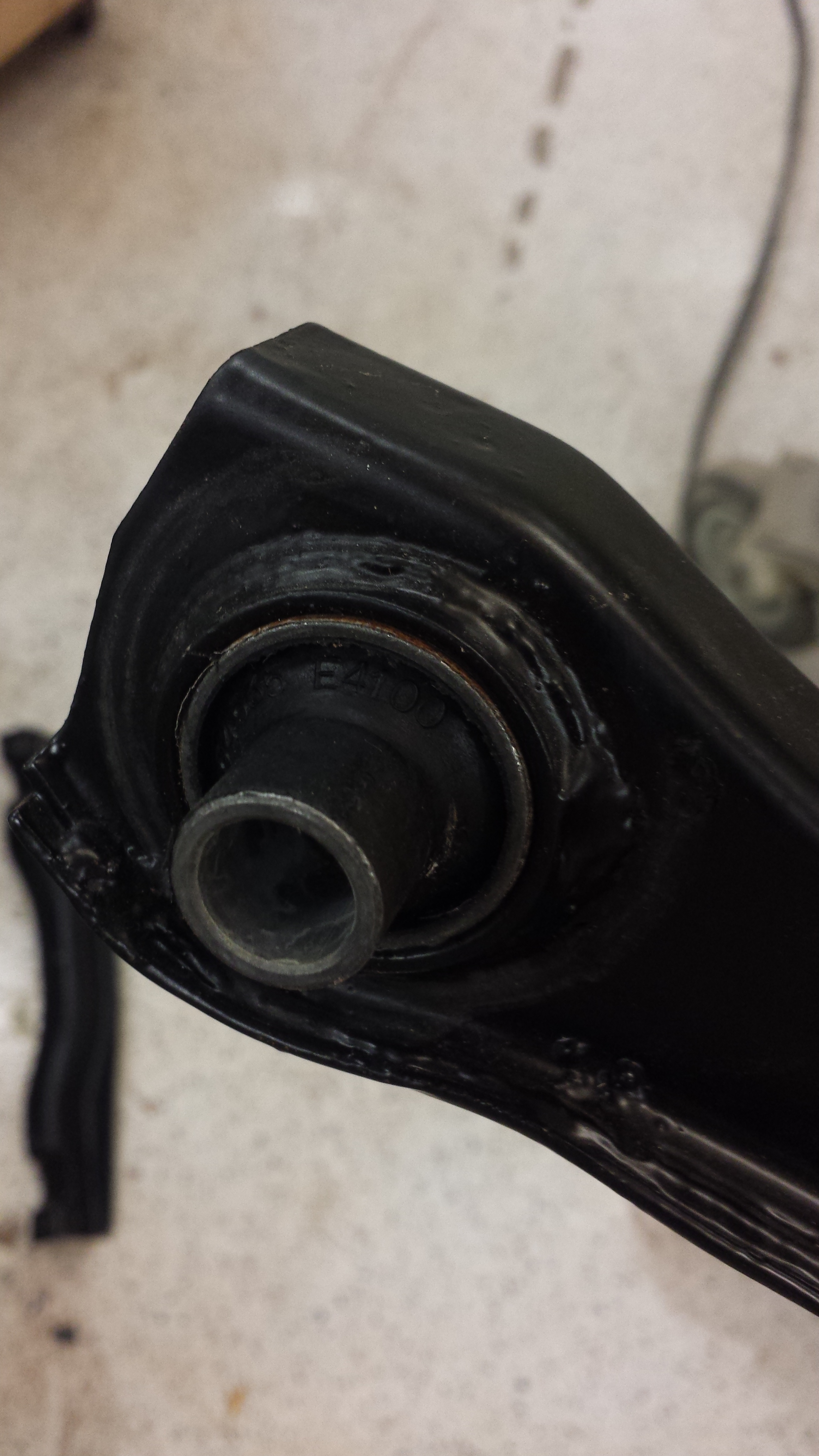

Sorry for the blurry picture. I guess I moved. Both old bushings out. I was surprised there was very little rust but the car spent most of it's life in the South West

Done. The first one didn't take very long. The second one took 7 minutes start to finish. No real problems...

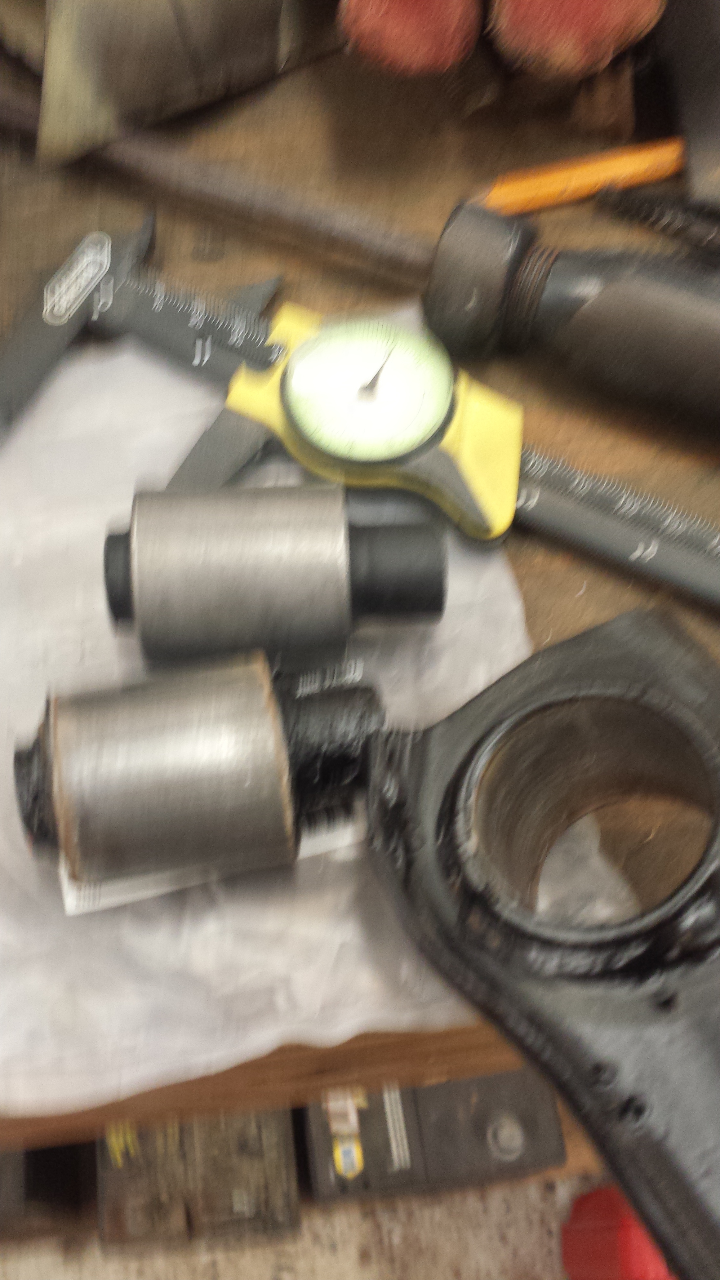

The original bushings are offset on the rear control arms like the Captain said.
About .014" to the outside and .010" on the inside
You can see it on the new bushing too
Yes, I turned the small sides in. I found I liked the fit better with the short sides inboard towards the strut body.
I found that if I reversed the bushings and centered them in the arms, I ended up with too small of a gap where the strut knuckle fit between the two bushings. Of course, since it's just rubber, I could have forced the bushing centers apart a little and forced the strut body between them, but I figured if things lined up naturally without having to do that, it would be better.
With the small sides in, when I centered the bushings in the receiving cylinders in the arms, it worked out almost perfect such that the distance between the two bushings was very very close to the width of the strut housing. Seemed to perfect to be coincidental.
So I don't know if they were really designed to be that way, but it worked for me. And if you're seeing the same small difference on  OEM bushings as I saw on aftermarket MOOG, then I'm starting to believe it really might be intentional. Hark... Did I stumble across something that isn't even in the repair manuals??   LOL
If you haven't already pressed your old rear bushings out yet, measure the distance between the two of them, and compare that to the width of the strut body.

Forgot something... About the rust (or lack of it), with a press fit of that caliber, it's pretty much gas tight.
No oxygen, no rust.
