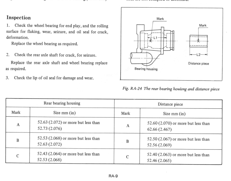

So I mic'd the second "B" piece @ 2.068" . The seat to seat dimension I got was 2.087" & 2.080" I measured in the scallops using the "B" piece as a surface to work from. Didn't have a sacrificial set of calipers
So do the bearings have 0.020" freeplay?

Your hub doesn't measure out as a B hub.  Actually looks like it's out of spec.  The race guys say that the hubs can get wallowed out over time.  Or wallered out if you're in the south.

My hub specs out at larger than even an A hub! So it can't have been wallered? out. The dimensions would be smaller in that case. Confusing...
Now it is possible my measuring is suspect. I would only have to be off by 0.010" to be a B hub, at least on the one side
If  I had the parts in front of me I'd put the spacer in to the hub  by itself, with a solid flat piece on one end to set the surfaces.  Then feel or eyeball the other side, just to see what's what.  Might tell you something.
I got my measurements backward, you're right, your hub is measuring too big.  That's an odd one.

Absolutely not. The bearings have nowhere near .020 free play. If your measurements are correct and the distance between the bearing seating surfaces is .020 longer than the distance piece, then it won't work. The bearing will certainly bind when you tighten the nut to even a modest (50 ft-lb). Your balls will be pushed together so tight, you'll feel like... Well, like your balls are in a vice.
I'm hoping it's just a measurement error.  So what do you mean by "scallop"? Can you take a pic of how you're making your measurements?

And the amount of torque really doesn't matter. In theory, all of the pieces down the center have been crushed together taking up all available play. Once all the play has been taken up, there is very little axial movement even as the torque increases. I'm no bearing expert, but IMHO, there should be no discernible difference in bearing preload between say 50 ft-lb and 200 ft-lb.

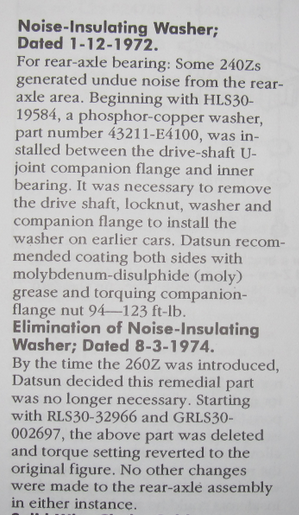

That bronze washer has nothing to do with the bearing preload. It's outside the races. You could get the exact same effect by adding metal to the inside face of the yoke and making it that much longer. Doesn't fall into the geometry at all. Doesn't matter. Honestly I'm not even sure what Datsun was trying to do by putting it in there at all. Doesn't make much sense to me.

I seem to recall at some point seeing that a washer (copper or bronze) was added to help reduce noise? or ???  Maybe that was in the differential though - memory not what it used to be.
Your memory is fine. It was added to try to quiet something down back there. But the thing is... I don't understand how it could possible do anything like that. The geometry just doesn't make sense.
It's like they got a couple complaints back at the factory and they lit a fire under some engineers butt who quickly threw a half-baked poorly thought out fix at it. Then after a couple years, they took that same fix back out. Probably because they realized it cost money and didn't do anything.  :facepalm:
Maybe it was to protect the bearing from over torque, i.e. the copper would compress if the torque or a force exceeded the max torque spec. Sort of a sacrificial  "bumper".
Edited by 240260280
That's about the only thing I could come up with as well. Since that bronze is softer than the steel, it will ooze out a little if the torque is high enough. Although, I'm not sure the normal expected torque is anywhere near "high enough".
Nissan said it was to reduce noise. We talked about it a bunch in this thread:
https://www.classiczcars.com/forums/topic/58935-lost-rear-bearing-shim-washers/
They put it in at the beginning of 72 and took it back out the middle of 73:
I still think the whole thing was a fire under some engineers butt and that was his knee-jerk bandaid. As long as the marketing guys were convinced, then it was a success.    LOL
