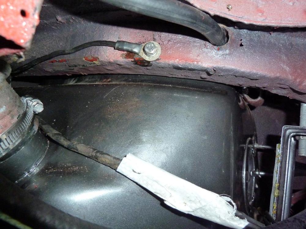

March 11, 20196 yr comment_570643 @zKars I'm restoring a friend's 1973 but I forget where the ground wire near the gas tank comes off the harness. Do you recall? Here are rear gnd pics for a 71 resto I did but I can't figure where it came out of the harness. Here is the gas tank area gnd. Here is the one near the antenna: Link to comment https://www.classiczcars.com/forums/topic/55339-73-240z-wiring-harness-ground/#findComment-570643 Share on other sites More sharing options...
March 11, 20196 yr comment_570646 The ground is in the fuel sender/fuel pump harness that goes through the hatch floor just beside the right rear tail light. It attaches to bolt that goes into the side of the frame rail above the tank. Totally inaccessible without removing the tank. If you think that lug is corroded, you are right. Just splice into the black wire above where it goes down below the hatch floor and make a new ground connection near the tail light. Sheet metal screw about 3 inches long should go right into the gas tank if you aim it right Link to comment https://www.classiczcars.com/forums/topic/55339-73-240z-wiring-harness-ground/#findComment-570646 Share on other sites More sharing options...

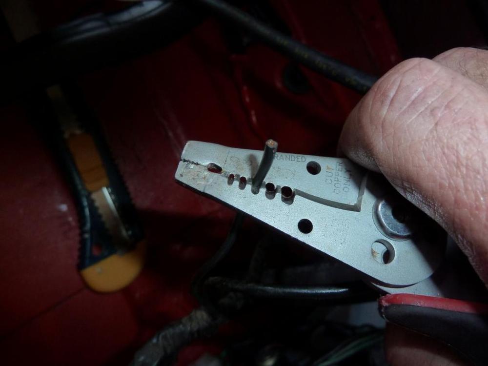

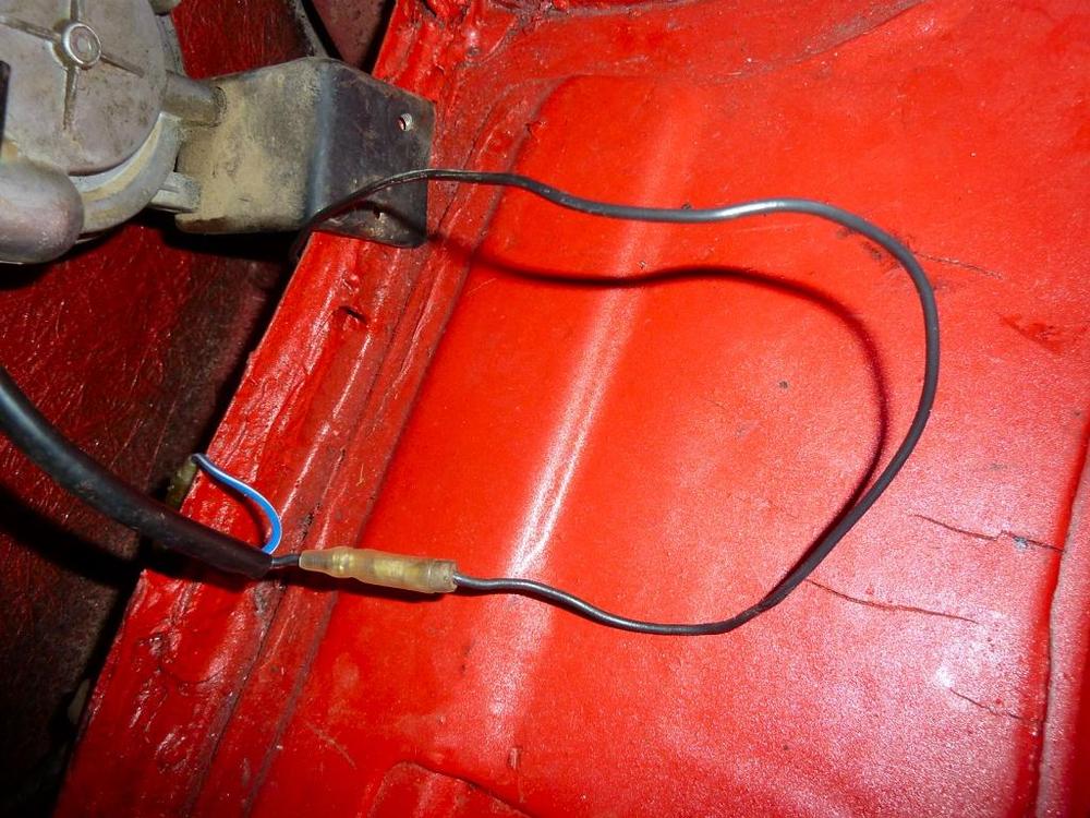

March 11, 20196 yr comment_570682 Thanks Jim, The 73 harness has the two fuel sender wires and a green and black wire coming out of the same part. I thought both the green and black were for an optional fuel pump... it the black the harness ground I am looking for? 1971 fuel sender and harness connection Here is other stuff I documented on the 71: Broken Rear gnd wire from harness? Patching and extending a new connector Extended and fastened. Link to comment https://www.classiczcars.com/forums/topic/55339-73-240z-wiring-harness-ground/#findComment-570682 Share on other sites More sharing options...
