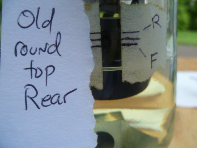

So in the meantime, I had a pair of old round tops here. History is I rebuilt these a number of years ago (in 2011... My how time flies) and ran them on my car for a little while before swapping them out for a pair of flat tops. The point is... I had the float levels on these in spec ten years ago and they've been sitting dry in a box since. In theory, they should still be in spec.
Well guess what... Here's the front:
and here's the rear:
The floats have a neutral tilt when the valves close, but the level is way low. The bottom line is that the only thing that could have changed is the fuel.
So I guess that brings up a new question... "OK, so it looks like fuel has changed over the last ten years. Is it going to be like that from here on moving forward, or is it going to switch back at some point in the future?"    :unsure:

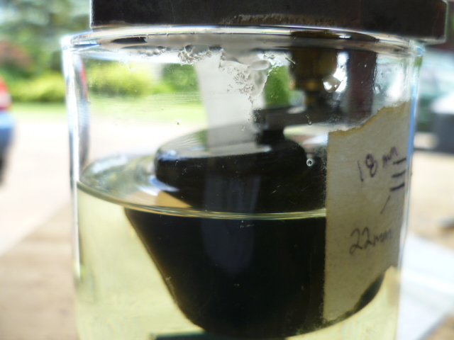

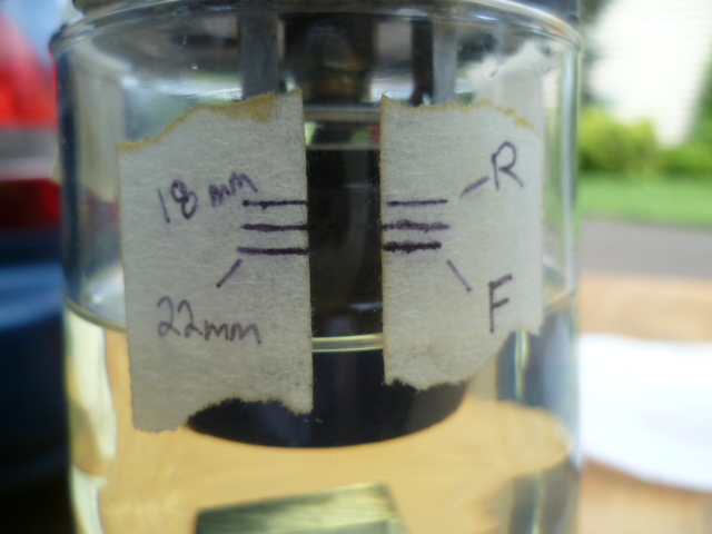

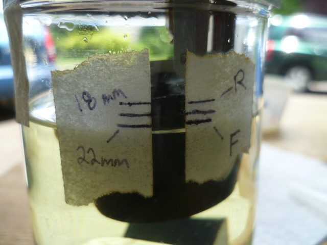

So I tried my ballasted floats today. Short story? They work great.
I filed the high spots off the spackle. Not that I really needed to, but OCD does things like that:
Then I set to trying them out... After a couple very simple, completely predictable tab bends, here's what I got. I set the level just a tiny bit low because 1) it will come up a little bit when there is a fuel pump pushing fuel, and 2) it will come up the width of the bowl gasket. Front looks like this:
And here's the front tilt:
And here's the rear after one completely predictable tang bend adjustment. Again, a little bit low on purpose:
Here's the rear tilt:
Based on the tilts, it looks like I could actually cut down on the weight a tiny bit. I'll make notes for if I ever have to do this again.

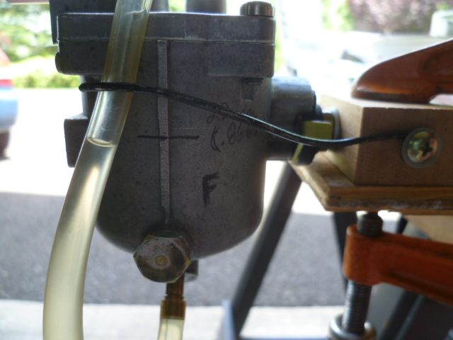

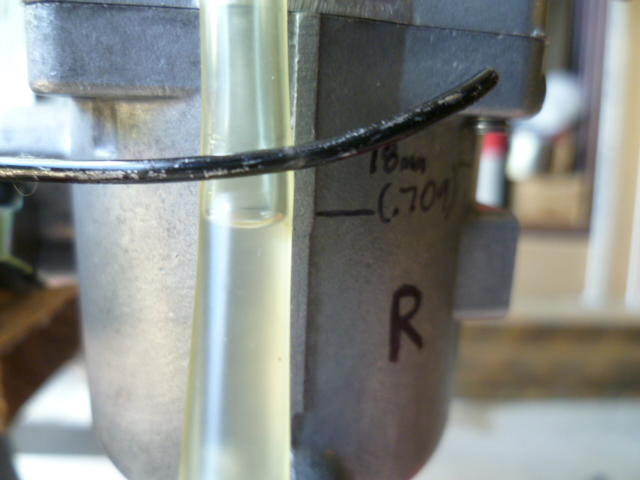

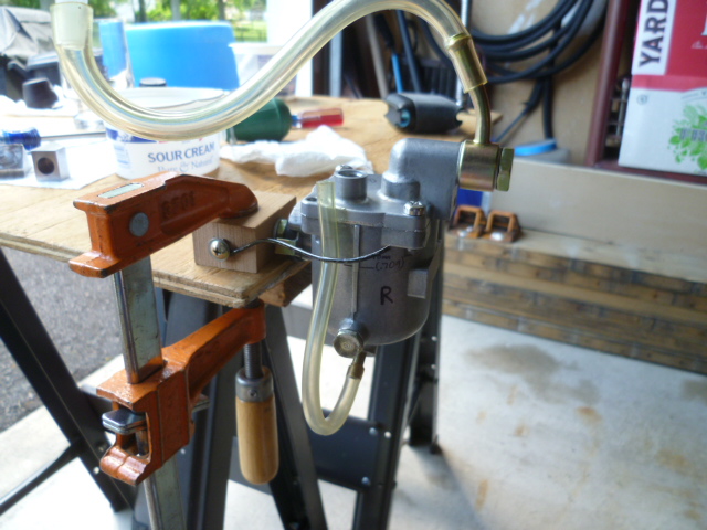

And just to make sure that my "in a glass" test method was valid, I tested again using the more traditional method with a piece of clear tube off the fuel nipple at the bottom of the bowls.
Here's my rig:
Here's the result for the rear bowl::
I did have a WTF moment with the front bowl... I put the fuel in, and it overflowed. I discovered that the float was stuck against the bottom of the bowl casting. Yet another fantastic feature of the long ear 72 design. So I emptied it and refilled while tapping on the bowl with a plastic screwdriver handle. That dislodged the float, and here's the result:
Will be interested to see how they work in running car, though should be great.  I will use my Float Sync tool to see how level adjusts in running car.
Good job!!
