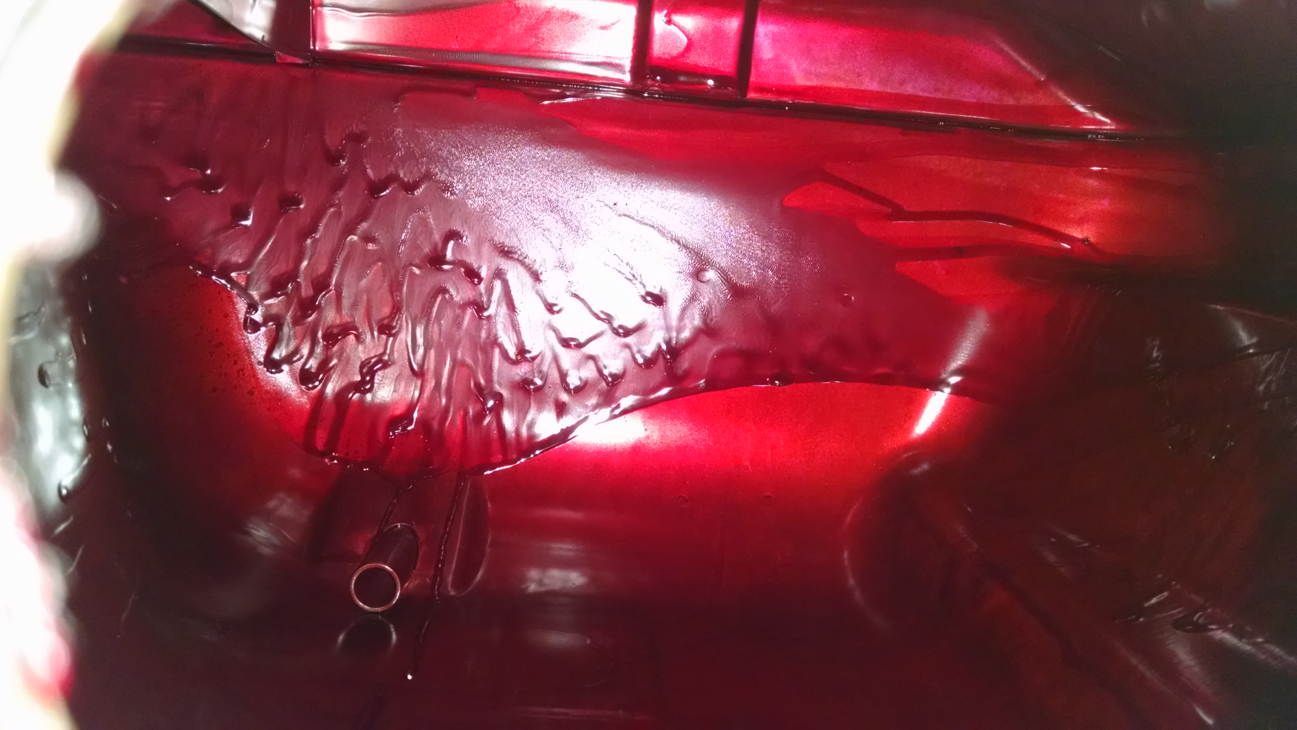

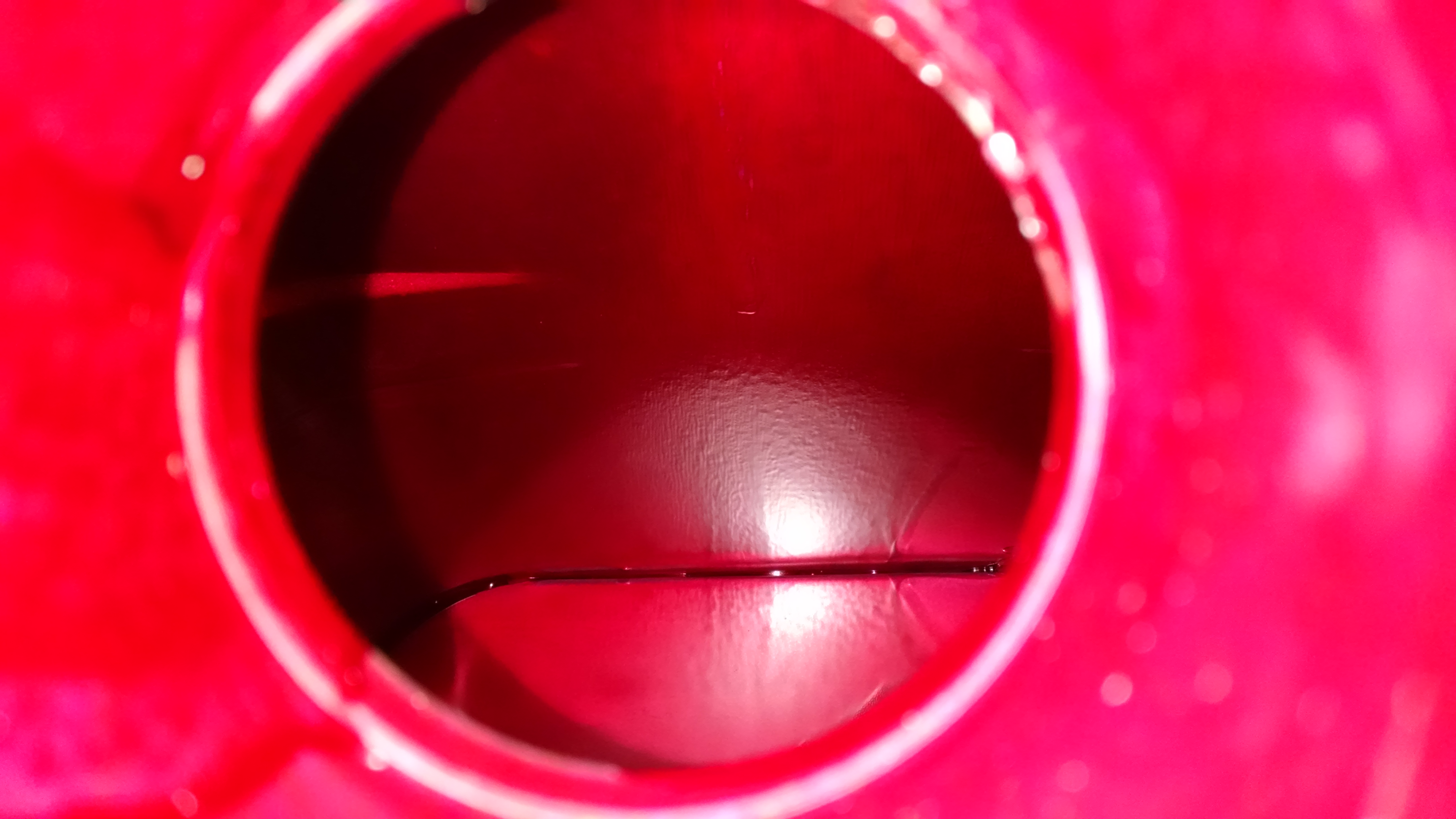

May 28, 20169 yr Author comment_495802 Well, fast forward a month. Cleaned out the tank today with muriatic acid and some chain. Worked very well, and the bottom of the tank was perfectly clean metal. Â The side walls and roof were free of any rust, but had a bit of discoloring still on them. I think if the acid would have been able to sit on those surfaces it might have been able to clean it off. Â I don't think it will be an issue. Â I had degreased it prior to the acid sloshing. IÂ degreased it after, 2 times in fact. Once with very hot water. Â Then did my acetone rinses, and proceeded to the coating stage. Things were going great... until they weren't. Â Of course I went to pour in the red kote, and my initial dump missed the mark and got on the side of the tank. I corrected the pour and got it all in there. Before I flipped the tank over, I tried to wipe down the fuel sender port opening that I spilled on. Â Of course a small chunk (maybe 1" square) of paper towel flaked off, and managed to fall into the tank. Â So now i'm trying to quickly fish this thing out, but I have nothing to reach it and grab it. I try a few things, but ultimately give up and leave it. Â Then i have to quickly seal up the port and start to roll this stuff around. I get a good coating all over the tank, but its definitely a good bit thicker where it sat for those few minutes. It was on the sidewall of the tank so there are definitely not puddles trapped below the liquid, but its a thick coat and thickish runs. Â Much thicker than everywhere else around it. I drained the tank very well and I am confident there aren't puddles lying in there. I also looked around to see where the paper towel ended up, but no luck. So the question is, if I let this thing dry for an extended period of time (probably ~1 month) do you think the heavy coating and runs on the one side will be a problem? Â I might be able to do another thin coat with what is left, and could certainly cover that area with a thin top coat if need be. Â Â Â The rest of it looks great. Edited May 28, 20169 yr by DaveR Link to comment https://www.classiczcars.com/forums/topic/55181-view-inside-fuel-tank-previous-coating/?&page=3#findComment-495802 Share on other sites More sharing options...
May 28, 20169 yr comment_495803 I would think if you let it cure for a while it will be fine. I would like to know the paper towel bit was encapsulated... Link to comment https://www.classiczcars.com/forums/topic/55181-view-inside-fuel-tank-previous-coating/?&page=3#findComment-495803 Share on other sites More sharing options...
