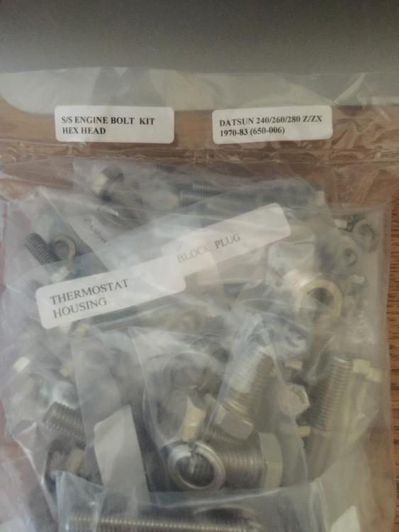

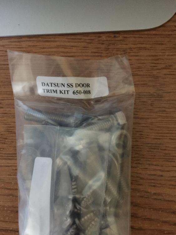

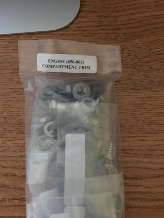

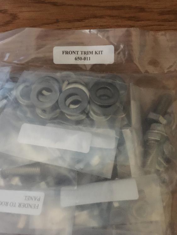

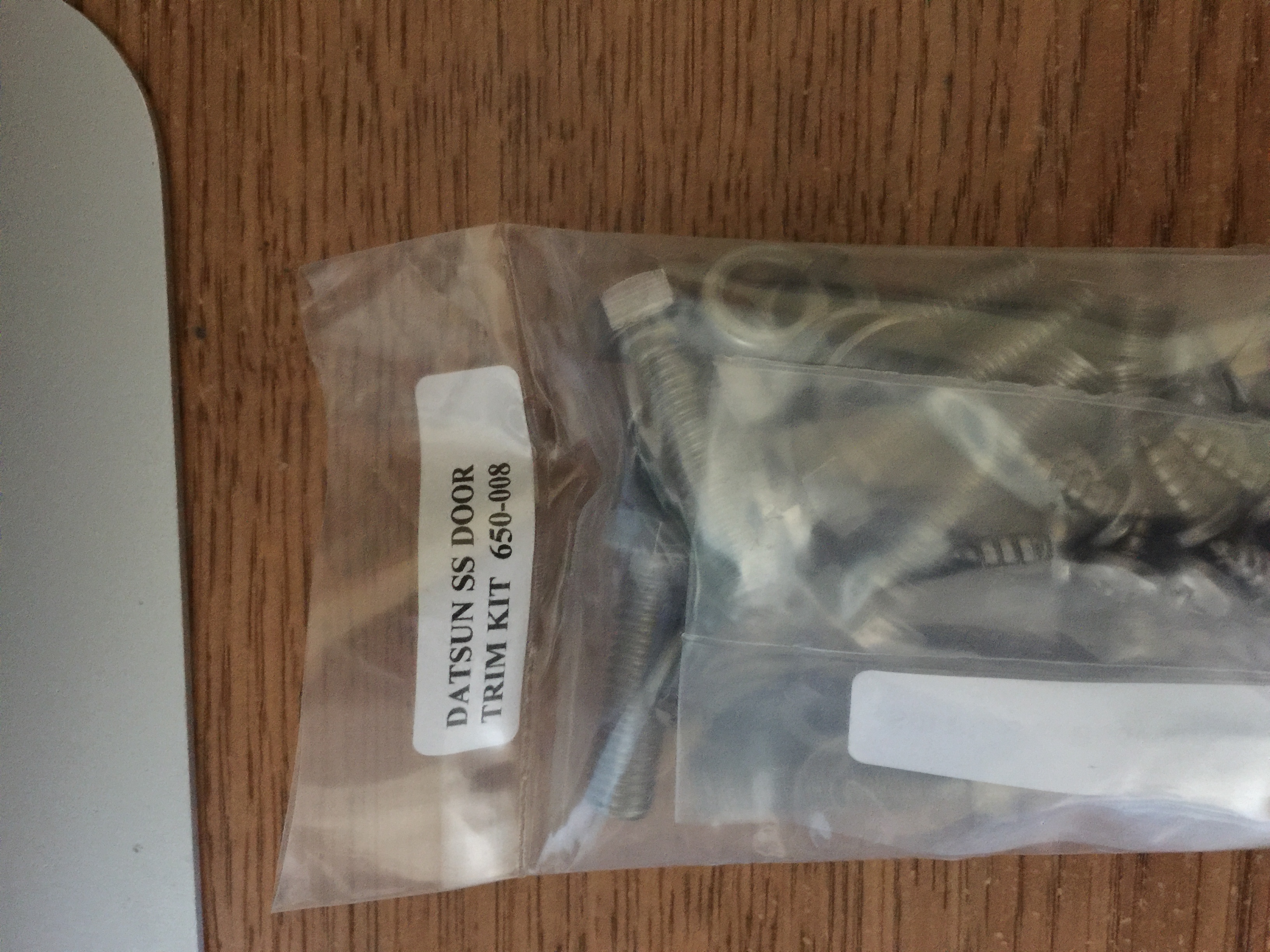

@rossiz I am with you.  I had already bought the SS Kit from Z Car Source and it has all the bolts and stuff for the bumpers.  I had not thought about using the polish wheel or painting the inside of the bumpers.  You have definitely given me some food for thought.  Thank you.
@motorman7 Rich, great info thank you.  I know these kits probably do not have every single nut and bolt that I need so I will definitely be looking at Marshall's Hardware.
This kit contains the SS Bolts for the Front Bumper.
This kit contains the SS Bolts for the Rear Bumper
Here are the other kits that I have:
